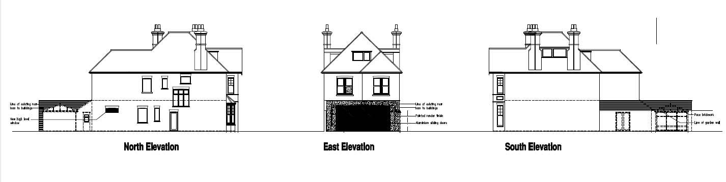

Triggaaar Posted November 10, 2018 Share Posted November 10, 2018 Hi all We've just applied for planning permission for a single story extension in Brighton, and if it passes (and we can get the money) I'd like to start with build as soon as the worst of the winter is over. That means trying to get quotes as soon as I can, which means trying to make decisions now. We were originally thinking of brick and block, but to improve the insulation we're now thinking of brick, then timber stud with insulation in-between, and further insulation inside it. Here are the proposed elevations: The plan is for the finished room to be 7.6m wide x 9.2m long, 2.8m high (internal). The East elevation will be mostly glass, so brick & block or brick & timber doesn't have so much affect. The South elevation will be a completely new wall (9.2m internal), and hopefully it will butt right up to the existing boundary brick wall (which is about 6'6" high). The north elevation wall is mostly already there - we'll need to build a little on top, or knock some of it down and rebuild, I don't know. Any suggestions on the pros and cons of brick & block (with Rockwool in-between) vs brick & timber stud would be much appreciated. Thanks Link to comment Share on other sites More sharing options...
PeterW Posted November 10, 2018 Share Posted November 10, 2018 For the sake of differential movement I would go with brick and block everywhere. Footings will be the same regardless and if you’re building on a boundary it will be quicker as the outer skin can go up at the same time as the inner blockwork. What concerns me is the roof span as there are no internal supports. That is going to need some serious work with either steels or very big timbers. You’re on the edge of the capability of a 373/146 posijoist at that span and potentially need to go to a 416/122 which are huge - and expensive ..! What has your architect / SE planned for the roof ..? 1 Link to comment Share on other sites More sharing options...
Triggaaar Posted November 10, 2018 Author Share Posted November 10, 2018 29 minutes ago, PeterW said: For the sake of differential movement I would go with brick and block everywhere. Footings will be the same regardless and if you’re building on a boundary it will be quicker as the outer skin can go up at the same time as the inner blockwork. Thanks. I mentioned to the architect that I want to exceed the building regs insulation requirements, so that the room stays warm with little heating, so he suggested timber studwork inside the bricks. How do you think we could improve the insulation if we go brick and block? 29 minutes ago, PeterW said: What concerns me is the roof span as there are no internal supports. That is going to need some serious work with either steels or very big timbers. You’re on the edge of the capability of a 373/146 posijoist at that span and potentially need to go to a 416/122 which are huge - and expensive ..! What has your architect / SE planned for the roof ..? Are posi-joists the zig-zag timber/metal beams? We were thinking of a large steel universal beam across the width of the kitchen, supporting the room above. Getting it in, almost by hand, will be a challenge. One option is to have it in 4 pieces - instead of one length of 8m (ish), a 5m & 3m piece joined together, running parallel with and attached to a similar pair, 3m & 5m, so the joins don't overlap. This is pure guesswork at this stage, as the architect won't know until he asks his engineer. Then a steel from that back towards the house, to support the side wall of the room above. If that can't be done, we'll have to have a supporting steel column part way along the length. Then we'd also need an 8m ish steel over the sliding glass doors. And possibly a third too (one issue I have is allowing for roller blinds fitting into the ceiling). Then we'd just have standard timber joists between the steels. The long posi-joists are something I've seen on tv, and plan to ask the architect about, in case we can use them (as well as some steel, which is unavoidable). Link to comment Share on other sites More sharing options...
PeterW Posted November 10, 2018 Share Posted November 10, 2018 1 hour ago, Triggaaar said: Are posi-joists the zig-zag timber/metal beams? We were thinking of a large steel universal beam across the width of the kitchen, supporting the room above. Getting it in, almost by hand, will be a challenge. One option is to have it in 4 pieces - instead of one length of 8m (ish), a 5m & 3m piece joined together, running parallel with and attached to a similar pair, 3m & 5m, so the joins don't overlap. Sorry I’m lost here ... Are you saying there is an opening at the end of the house so the extension will extend an existing room ..? So you want to support both back walls to create an opening ..? 8m steels to support the back of the house will probably need to be 356x127x39 so they will be 320kg each. Splicing those will need some serious work so you may need to go even deeper... You can just about span the 8m with just roof loads using a 254x146x43 and it may be better just spanning the whole build 3 times and then using timber between the flanges. It would be quicker and possibly cheaper. The SE really needs to get a good idea of what you need as if not, you could end up with some nasty drops in the ceiling where the steels go 1 Link to comment Share on other sites More sharing options...
Triggaaar Posted November 10, 2018 Author Share Posted November 10, 2018 Just now, PeterW said: Sorry I’m lost here ... Are you saying there is an opening at the end of the house so the extension will extend an existing room ..? So you want to support both back walls to create an opening ..? It's currently a typical Victorian/Edwardian house, where the kitchen extends into the garden, but not at the full house width, giving you a side return. We want to knock down the existing kitchen walls (rear wall, as side wall), and extend into the side return, and also further into the garden (there is currently a conservatory into the garden, but for the sake of understanding the plans, we can ignore that). Just now, PeterW said: 8m steels to support the back of the house will probably need to be 356x127x39 so they will be 320kg each. Splicing those will need some serious work so you may need to go even deeper... You can just about span the 8m with just roof loads using a 254x146x43 and it may be better just spanning the whole build 3 times and then using timber between the flanges. It would be quicker and possibly cheaper. Quicker and cheaper sounds great to me So you mean steels with a cross section of 254x146x43, and putting timber joists between them? That would be fine at the back of the extension, but we'd still need something big to support the existing first floor and roof (a 320kg steel sounds reasonable, I was concerned it would be more). Just now, PeterW said: The SE really needs to get a good idea of what you need as if not, you could end up with some nasty drops in the ceiling where the steels go I'm hoping we'll be ok with flat ceilings. The existing kitchen ceiling is around 3.15 / 3.2m high, and we're after a finished ceiling of 2.76m, so there should be room for the steel. Thank you for the help 1 Link to comment Share on other sites More sharing options...
Triggaaar Posted November 13, 2018 Author Share Posted November 13, 2018 I met the architect again today, and mentioned the concern of different expansion rates if we go timber on the inside, with brick/block on the outside, and he said it wasn't a problem, and was common these days. If we do go that route, my main concern it being able to build a brick/block wall up to an existing brick boundary wall, and at the same time building a timber wall on the inside, and joining the two with wall ties: There would only be a 50mm cavity between the bricks and the Tyvek/ply/studs, which means we'd need to build the stud wall first, then put 600mm strips of ply in place (with rolls of Tyvek in the way), then reach over to lay the bricks and add ties, before doing the next strip of ply. Meaning just 6" space between the ply and the existing brick boundary wall, to get fixings in (from ply to timber stud). I wondered if instead we could build the brick block wall up to 7 feet (matching the boundary wall), and then build the timber studs with ply and Tyvek, flat on the ground, then stand it up and then add wall ties, drilling them in to the finished brick/block wall? I don't know if that's an acceptable method or not. Perhaps it would be good if the outer skin were concrete blocks, meaning we'd likely get a good fixing? Any ideas? Thanks Link to comment Share on other sites More sharing options...
