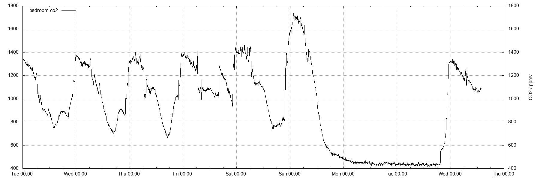

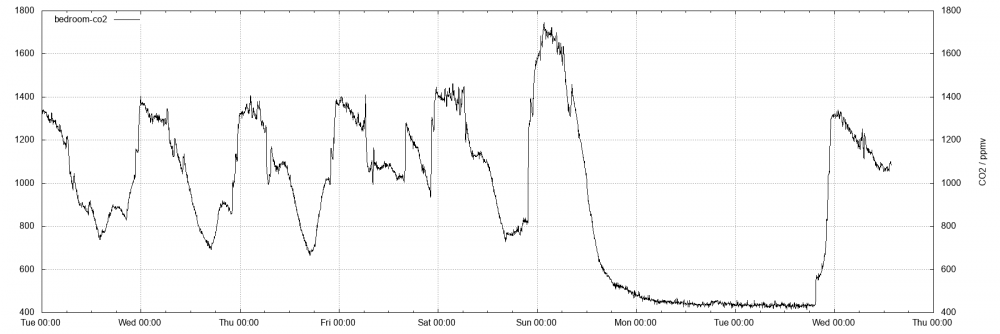

Here's the bedroom CO₂ level for last week or so. I was away Sunday and Monday and Tuesday so that gives a nice baseline. Note the non-zero base to the Y-axis. A little “research” project I've been meaning to get round to is comparing the overnight CO₂ levels (at, say, 04:00) with the winds at Wick airport (which I'm also logging) to get some idea of how much difference that makes to the ventilation. Note, this is all in my rented house, not the one I'm building which is still even more ventilated.
Edited by Ed Davies
Correct days I was away (Sunday night starts just before “Mon 00:00” - doh!)

A few years ago I built a small CO2, temperature and RH logger (some here have borrowed it) and was a bit surprised at how high the bedroom CO2 level got in the middle of the night at our old house, even with a small window that's always left open.  Interesting to correlate events like the bedroom door opening with a sudden decrease in CO2 concentration; demonstrates well how important cross flow ventilation is in a room (our bedroom door in the old house was almost diagonally opposite the small open window).
The concentration levels were similar to those above, and enough to make me feel a bit muggy headed in the morning.  Leaving the bedroom door ajar made a significant difference, and lowered the peak concentration down to around 800ppm.
The new house has CO2 monitoring and logging built-in, with a display in the hall where things like outside temperature, inside CO2 concentration, RH, plus GPS derived date and time, are displayed.  The highest concentration I've seen is under 700ppm, and it only gets that high when there are several people in the house.  The bedroom CO2 concentration rarely gets over 500ppm, so is a massive improvement on the old house.
I'm convinced that the significant lowering of CO2 level in a house with MVHR contributes a great deal to the "fresh air feeling" that visitors often notice.  Damon HD borrowed my portable monitor and did some experiments with the environment in a primary school classroom a couple of years ago, and IIRC he mentioned that there was a pretty good correlation between attentiveness (or the lack of it) with CO2 concentrations of over around 800ppm.  I can't remember whether the thread on that is here or lost when Ebuild went down, but it was an interesting read.
I don't leave the bedroom window open but usually leave the door ajar. Maybe the higher levels of CO₂ Sun/Mon night were due to not doing that, I don't remember. I'm really hoping that MHRV in the new house will give better CO₂ levels without needing the heat loss of an open window or door.
Just found one of the 24 hour plots from when I had the logger located in the bedroom of the old house.  I managed to correlate some of the dips with known events, that illustrate how cross ventilation from the bedroom door being opened affected the CO2 concentration.  The data seems pretty close to yours:
