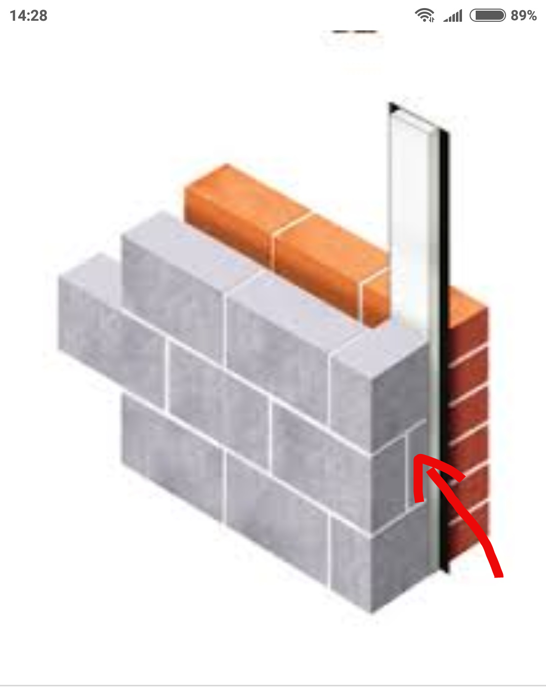

Adamantium Posted October 18, 2018 Share Posted October 18, 2018 Hi all, Hopefully just a quick one here, but don't want to ask the officials yet. I have blockwork walls with a 150mm cavity. I am having sash windows fitted from the inside that butt up against the outer leaf whose opening is obviously slightly smaller. My windows are 126mm in profile so obviously the cavity extends beyond their depth. I believe 150mm cavity closers may be an option, but the architects have designed in a returning block that closes the cavity immediately adjacent the window down to 50mm. The architects are from NI, the builders on the mainland are concerned that this won't meet building regs requirement. I don't know if buildings regs are different in NI. Just want to know if anyone has seen a reduced cavity thickness around the windows for this purposes before? thanks in advance. Adam Link to comment Share on other sites More sharing options...

Declan52 Posted October 18, 2018 Share Posted October 18, 2018 That's just how it's done in NI. You put a length of dpc up the reveal on the inside of the outer skin. Then you will have a strip of pir insulation cut at a min depth of 50mm,75mm will be easier to work with. Then the block work is returned. You will need split brick or a block cut with a saw to 50mm if you go for 100mm insulation to fill the gap. The red arrow will be the split brick. With 75mm insulation you can just use a normal concrete brick. The cavity in the pic is 100mm. Link to comment Share on other sites More sharing options...

Adamantium Posted October 25, 2018 Author Share Posted October 25, 2018 Builders decided to stick with architects plans and use NI design with a return. Cavity seems to have been dropped from 150 to 50 (might be 100 - I can’t tell). I’m happier with this as it gives the windows direct purchase on the block. Building control have confirmed they are happy. Link to comment Share on other sites More sharing options...
