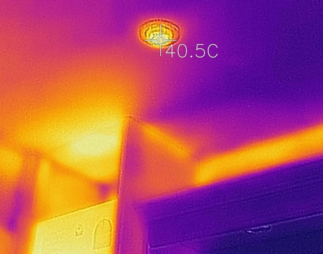

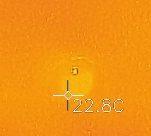

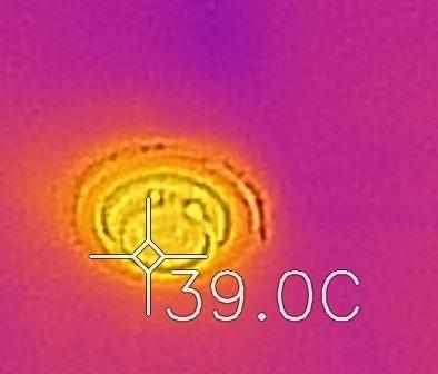

I was checking out my boiler with my FLIR and spotted the adjacent 5W LED downlight was rather warm. Then I checked the other 7 and they were too. They were turned off as it was daytime so what's generating the heat and is this normal? I changed them from halogen last year - MR16 to GU10 and they are two switched banks of 4 x 5W. Thoughts?

Pop one out from the ceiling and look again with the flir at the empty hole.  I suspect something (hot pipes passing through?) is making the ceiling - floor void very warm and it is that warmth coming out that you are seeing.

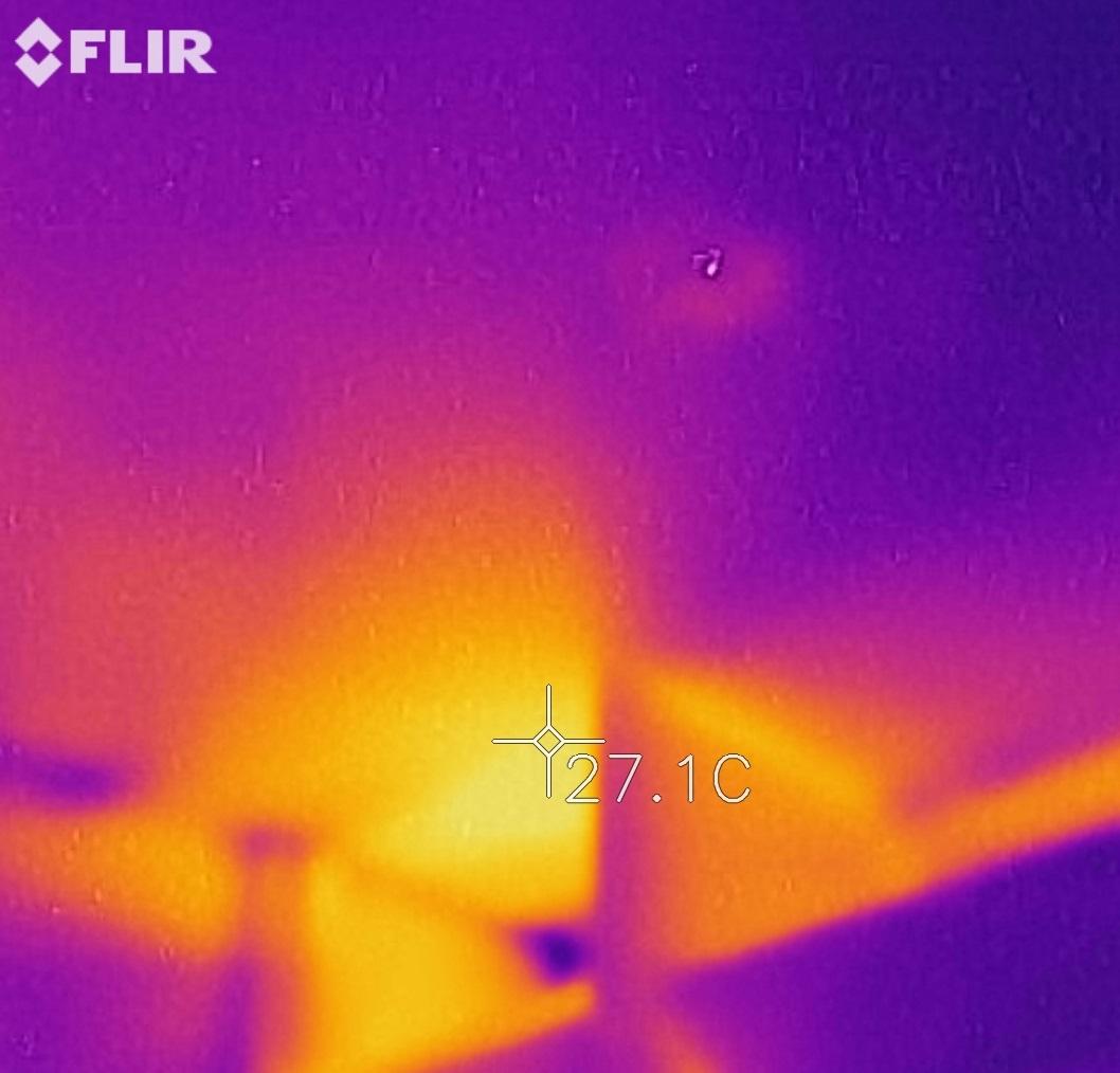

You're spot on.....heating has been off for over an hour and no hot spots. Must be heating pipes as you say....had me worried!
