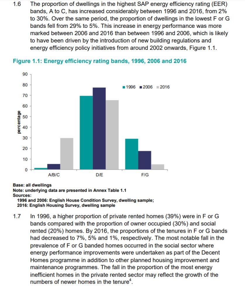

In terms of reducing Greenhouse Gas emissions rapidly, I think a focus on newish builds - whilst regs and EPCs are certainly a thing that needs fixing - is a bit of a red herring. It is the 10% not the 90% in carbon emissions terms,
All the houses built in the last decade comprise only approximately 5% of the housing stock. Going back to 2000 only comprises a little over 10%. And those are the most efficient portion.
According to *this* 2010 (ish) report "F & G banded homes in Great Britain - Research into costs of treatment" done for the Energy Saving Trust, there was 19% of our housing stock in bands F&G. That is now down to less than 5%, all of which is either in the social rented or owner occupied or an exception or being rented illegally if in the PRS.

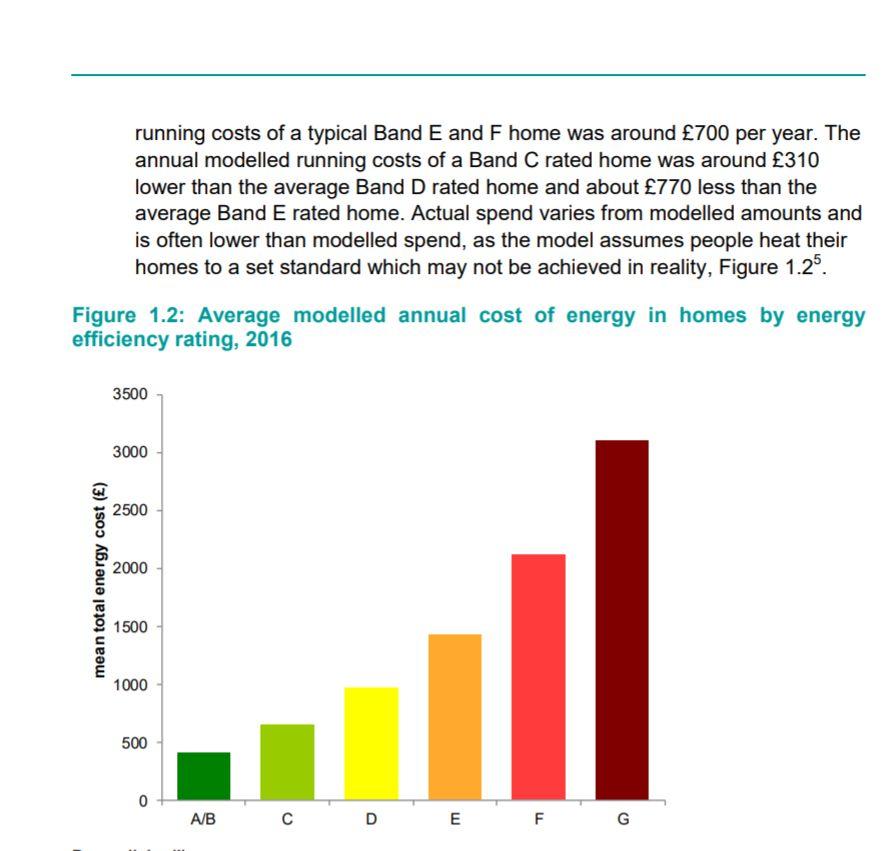

Looking at these numbers from the English Housing Survey 2017, I think I would argue for an initial +2% on Stamp Duty for Fs and Gs, and a +1% on Ds and Es, to keep the improvements happening - perhaps hypothecated to energy improvements on Hard-to-Improve properties.
F
20181010-energy-costs-by-epc-band-ehs2017.thumb.jpg.25fa22f00351b287ed49c860e202280b.jpg
20181010-energy-improvements-by-epc-band-ehs2017.thumb.jpg.5e3954c74c281a4707d1d4165e41f49c.jpg
