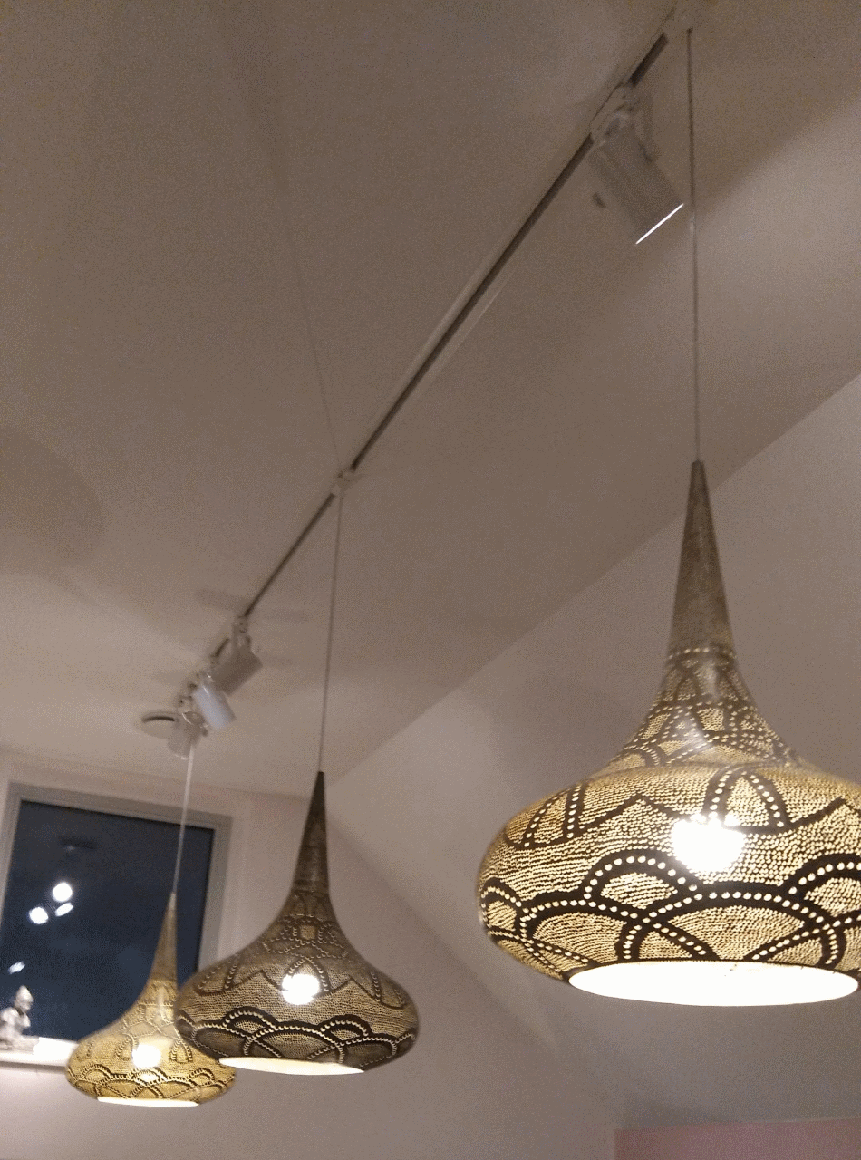

We used this in bedrooms as well as lounge and dining areas: https://intalite.co.uk/slv-145211-eutrac-3-circuit-recessed-track-2m.html
Recessed into the ceiling and 3-circuit. As part of a complete lighting scheme based on multiple "layers" of light, they work really well, give flexibility but do cost quite a bit. If recessed properly there is a small lip over the ceiling, quite subtle. The tracks are very strong and you can screw them to the ceiling battens or joists at regular intervals so they are able to carry quite a large weight e.g. for your crystal chandeliers !
In our case we used the track to provide 2 circuits, each controlled by it's own dimmer at 230v mains voltage.
  • Circuit 1 for pendants (general lighting). SLV have a clip-in adaptor and it is simple to wire your own pendant to it. The adaptor is universal and you can set it to either circuit 1, 2 or 3 on the track.
  • Circuit 2 is for spots which I have positioned to accentuate and highlight e.g. wall hangings or work areas.
  • Separate to this, we have 5A sockets in walls into which we plug stand-alone floor or table lamps, also controlled by a single dimmer
Full control from one point, no fancy computer controlled lighting and quite effective. I understand the tracks and clip-on are semi-universal, but did not need to deviate from one brand.
I fitted this a while back as it was the best value we could find - the big issue with any of the 3 channel stuff is depth. We ended up having the ceiling overboarded to get the depth and that probably cost more than the track did ...! Its 33mm deep and that means either you have to counter batten your ceilings or plan to just run it between the joists and fit noggins.
On another job the spark did he fitted timber battens to the correct width and depth and then got the plasterer to skim up/over them and pulled them out afterwards and slotted the tracks in.
As many will tell you - track isn't the cost, its the lights that will be the pricey bit !!
