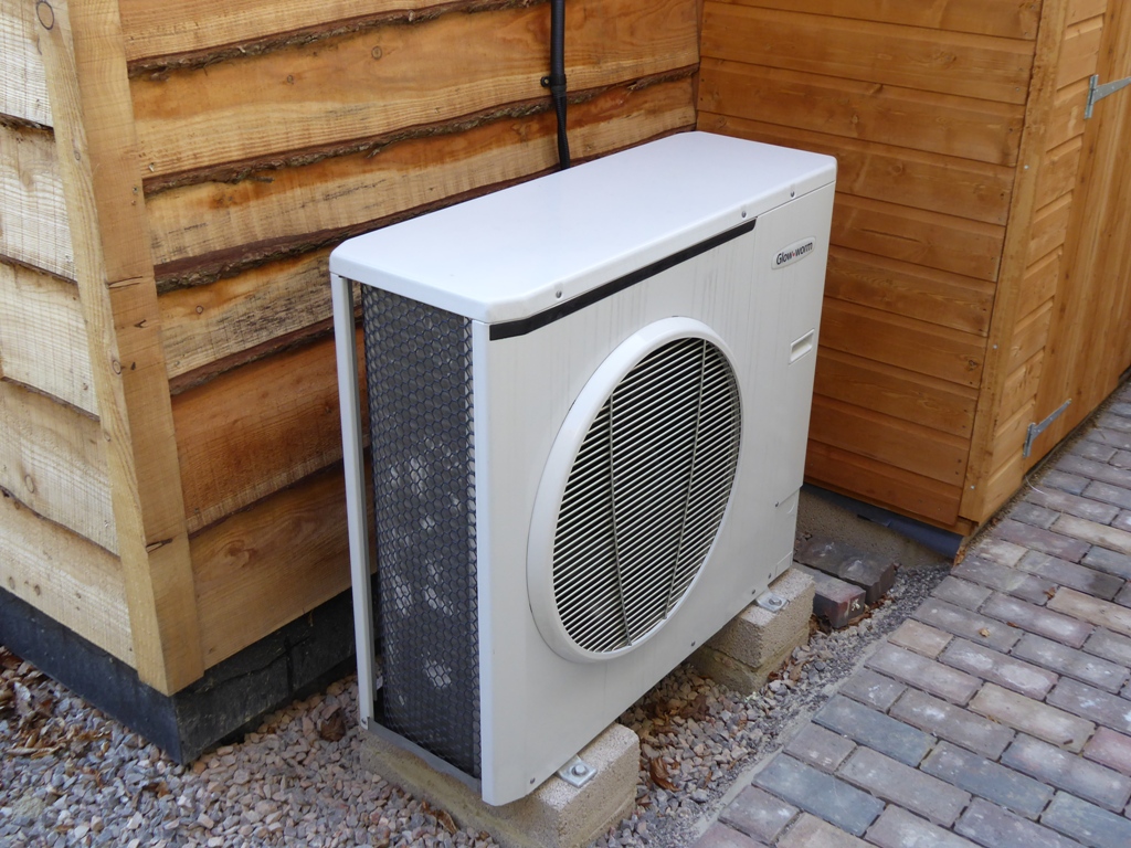

Stones Posted May 22, 2016 Share Posted May 22, 2016 I'm looking at an A2W ASHP for my new house. At present the intended location of the ASHP is a 2 metre wide path that runs between the gable end of the house and the garage. The path is a 'through' corridor. Looking at manufacturer (Panasonic) instructions suggests a rear minimum clearance of 100mm and a front minimum clearance of 1000mm. The ASHP itself is 300mm wide, so I do have enough room to position the ASHP, meet the rear and exceed the minimum front clearance distances. The question I have been pondering is whether I will in effect be creating a 'cold corridor' (between the gable end of the house and the garage) which will drive down the CoP of the ASHP or otherwise negatively affect the operation of the ASHP.Any thoughts? Link to comment Share on other sites More sharing options...
Jeremy Harris Posted May 22, 2016 Share Posted May 22, 2016 Our ASHP is in the corridor along the North face of our house, situated on the corner. Behind it is the big retaining wall, around 3m high and around 1.2m or so from the face of the ASHP . In practice it seems to work fine in this location, but rarely needs to run at anything like full output, so that probably helps. This is what it looks like, with the water treatment plant shed next to it, poking out the back of the house: Link to comment Share on other sites More sharing options...

Jeremy Harris Posted May 25, 2016 Share Posted May 25, 2016 Although the manual for ours says 200mm minimum rear clearance, you would really struggle to fit it with that small a gap, as the flexi pipes won't really bend around that sort of radius (and, as I found, you need to have a loop to stop vibration transfer). 300mm seems a sensible minimum, and is probably around the distance between the rear of ours and the wall. Link to comment Share on other sites More sharing options...
