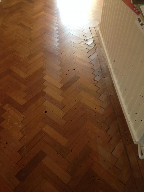

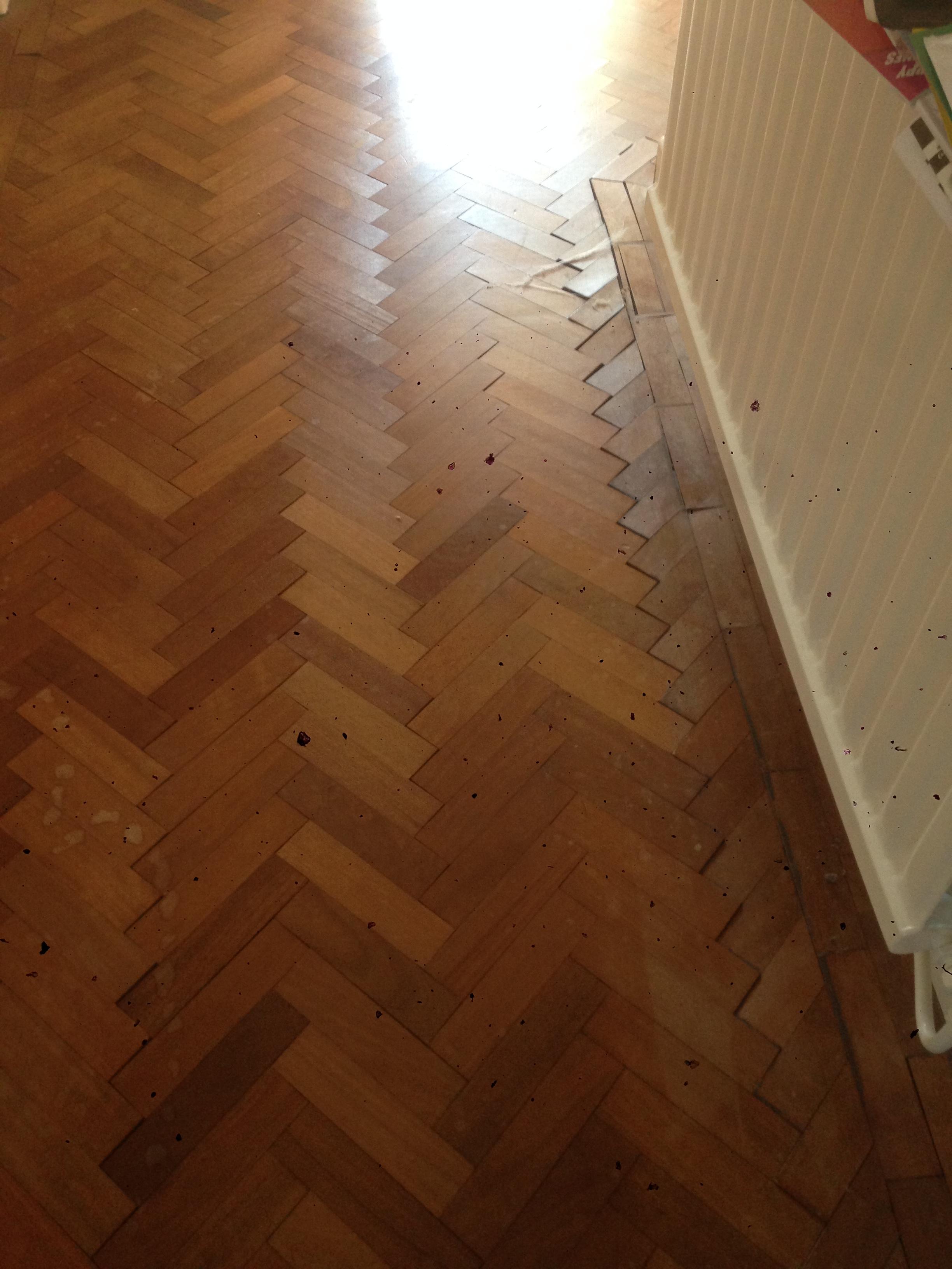

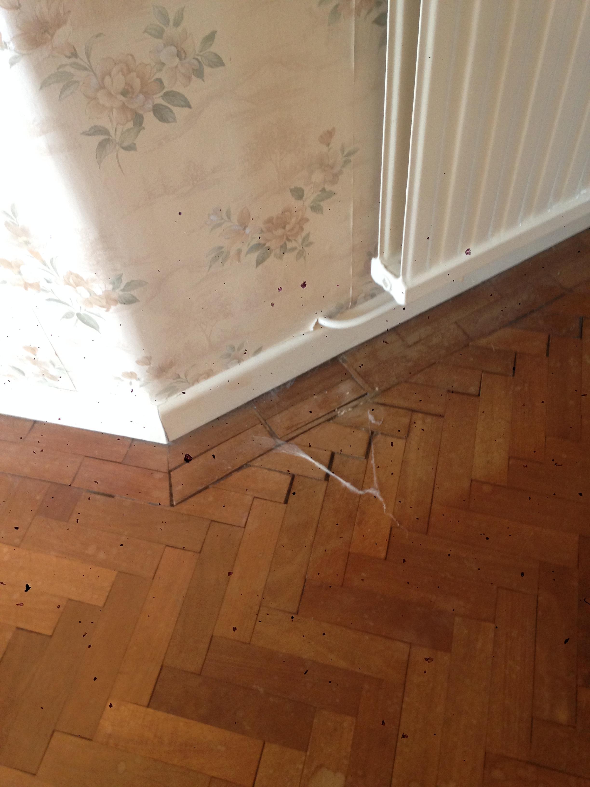

Oz07 Posted July 2, 2018 Share Posted July 2, 2018 Anyone like to have a guess why the below parquet floor was damaged. I thought possibly water damage with the associated radiator pipework being close by. Am I missing anything or does this sound likely? Link to comment Share on other sites More sharing options...
Russell griffiths Posted July 2, 2018 Share Posted July 2, 2018 I’m going to go out on a limb and say subsidence looks like solid floor has dropped causing a crack in that location. .???????????? Link to comment Share on other sites More sharing options...
Oz07 Posted July 2, 2018 Author Share Posted July 2, 2018 pocket cut out in border and heating pipe drop in that location also makes me think leak and dried out. No obvious cracks in walls to suggest subsidense. Link to comment Share on other sites More sharing options...
Russell griffiths Posted July 2, 2018 Share Posted July 2, 2018 Have you lifted any to see how they are stuck down the original ones will probably be stuck down with a type of bitumen see what the moved ones are down with. Link to comment Share on other sites More sharing options...
Oz07 Posted July 2, 2018 Author Share Posted July 2, 2018 Not yet no. Will it help as in because you will see any subfloor crack? Link to comment Share on other sites More sharing options...
