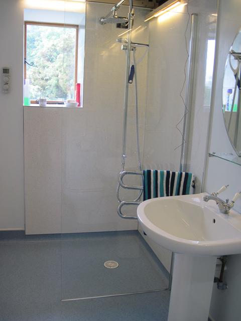

Jeremy Harris Posted July 1, 2018 Share Posted July 1, 2018 There are some photos of the bathrooms in our new house here if they help: http://www.mayfly.eu/2014/09/part-thirty-three-system-details-and-the-bathrooms/ 1 Link to comment Share on other sites More sharing options...
Jude1234 Posted July 1, 2018 Author Share Posted July 1, 2018 7 minutes ago, JSHarris said: There are some photos of the bathrooms in our new house here if they help: http://www.mayfly.eu/2014/09/part-thirty-three-system-details-and-the-bathrooms/ Thanks for the pictures, the panels look good, Can you remember which ones they were, It looks like the second picture were travertine Link to comment Share on other sites More sharing options...

Jeremy Harris Posted July 1, 2018 Share Posted July 1, 2018 22 minutes ago, Jude1234 said: Thanks for the pictures, the panels look good, Can you remember which ones they were, It looks like the second picture were travertine The panels in the shower room are new sandstone, slightly textured, finish ones, the other bathroom is done with left over travertine style gloss panel offcuts that I'd saved from when I refurbished the bathroom in our old house, so were around 6 or 7 years old when I installed them. I've just checked, and the panels in the old house were installed in 2010, so are 8 years old, and they still looks as good now as they did when I fitted them. 1 Link to comment Share on other sites More sharing options...
