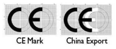

Just look at the deliberate similarities between the“Conformité Européenne” 'CE mark' and 'China Export'.
