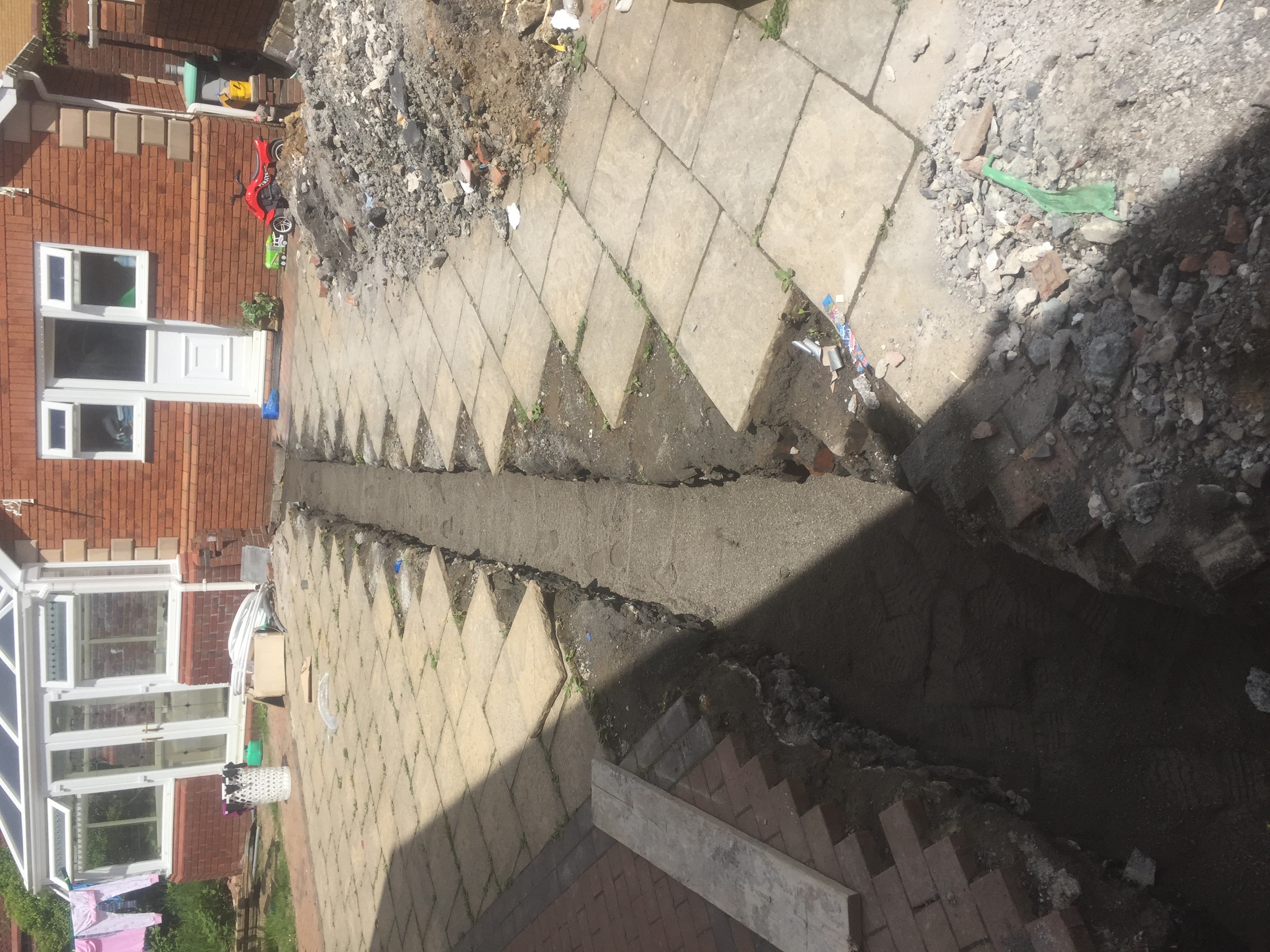

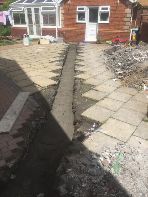

Nickfromwales Posted June 29, 2016 Posted June 29, 2016 The next gadget won't run on 1mm2 stranded flex . Re the manifolds, you'll not need the additional circulation pump imo. Mom a previous job I trenched between the house and the garage ( much like the pic above of my current job ) and put a TS in the garage aka plant room. From there I ran a 15mm flow from the TS, around the garage, down into the trench, back up into the utility room, up the wall to the first floor joist space, along to the airing cupboard ( or "hot press" if your foreign ) and up to an Ufh manifold for the ( ground floor ) sunroom single zone / single circuit Ufh. The return was tee'd into the 28mm grouped return for the house radiators and job done. Thinking that the manifold pump would pull the heated water up there was my assumption. To my surprise, the manifold was warm, PRIOR to me fitting controls and energising the pump. The pipe work was all roasting hot and I was bemused as to how, only to then realise that there was a perfect convection loop flowing round like it was pumped! I had to install a 2port valve to STOP the flow for when the Ufh wasn't needed . That 15mm pipe run was over 18 maybe 20m long and up n down like a yo-yo. Point being, you'll be fine.
