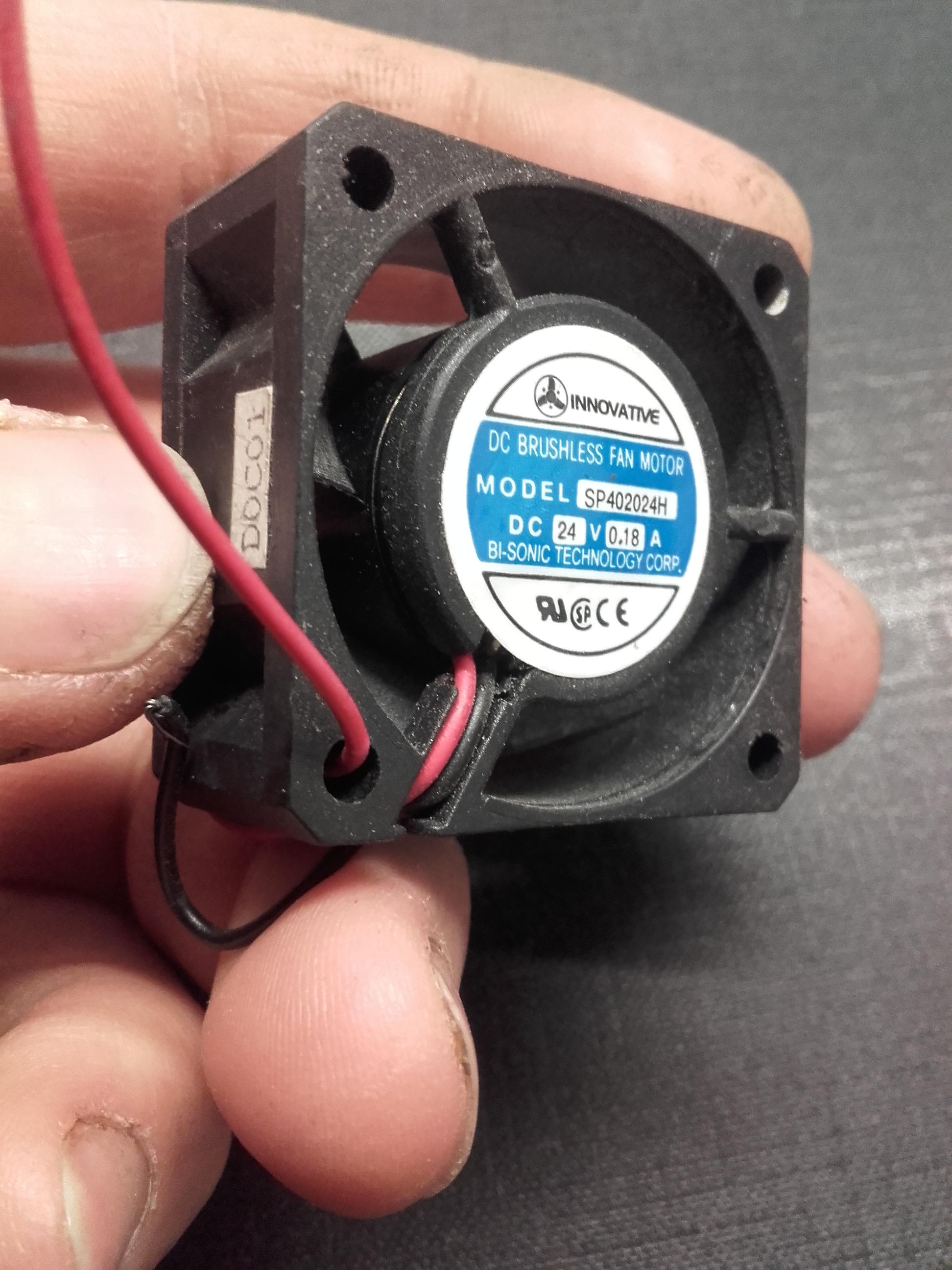

In terms of a fan unit I've found this in the stash of "that'll come in handy one day" parts and a suitable 24vdc power supply is no problem. It'll probably be triggered by some short range proximity sensor + timer when you sit on / stand next to the loo.
20180425_061834
20180425_061842
Spec for the fan is:
DC Fans Tubeaxial, 60x25mm 24VDC, 27.1CFM, Ball
I'm thinking to either fit this in an adaptable box or square section ducting.
Is the 27.1CFM adequate for the application do we think?
Cheers

Way over the top 10-15% of that would be fine.

It’s a bit much tbh and you may “feel it” and definitely hear it as that looks like a server fan ..!
It was out of a dead variable speed drive from memory. I'm sure I have some around half this size...
27.1 CFM = 46m3/h = 12.7 l/s,  more than twice the required WC extract rate for Building Regs!!
 In my design I planned on just over 6l/s for the WC room plus just under 6l/s split between two cisterns.  I ended up with 3 - 3.5 l/s per pair of cisterns and that is fine, no complaints of lingering smells. This gives 11.8 - 13.7% of your potential flow, however you will need to take in account pressure losses!

@le-cerveau,  how about 7.77 CFM?
That is probably a more realistic value, The losses are more likely to be restrictions due to pipework etc.
