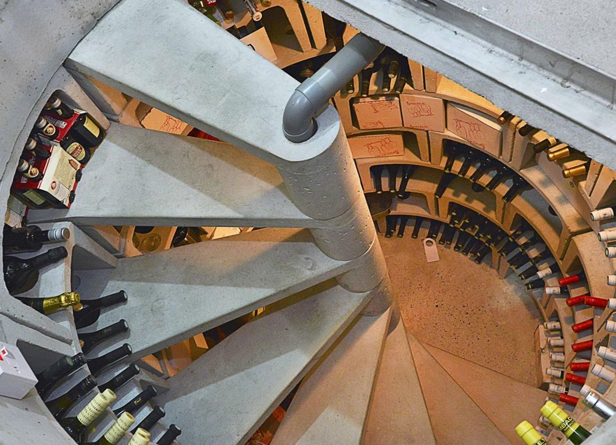

PeterW Posted March 3, 2018 Share Posted March 3, 2018 1 hour ago, Hecateh said: briefly discussed a poor man's version of this with my builder as I have a 1m (ish) void below my utility - Decided the way I went through red wine it wasn't worth it LOL We have converted the old inspection pit in the garage to a cellar - this was part of the original garage and when we took the old slab up we cast a new lid on it and insulated over the top. Edge must be near 280mm thick of concrete and underground is a steady 9c permanently.... just need to sort the door, the steps, the floor, the rack ....... 2 Link to comment Share on other sites More sharing options...
Ferdinand Posted March 3, 2018 Share Posted March 3, 2018 (edited) I quite like this one, with the precast concrete. I am not sure what the plastic pipe is for however, and whether they are good wines. Edited March 3, 2018 by Ferdinand Link to comment Share on other sites More sharing options...
PeterW Posted March 3, 2018 Share Posted March 3, 2018 22 minutes ago, Ferdinand said: am not sure what the plastic pipe is for Stack ventilation Essentially it’s to the bottom of the cellar and goes out higher up in the property to allow the cellar to naturally ventilate. 1 Link to comment Share on other sites More sharing options...
