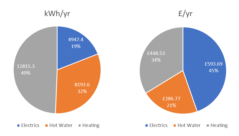

Visti Posted February 8, 2018 Posted February 8, 2018 I'm wondering if anyone has any excel model on sizing PVs? Particularly one that includes the annual cycle from month to month? I'm certain of the main variables that need to be considered (solar fall at geographical location, orientation to south, pitch, m2 of panels etc...) yet there's nothing via google that doesn't mean starting from first principles! Asking as we're looking to supply adequate power to our energy demands (below) and exploring non-conventional options like Sunamp! (£/yr is for a conventional gas boiler+cylinder which we're using as a baseline).

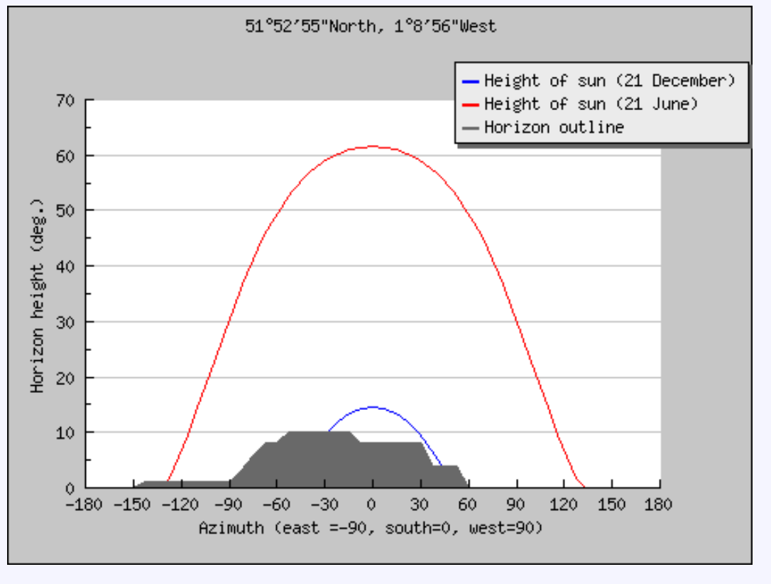

Visti Posted February 8, 2018 Author Posted February 8, 2018 Hot dang, that was quick and spot on! Never fail to disappoint @JSHarris That is a very useful source... it even gives a horizon outline:
