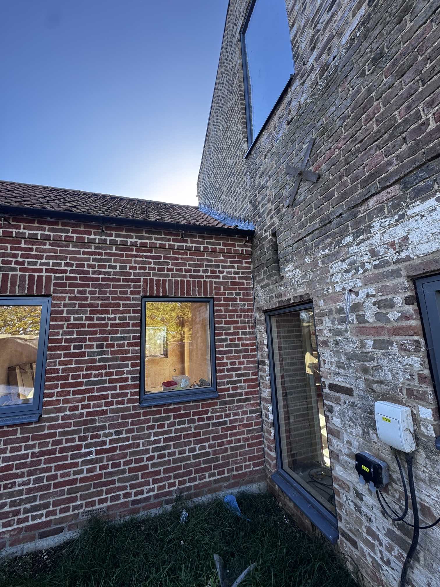

Great_scot_selfbuild Posted 5 hours ago Posted 5 hours ago What is the maximum length of lead flashing in a single length I should use? I have some long windows and have read about allowing for expansion/contraction of lead, but want to hear from experience in this group as to what you would do? window lengths: 1900mm 2500mm 4700mm TIA

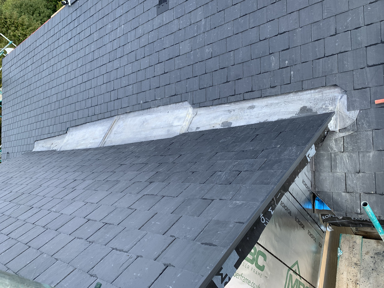

Roger440 Posted 5 hours ago Posted 5 hours ago 1 to 1.2m seems to be the rule of thumb for valleys. My valley had been done in a 3.5 m single length. It had crinkled up and split on the south west elevation
