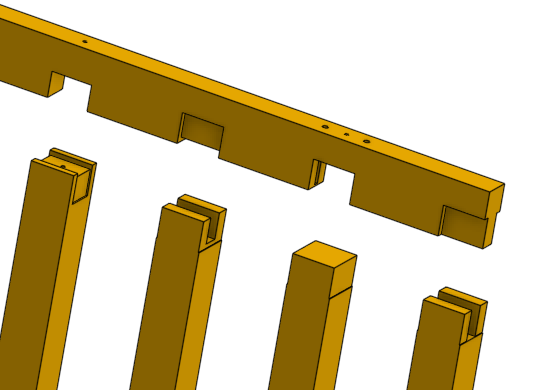

I'm making a simple porch frame to go between two walls and I am pondering between a bridle cut and a simpler to make bolt held option (M12 x 250 Stainless). The two options are at the bottom of this post (but at the top of the porch post :-). Vertical posts are 145x145 and horizontal beam is 95x195. Although it's more effort, I am currently leaning towards the bridle cut. It would prevent any light passing though a narrow gap that could open up through shrinkage. It's much more work to make though and the finished result will look identical bar any gaps. Silly?
Edited by MortarThePoint
I could drill and peg at the join to fill the gap, but I'd have to be very careful not to blow through with the drill and there would still be a small unplugged gap left

A concern with the bridle cut that isn't an issue with the modern fixing approach is he possibility of the post splitting due to it shrinking more than the beam
Ah, you're making the entire frame, not trying to put vertical pieces into something that is already there. I misunderstood. In that case, definitely the bridle cut if your woodworking skills are up to it.

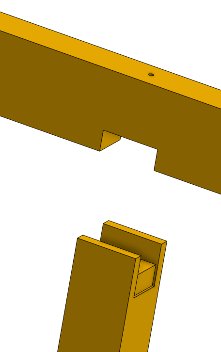

Well, like Baldric I have come up with a cunning plan. It's on the far left of the options below and involves cutting an undersized notch in the beam, which gets relieved on the post using a router. It also allows a shallower notch in the beam if I cut a slot the top of the post. That slot also serves to constrain the joint laterally. It's kind of a hybrid of traditional and modern.
100mm joint with a 85mm Circular Saw depth:
100mm joint with a 50mm Circular Saw depth:
Now that's neat. Remember we want photos.
Instinct tells me this is maybe a bit complicated (?) One factor will be the quality of the wood; definitely a case of going to the BM and choosing the wood yourself.
