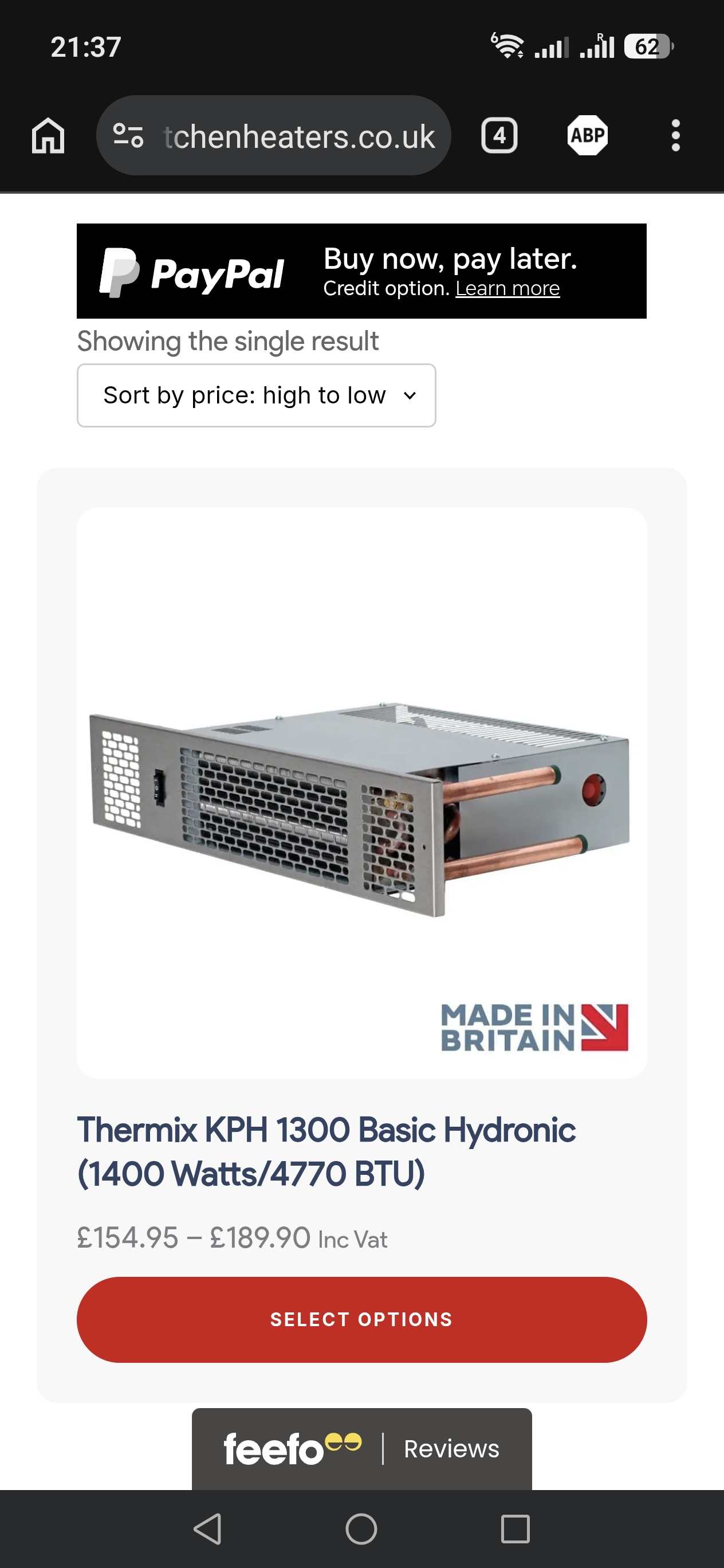

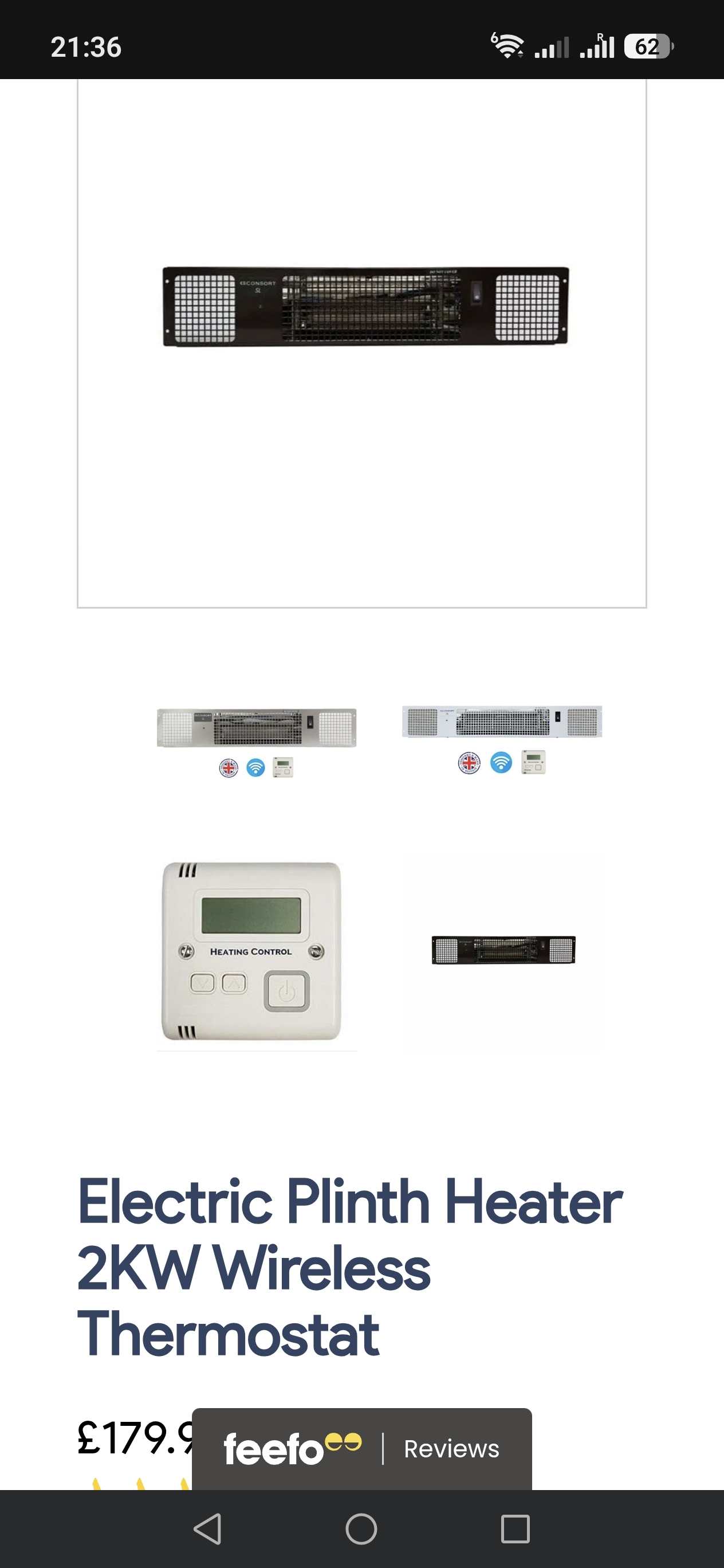

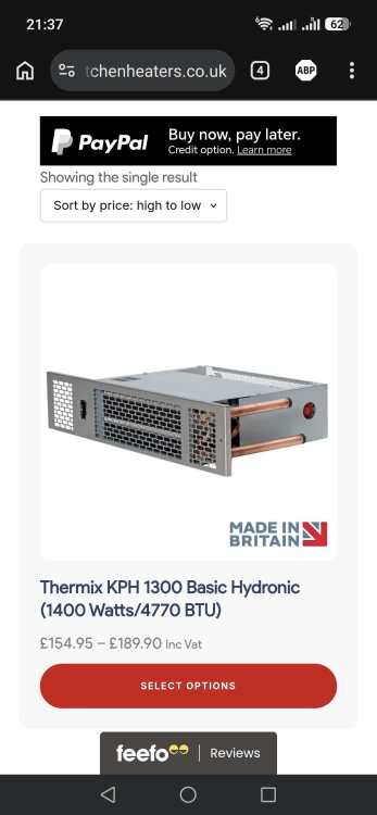

September 24Sep 24 There's rads there already I think. One thing that doesn't get mentioned much is plinth heaters. You could get the cosy toes feeling without all the pipes etc. Has anyone used one?
September 24Sep 24 19 minutes ago, Iceverge said: Has anyone used one? Fitted loads, hydronic and electric, but I do have to tell the clients they clog up with dust and are a maintenance item. They do the job well, just a bit of a noise / draught annoyance imho.
September 24Sep 24 I've got 2 plumbed in plinth heaters that fire across my 8m doors from either side. They are connected to my radiator circuit so rarely used, but when they are on the heat they chuck out is pretty impressive. I only put them in as I was dubious on UFH performance so just ran the plumbing before I locked my floor in. Turns out I shouldn't have worried, but I'd bought em, plumbed em, made sense to just whack them in at that point. I've got 2 Smiths SS5.
