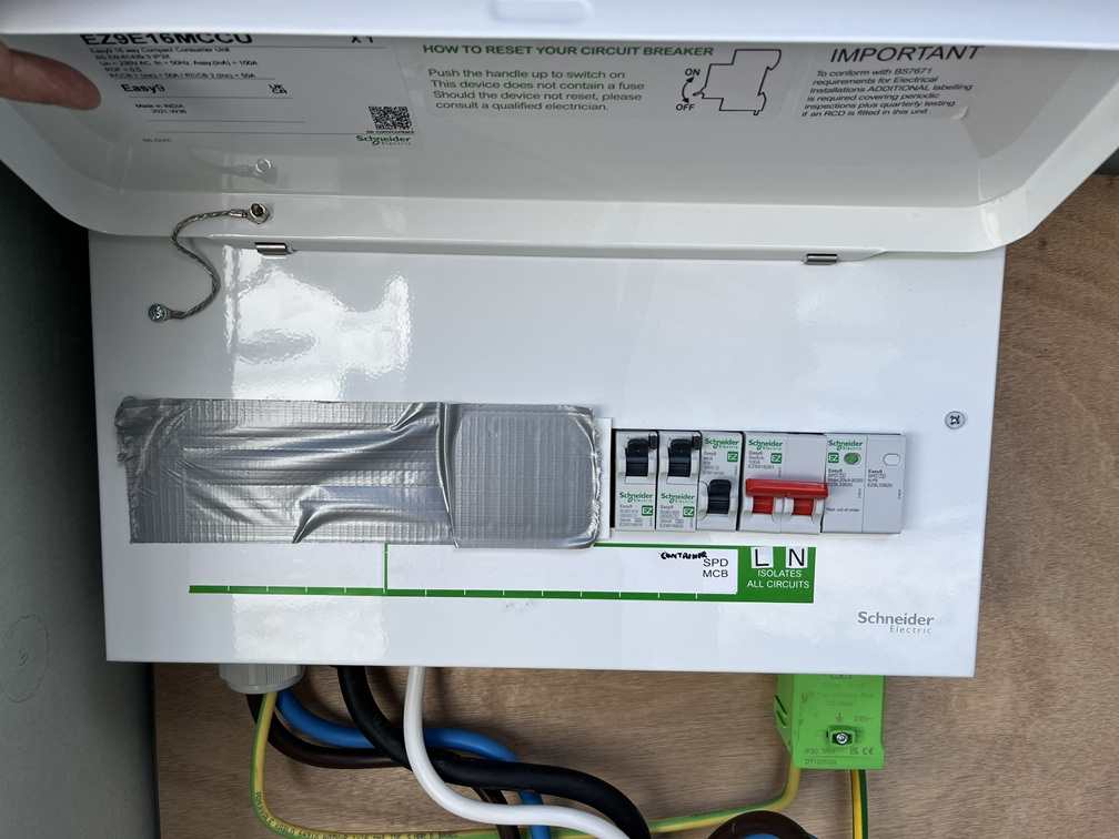

Yes, I know ... ask your proper electrician - but I'm an EE and feel happy making  these choices. Also, our 1st recommended & qualified electrician on site did this, and won't be back again:
Yes, that's gaffer tape as blanking plus wood screws holding the new CU front plate on FFS ... seems to me that's qualified but not competent.
