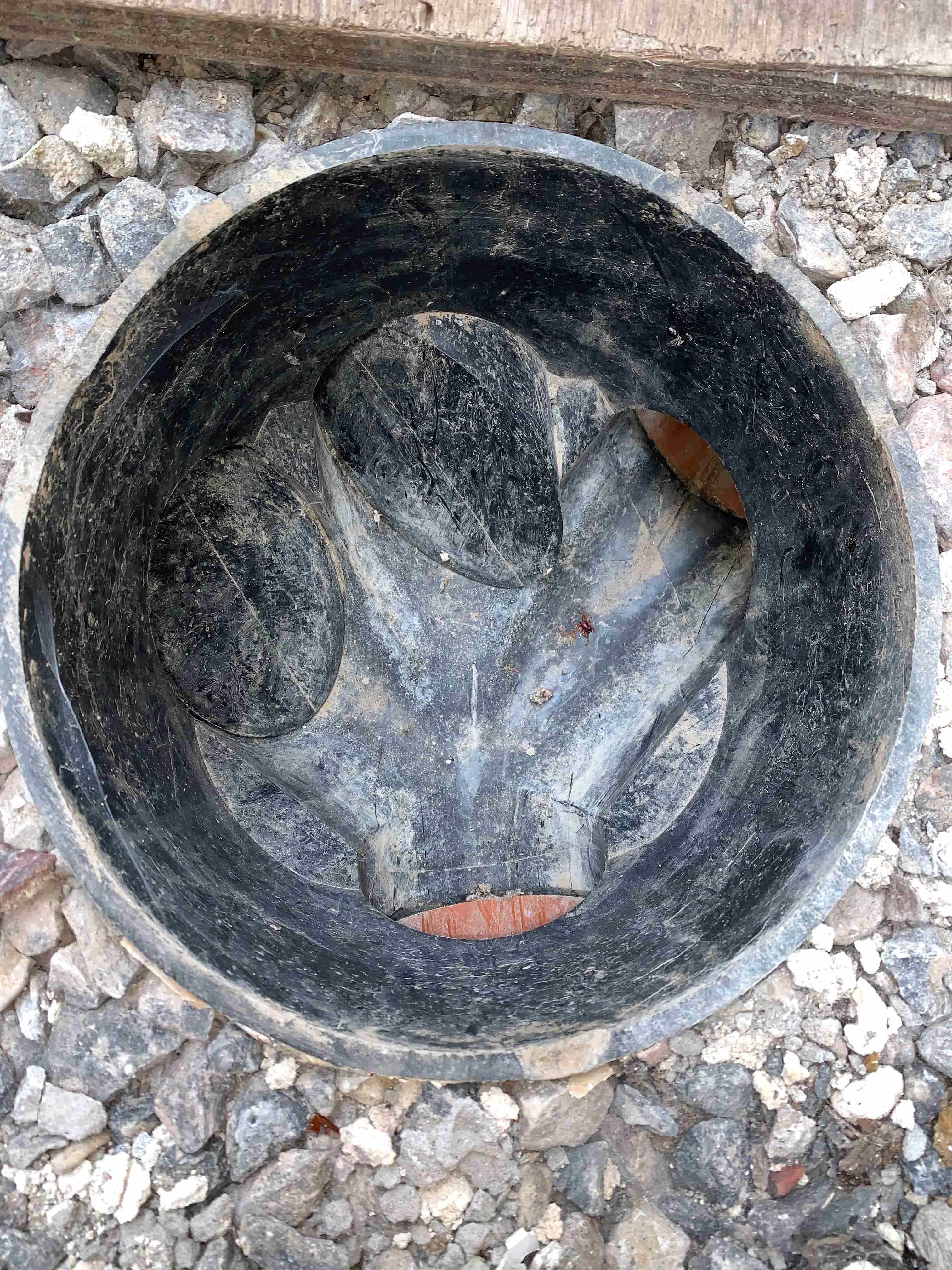

1/ Drainage Chamber - does it need changing ?
The photo shows a drainage chamber installed by my long departed builder. The kitchen sink & dishwasher waste water will come down from the top right, and then flow out at the bottom of the photo. A drainage guy today told me it has been installed wrong and there should be a swept bend between inflow and outflow. The fall is not high and the input pipe is about 4m long. Should I get it sorted now with some other drainage issues, or leave well alone ? And what should it look like ?

I’ve not seen a base like that one tbf, being pragmatic about it, if it’s grey water and it flows without stalling then I don’t see a reason to change.  Don’t understand why you’d need a swept bend, the chamber is fine as that provides a bend between in and out.
You can buy a one way valve that you can pop in and it stops rats.  Amazon sells a good quality Rosshield one.   And yes, they can swim.
The chamber is fine.  The old chambers with the traps often get blocked and are not used now.  The rat blockers fitted inside the chamber work well.
