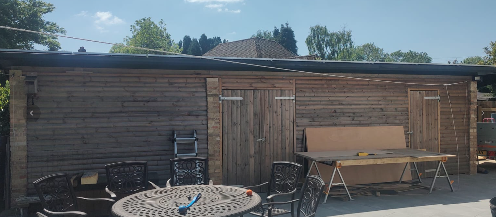

I have an outbuilding that I'd like to insulate to make it useable as a workshop and to keep my solar batteries warm! I'd also like to reduce the rusting of tools etc stored there
The visible sides are all loglap but the rear is a combination of old brickwork and (currently) sterling board

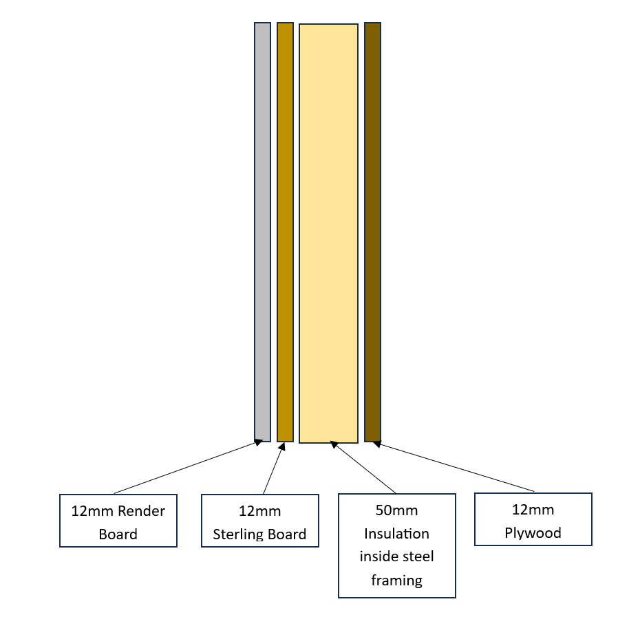

I have some Versarend render board left over, enough to completely cover/replace the sterling board. Do I need a vapour layer and where?

Tools rusting is more related to lack of ventilation than insulation.
Ideally add one on the inside wall, behind the ply.
I would add a mineral wool insulation.
If you ventilate it well to keep it nice and dry then unless you heat it at times it will be flippin freezing.

1.Render-board
2. 50mm Batton so you have void and air
3. some sort of waterproof breather membrane (tyvek housewrap for example)
4. osb
5. insulation
6. vcl (tyvek airguard reflective for example )
7. Plywood
