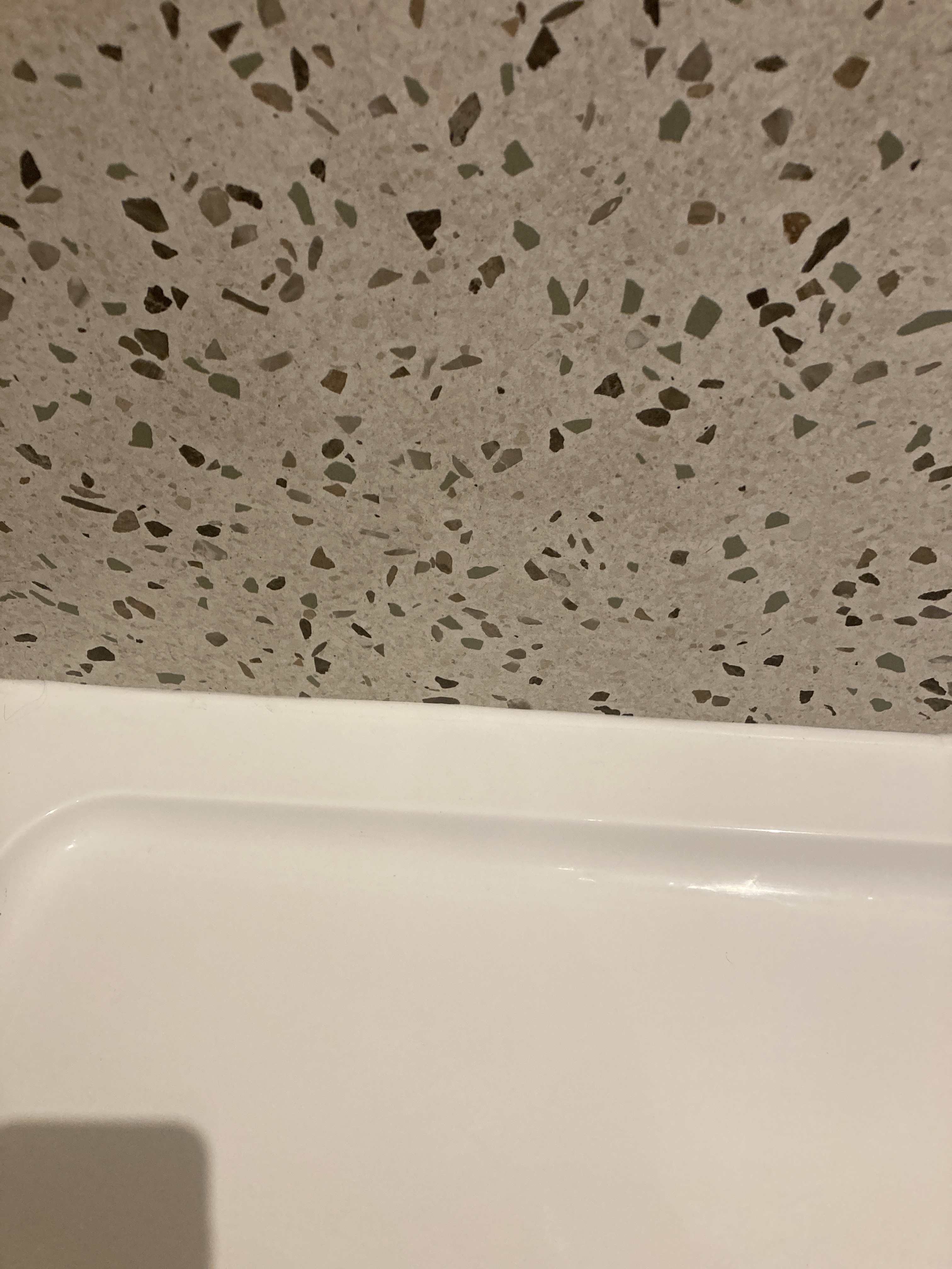

I always grout that joint, to the shower tray, pushing it in deep with a sponge and leaving a valley on purpose.
After grout is bone dry, 2 days or so, I use clear CT1 and use it very sparingly to create the final seal.
Lasts decades, whereas silicone doesn't, plus white silicone is a bar steward to keep looking fresh.

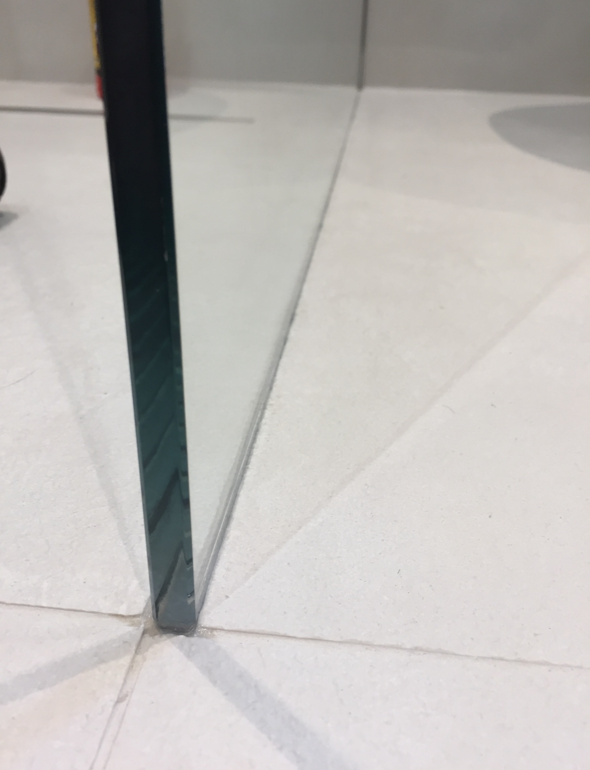

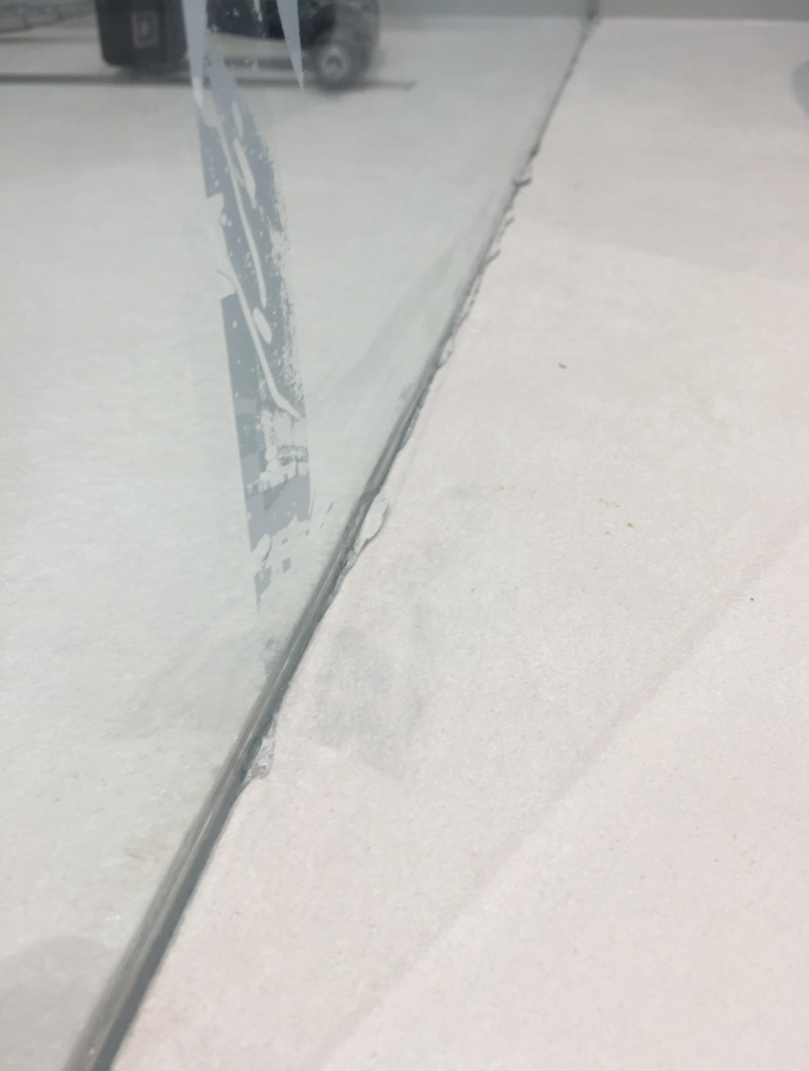

Glass set down into CT1, excess evident.
Excess wiped away when wet, with lots and lots of baby wipes.

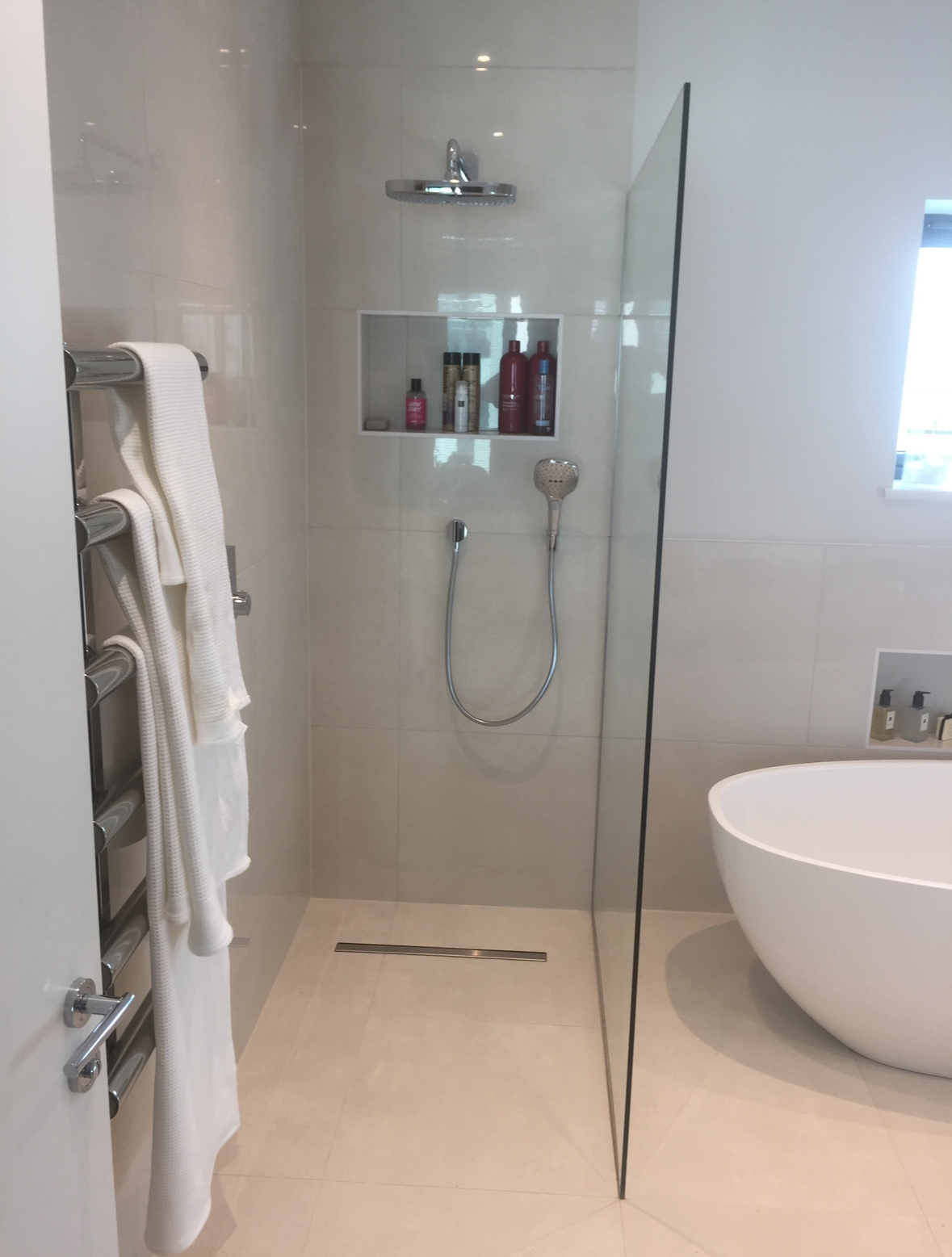

Apart from the rising internal corner and the internals of the niche, all of this ensuite was a near zero silicone finish. All observing minimal grout at junctions, clear CT1’d with anything excess removed, and still looks 👌 (imo). You can just about see where the colour matched silicone diminishes on purpose before meeting the floor tile, so the change isn’t so obvious.
