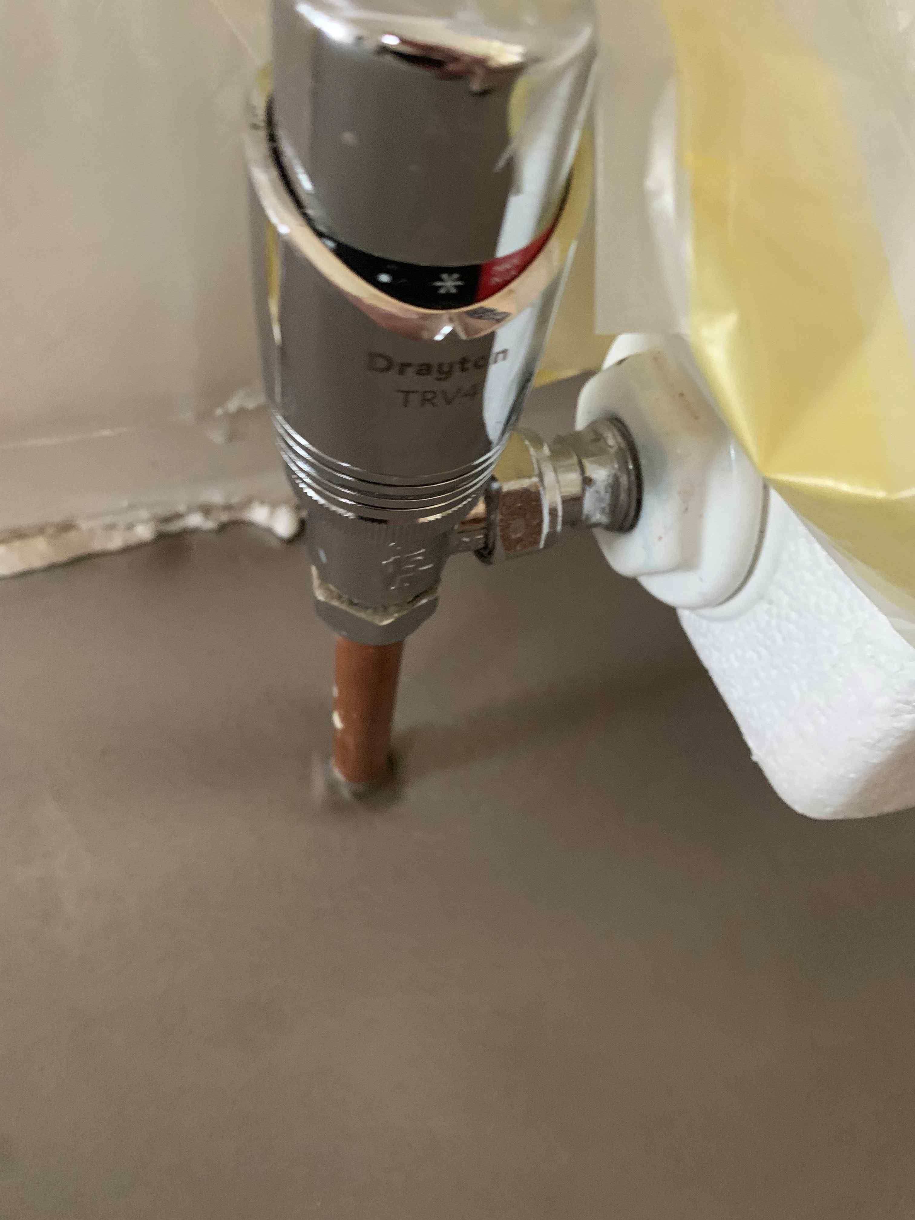

Floor levelling finished at last, but wonder what is best for radiator pipes coming through the leveller ? (See Pic)
The leveller has effectively cemented the pipes into position. Is this OK or unwise ?
LVT will be going down on the floor.
Possible issues - Will this make it problematic to remove and reinstall the rad because of lack of play on the pipes ? Will the heat from the pipes crack the leveller or effect the LVT ?
Cementitious products, especially when laid wet and allowed to cure, will corrode the copper prematurely.
Gently chip away around the pipe and clear it away, just a few mm, and then buy some pipe collars to cover up cosmetically.
OK thanks. Googling and AI seem to give conflicting statements some saying it may corrode the pipe other saying it will be ok.
But best not to take the risk.
I will chisel it clear, maybe the LVT could be laid up to it without a collar ?
On the other hand maybe a plastic chrome look pipe cover and collar will look tidy.

Kinda conflicts with all the perforated, leaking copper heating pipes I have dug out over the years.

Seems best to free the pipe regardless as not sure of the possible stress on the pipe when it is anchored but expands and contracts.
