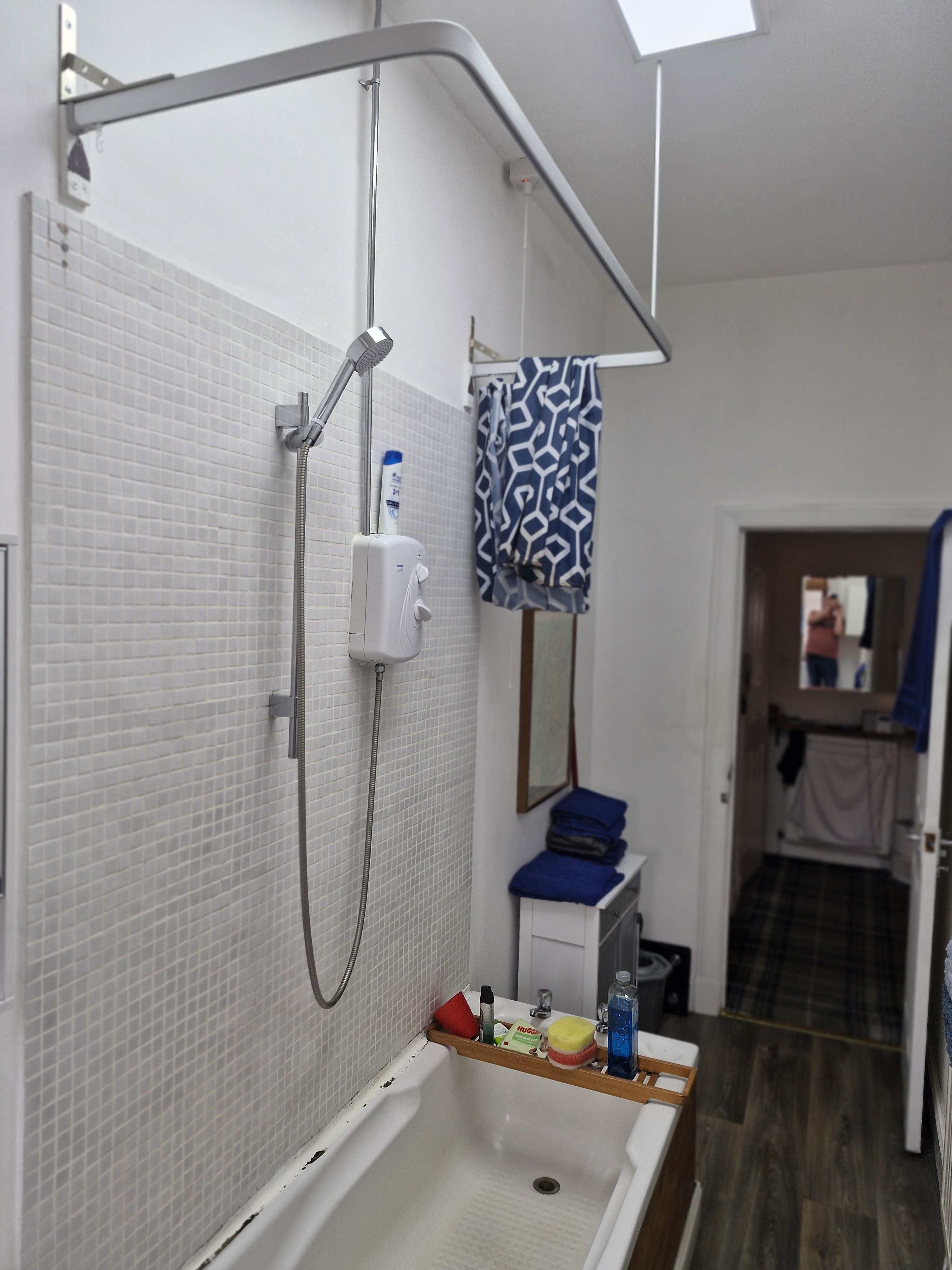

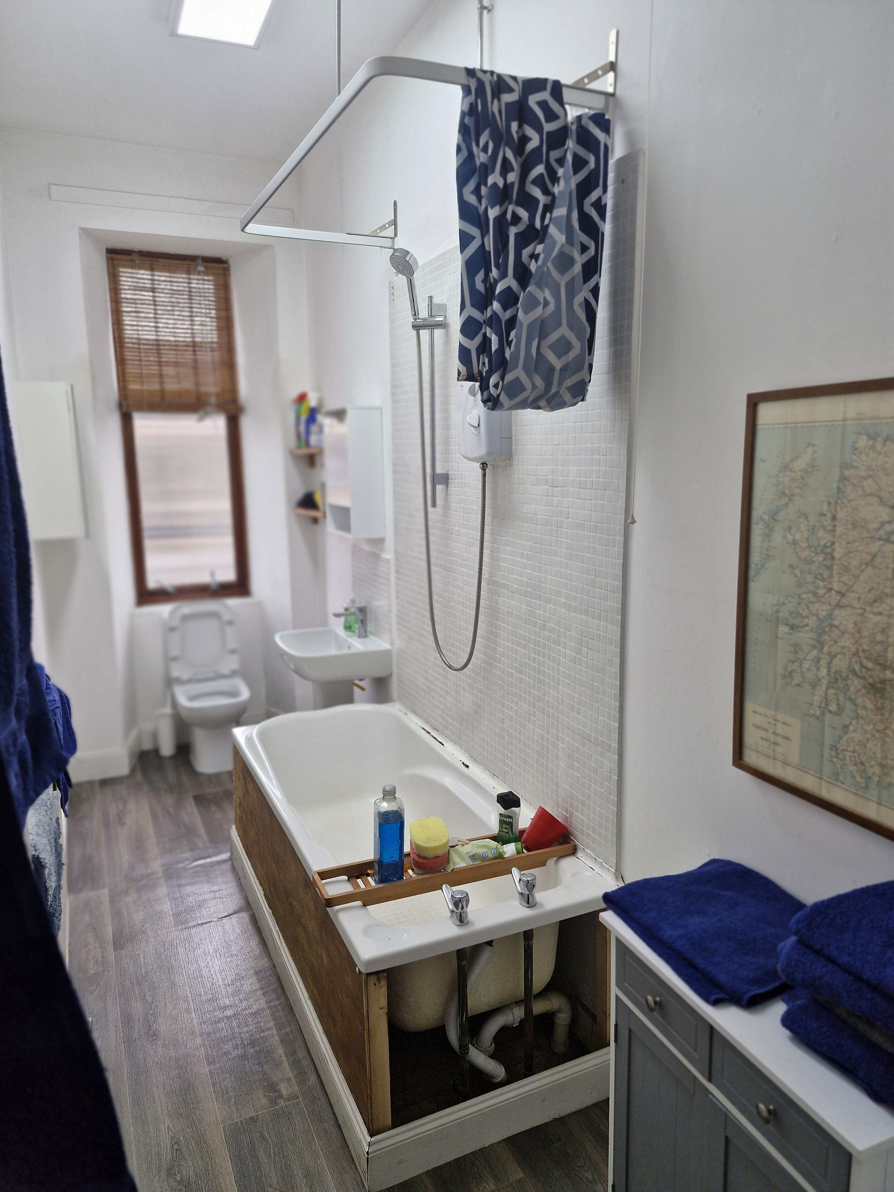

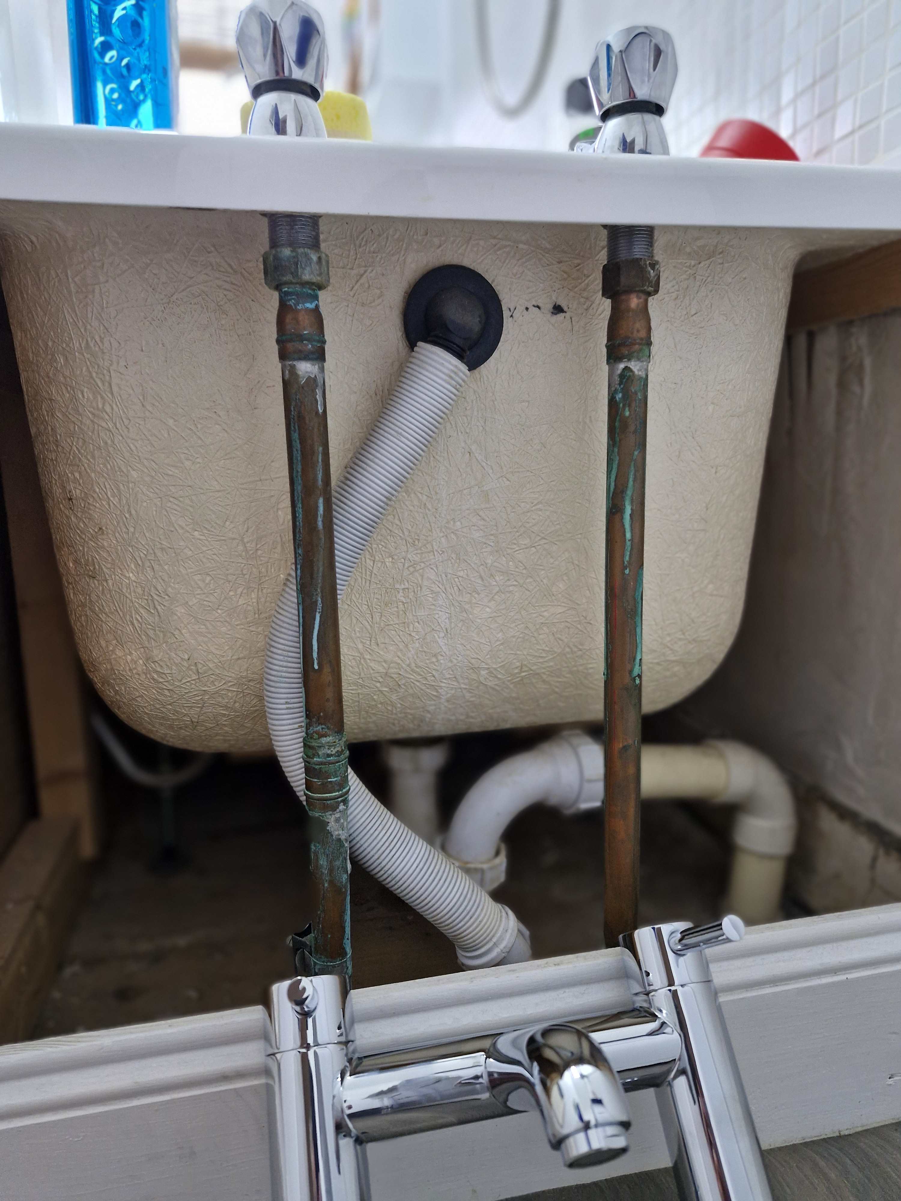

Tennentslager Posted June 26 Posted June 26 I've bought the bath and taps and panels for three sides. Also two bits of 1m x 2.4m wall panel. Its a 1700 x 700 bath, old one has mould as it was never an over shower job. so first Q is if i need wriggle room for taps...is the height of new bath exactly as old? Can i fit a flexy? Next Q Its a long narrow bathroom. Replce tile area as is, with wallboard...or As wallboatd is 2400 x 2000 some other shape? finally, wallboard behind bath or butt against top. its a new straight shower bath, no lip, no nothing just square
Nickfromwales Posted June 26 Posted June 26 13 minutes ago, Tennentslager said: @Nickfromwales You're supposed to say it 3 times....... anyhoo So, what we see is getting removed and replaced? You've bought a shower bath? e.g. one that can be stood upright in, and has the correct additional reinforcement etc.
Tennentslager Posted June 26 Author Posted June 26 Aye But its used daily for disabled son, he likes a soak. And very occasionally for his support workers who have the odd shower. Ergo the shower curtain can be out of matey boys way. Its 90% for him 10% for staff team, how it looks is secondary to function.
Nickfromwales Posted June 26 Posted June 26 3 minutes ago, Tennentslager said: how it looks is secondary to function. Agreed, but a bath that's not meant to be stood in moves and flexes a LOT, which causes seals / silicones / grouts to perish and the same issues to repeat themselves. Most baths I fit with shower 'over' them are Trojan Cast. Bombproof. Even if only occasional use as a shower bath, it'll still need to not budge. I always fit a batten along the wall, 2mm shy of where the underside of the bath will be, and set the bath into a fat bead of CT1, and use the same to bond the back edge of the bath to a tanked or primered wall, before sealing again, and then tiling.

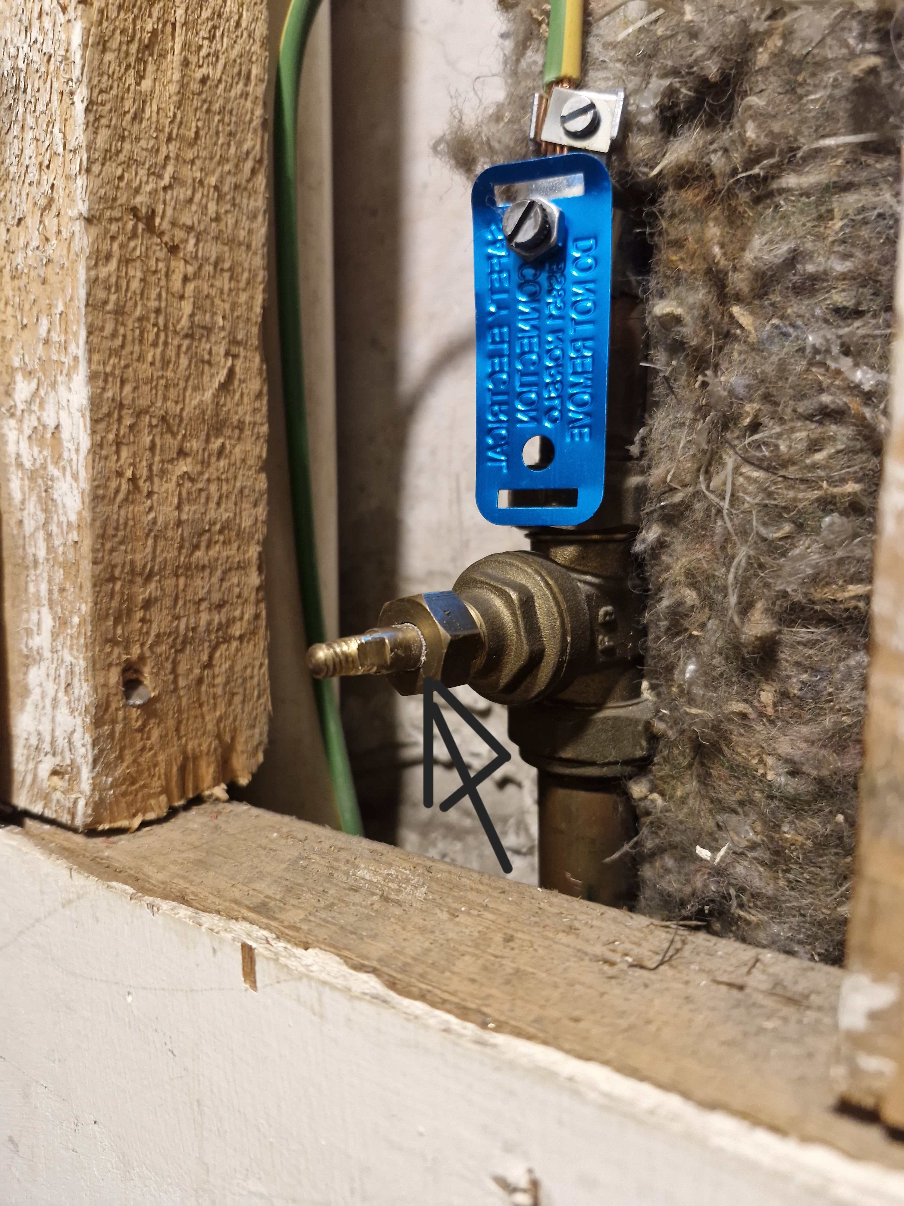

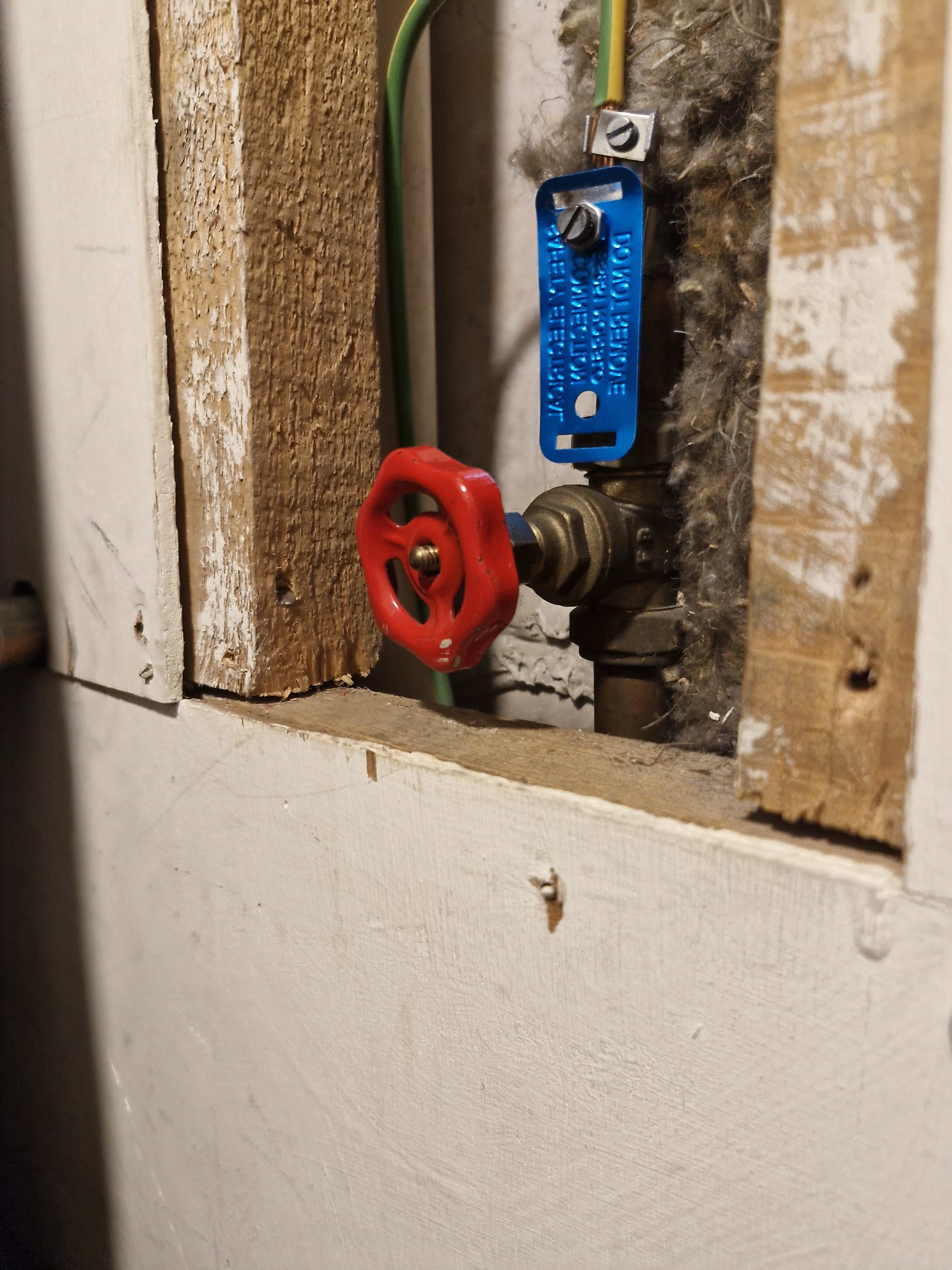

Tennentslager Posted July 4 Author Posted July 4 Not having much success... This i think turns off the bath tap. The stopcock under the kitchen turns off kitchen taps and feed to combi so also bath hot tap. BUT when I turn the red wheel the hex nut below also turns, afraid to keep turning it anti clockwise in case it pops off. I think hex nut is a retaining nut. Where am I going wrong here?
Nickfromwales Posted July 4 Posted July 4 Put a spanner on the hex nut to hold it still, and give it a slight tighten when you're done. The internals of this gate valve may have seized, as these don’t last forever and dislike being in one place forever and then being asked to move. If you’ve got a combi then you’re high pressure hot and cold, and gate valves should be replaced with lever 1/4 turn ball valves. Simple route is to switch off the stopcock to the whole house, drain down, cut the bath pipes and fit speed-fit isolators in , then put the water back on.

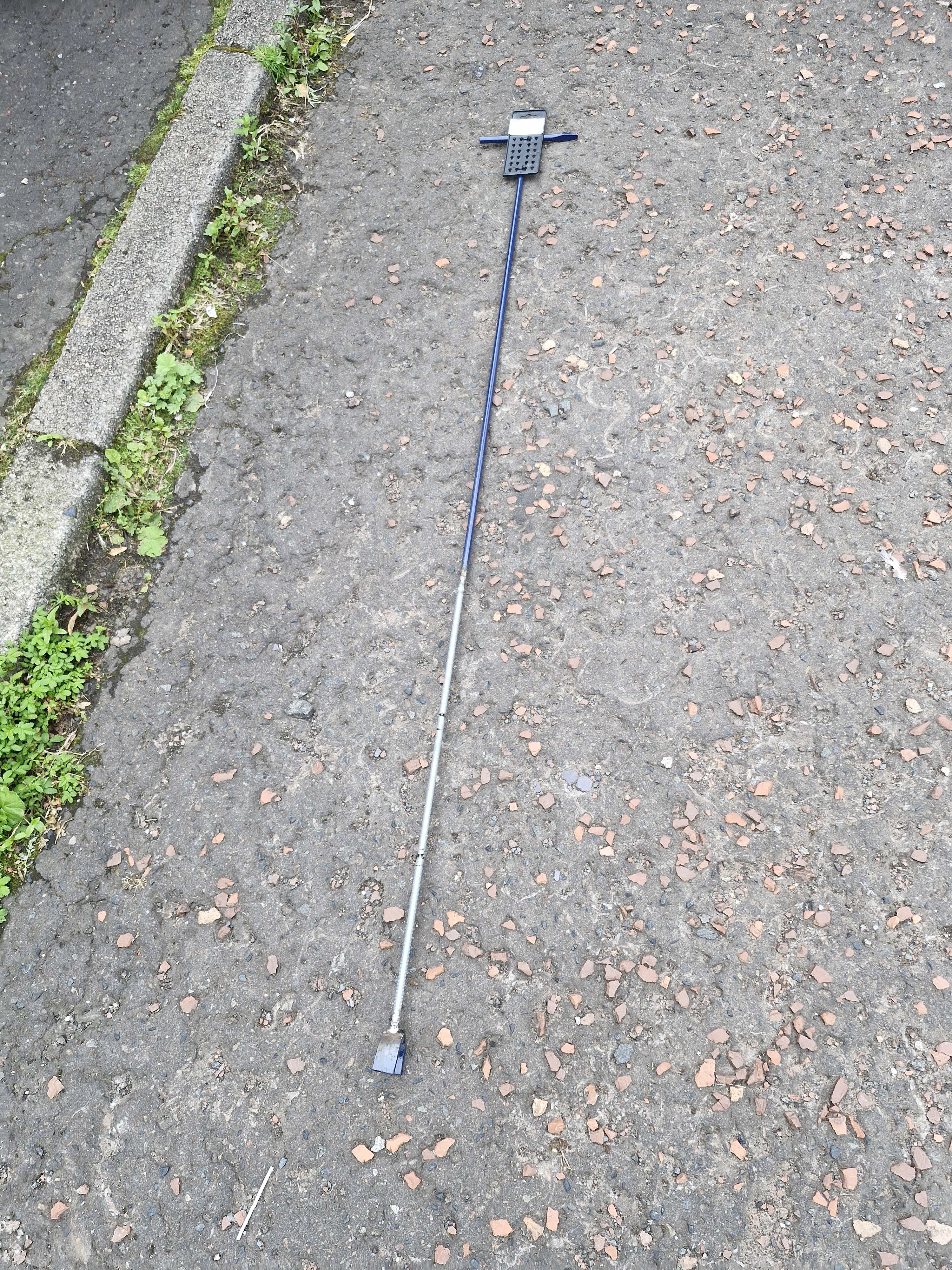

Tennentslager Posted July 4 Author Posted July 4 Its just spinning forever. Tired to turn off the whole block from the street but kid you not the on street one is 4 feet deep and the standard T key can't reach it. When I did the wash basin had to cut it the 15mm pipe live and push a speed fit valve in. That one only oozed out a small amount, the pressure in this one is a lot, the tap fairly pushes out water. Hmmm

Nickfromwales Posted July 5 Posted July 5 17 hours ago, Tennentslager said: Its just spinning forever. Tired to turn off the whole block from the street but kid you not the on street one is 4 feet deep and the standard T key can't reach it. When I did the wash basin had to cut it the 15mm pipe live and push a speed fit valve in. That one only oozed out a small amount, the pressure in this one is a lot, the tap fairly pushes out water. Hmmm Is this a gravity hot water system? Or have you had a combi boiler conversion?
Tennentslager Posted July 5 Author Posted July 5 Not sure but Glasgow tenements were fully refurbished in the 80s. This one was replumbed then. The was they did it was to fit all the pipe work on top of existing floorboards, then lay a new floor 6 inch above and fill the space with black gravel type stuff. It's maybe volcanic as its vert light. Also very common they removed the chimneys and water tanks from the lofts. So I'm pretty sure its mains fed. There is a combie boiler but I suspect the bath cold tap is mains fed. The hot tap goes via the combie but if I turn off stopcock under kitchen sink the hot tap stops running...make sense?
Nickfromwales Posted July 5 Posted July 5 1 hour ago, Tennentslager said: Not sure but Glasgow tenements were fully refurbished in the 80s. This one was replumbed then. The was they did it was to fit all the pipe work on top of existing floorboards, then lay a new floor 6 inch above and fill the space with black gravel type stuff. It's maybe volcanic as its vert light. Also very common they removed the chimneys and water tanks from the lofts. So I'm pretty sure its mains fed. There is a combie boiler but I suspect the bath cold tap is mains fed. The hot tap goes via the combie but if I turn off stopcock under kitchen sink the hot tap stops running...make sense? Yup. Stopcock is the boss of all hot and cold now most prob, meaning you don’t (shouldn’t) need to go outside to turn off the rising main. Turn the stopcock off, and open the kitchen hot and cold taps until they run dry. Then, go around opening and closing every other hot and cold outlet in the house, plus flush all toilets and check they’re not refilling, to prove the stopcock is your master water shut off. Give that a whizz and reply back here with the results.
Tennentslager Posted July 5 Author Posted July 5 Stopcock off Kitchen taps, no water. Bathroom no hot. Cold at bath and basin and cistern all running. Hot at bath and basin no water. BTW cistern and basin all have individual valve. Just realised shower above bath too is still running. Im going to have to get an extra long key made
Nickfromwales Posted July 5 Posted July 5 55 minutes ago, Tennentslager said: Stopcock off Kitchen taps, no water. Bathroom no hot. Cold at bath and basin and cistern all running. Hot at bath and basin no water. BTW cistern and basin all have individual valve. Just realised shower above bath too is still running. Im going to have to get an extra long key made Yup. Or, there’s another (the primary) stopcock in the house that you aren’t aware of. 55 minutes ago, Tennentslager said: Im going to have to get an extra long key made Just don’t snap the head off the tap. Have someone in the house with the kitchen sink cold tap open 1/4 of the way, on the phone with you, and the second the water shuts off STOP turning the mains off any tighter.
Tennentslager Posted August 6 Author Posted August 6 Nice fella at the garage near work extended the stopcock key. Asked how much, don't be daft he said, wonderful that some folk are just so nice 4
Tennentslager Posted August 7 Author Posted August 7 Nice fella at the garage near work extended the stop cok key. Asked how much, don't be daft he said, wonderful that some folk are just so nice
Tennentslager Posted August 7 Author Posted August 7 Gave it some big welly. In both directions to the extent the tool remains firm on the lug but the T-bar is at 45° and the rod mental is in full twist but it won't budge a midges ball hair. I'm right (am I not) that to turn OFF you screw clockwise? Zoom in its a flat bar connection, standard stuff...
Conor Posted August 7 Posted August 7 Phone Scottish water and they will send somebody out to sort it. 1 1
Nickfromwales Posted Saturday at 09:03 Posted Saturday at 09:03 Tell them you are without water and they'll escalate this and get to you pronto. When they arrive simply say you managed to get it back open ‘slightly’
Tennentslager Posted 6 hours ago Author Posted 6 hours ago Filled in the Web form on Monday 11am, got a call from a human around 2pm from Scottish Water said he had booked the job. I would get two texts and normal time to fix was 5 days. Wednesday morning got a call from Callum to say he was on way and to tell him he had the job card and it was a stiff Toby...steady boys. Callum called back a couple of hours later to say, as he expected his giant key did the trick, all was well and Get this He only lives around the corner and to save his work mobile and any issues and he'll pop around right away. BTW the second text, I did not click it, was 'track your operative' so I guess a real time job like they do with deliveries. Fantastic service from the publicity owned Scottish Water Sorry for the dig poor old Thames Water customers!! 2
