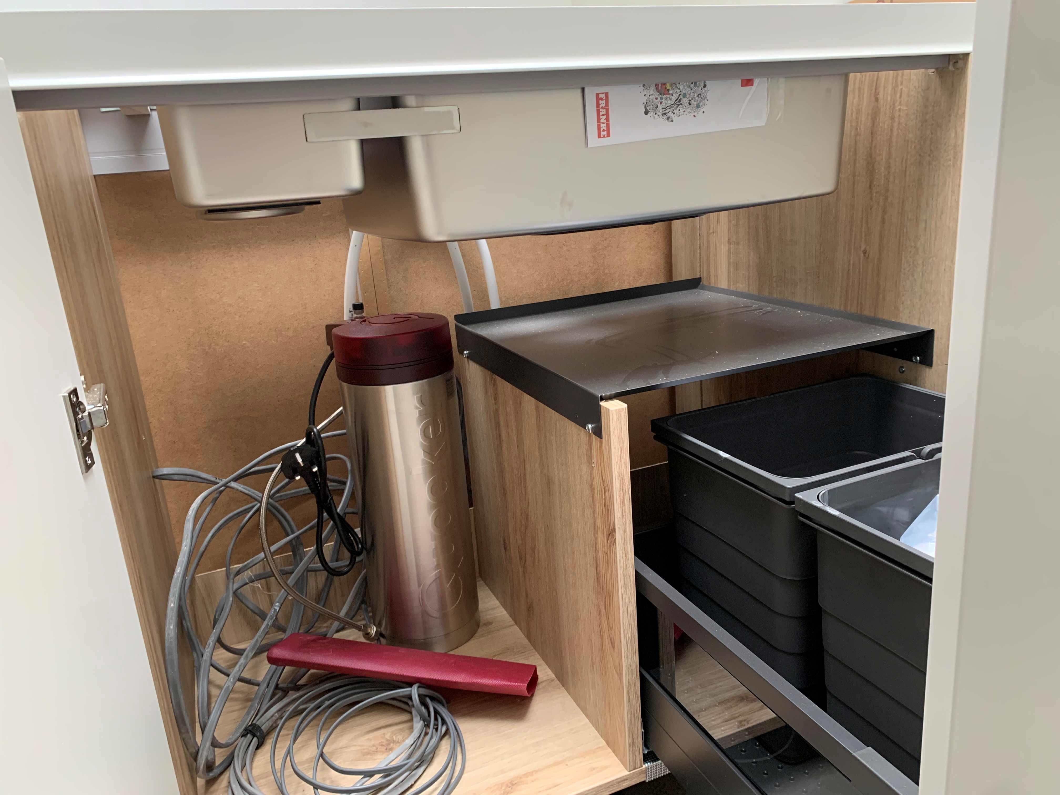

quooker boiling water only tap with Pro3 tank.
Plumber mentioned some people cut a hole in the base of the cupboard and install a dish in the hole so the tank can sit lower into the plinth space.
Anyone ever seen this, done this, point me at the metal dish people inset  etc ?
Anyone actually have a shelf in the same side of a cupboard as the tank and cut around it or in front of it ?
In fact if anyone has a photo of an installed quooker in a kitchen cabinet it would be helpful. Looking to work out best positioning for tank, and socket etc

I fail to see how a drawer will fit. It would have to be a shallow drawer to allow the Pro3 to fit behind? And then accessing the unit could be a faff maybe? We just have a wide double door cupboard that has no shelves to give space for all the plumbing and Quooker units. It does all take up quite a lot of space.
sadly I don’t have a photo to hand.
Yes, I had to cut out a section of our cabinet base as we have a massive sink, water filter and waste disposal unit, just no room for the tank. Looks a right mess but there nothing else in there so door is rarely opened.
No havn't got an especially deep sink, just wanting to maximise the remaining cupboard space because IMO you can never have enough cupboard space.
Kitchen company have now said there is a metal shelf to be installed which they normally cut to fit around the quooker tap.
