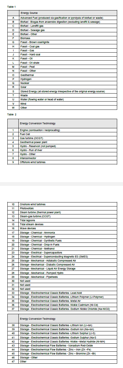

OK for anyone following along from home, for UKPN:
(1) Go here Distribution Energy Resources (DER) | UK Power Networks
(2) 'Buy' the forms for free from here: ENA Document Catalogue and they'll email them to you (FFS).
(3) Fill them in and email them to the address in (1).
(4) Laugh as you've received about 820 pages of closely written text and example diagrams of tidal lagoons etc.
(5) Consider whether Friday 4:30pm is too early for a beer?
Edited by Alan Ambrose
Actually reading through the list, I'm thinking of applying for pumped hydro using coal gas or peat fuelled steam turbine and then storage using either diabatic compressed ammonia or zinc bromide batteries. Maybe a little less than 50MW.

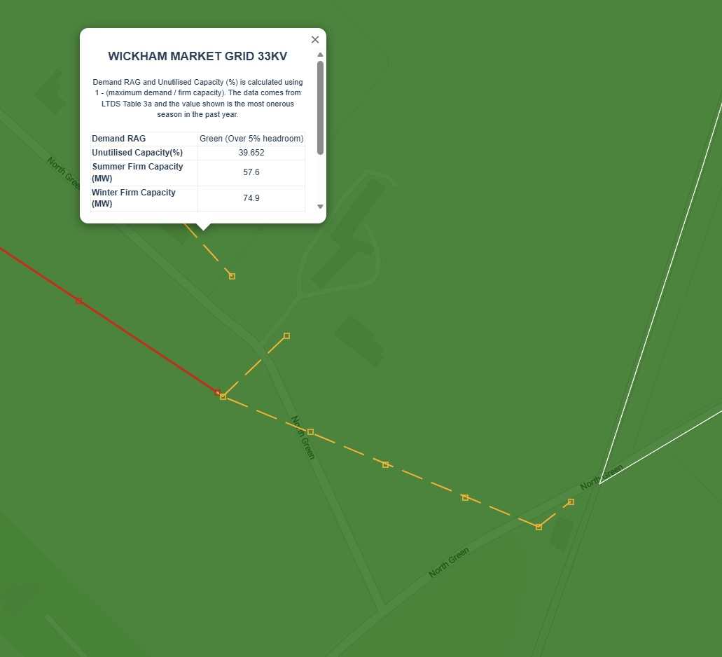

I don't think the network map has to be green to get an export consent. SPENs "heat map" for our area is all red but we had no problem getting a 7.5kw limit. I think the capacity shown on their heat maps might be for larger generator connections....maybe a solar farm or an AD plant. Don't let it put you off if its red!
