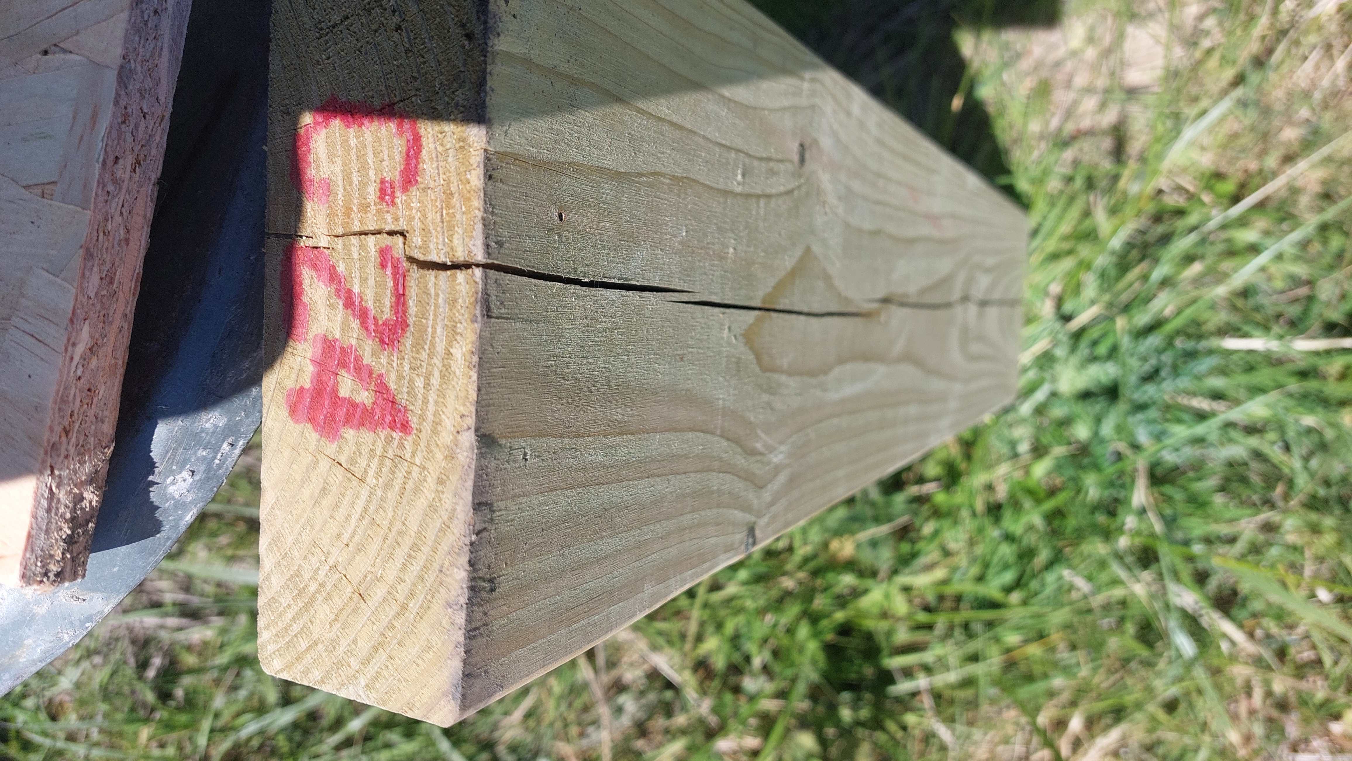

ab12 Posted 4 hours ago Posted 4 hours ago I'm a little bit confused. Have had a new extension built with pitched roof and 7 by 2 joists were use. When I measured the joist the other day to work out what insulation will fully fit the joits depth they weren't fully measuring 175mm but about 165mm. So technically theyre not truely 7 inches. Is this normal? Looks like real value is different from the nominal stated value. Does the same sort of things go for other timber e.g. studs. Bit confused
SteamyTea Posted 1 hour ago Posted 1 hour ago 3 hours ago, ab12 said: Is this normal Yes. I think the sizes are based on the rough sawn size, not the finished size. https://www.ryedaletimber.co.uk/blog/regularised-timber-sizes-uk-guide-to-nominal-vs-finished-dimensions/
