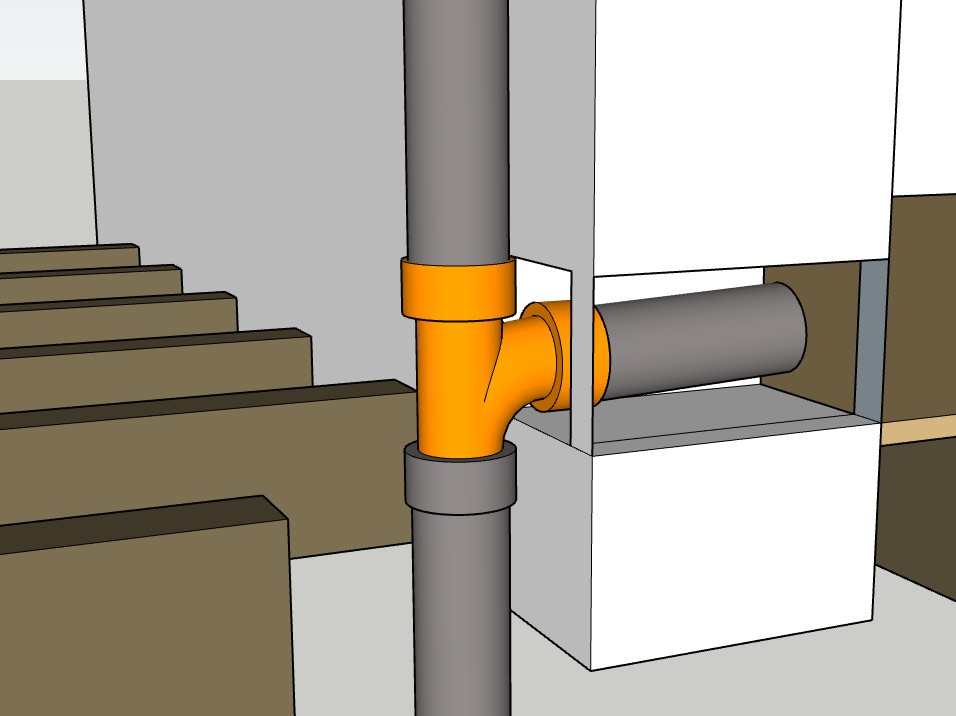

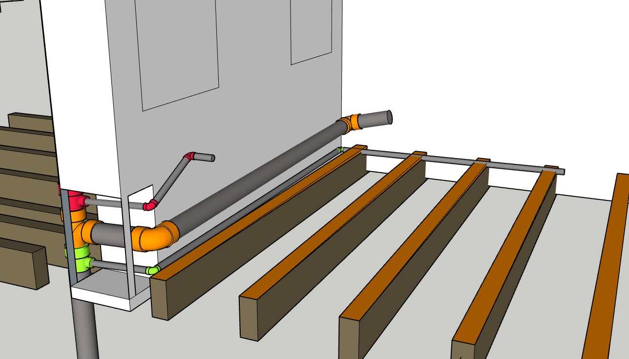

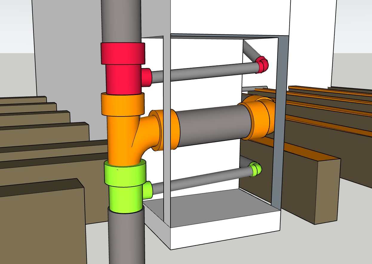

Posted (edited)

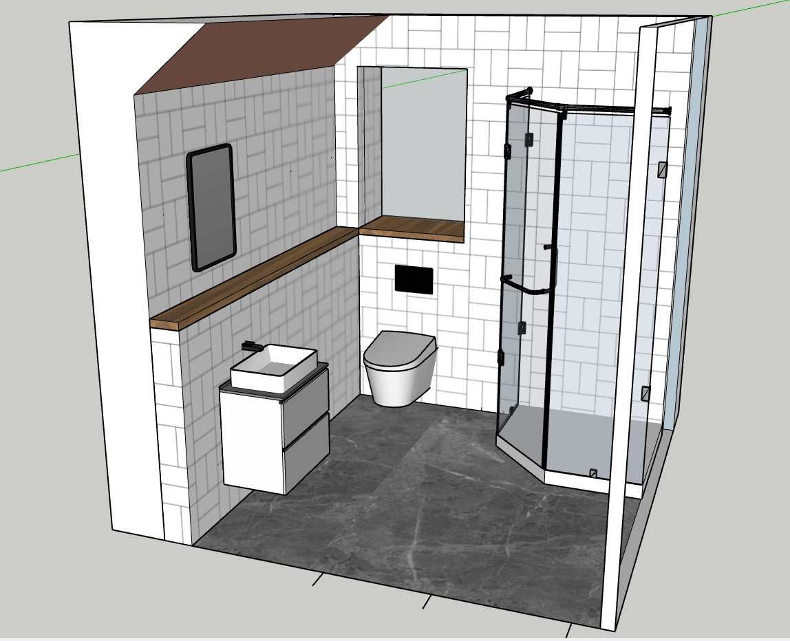

im looking at potential layouts for my small, 2.2m x 2.xm bathroom. Before i offer up any designs to the missus, would a run of the 110mm waste like this be ok? im not 100% on this, but if i can move the bog to under the window then i will. It just means i guess 3x bends to get to the stack, which is all internal and the horizontal is around 2m. No access to any outside wall or underneath.
Any thoughts guys?
