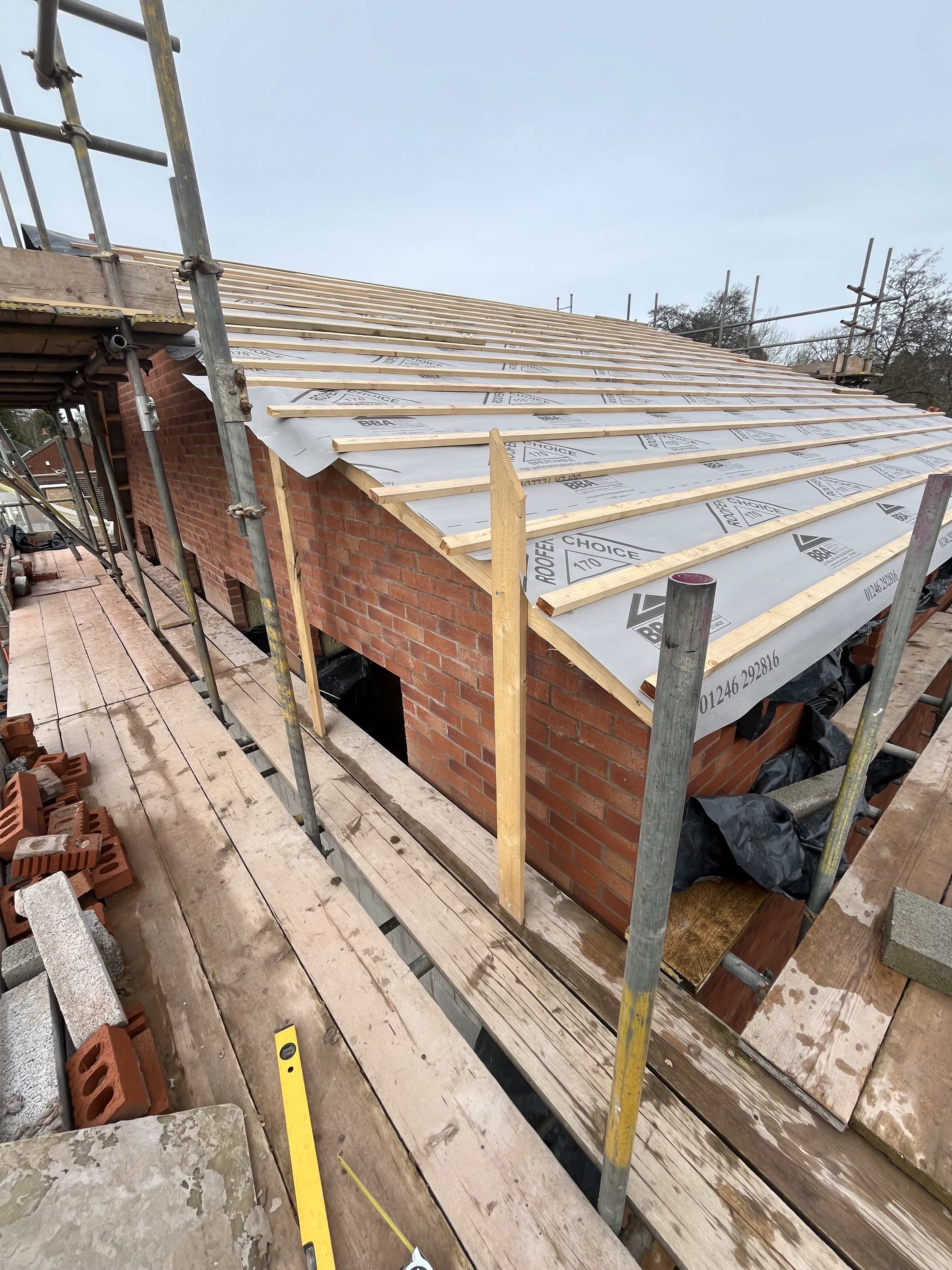

newbridgewolf Posted 13 hours ago Posted 13 hours ago Gable Verge Detail We are struggling trying to find dry verge product as an alternative to the traditional wet verge for a new roof on our self-build in progress (photo). We have tried Kytun but they say their products wont work with out slate and halfs. We are trying to find something neat, visually minimal and long life. Has anyone installed lead on the gable verges? Any suggetions or experiences, many thanks.

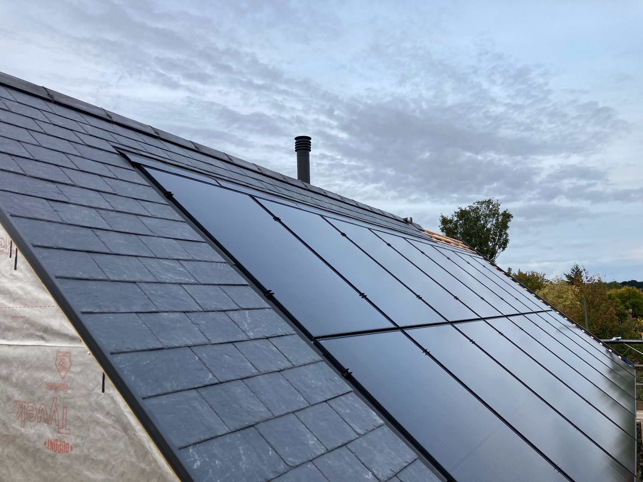

G and J Posted 3 hours ago Posted 3 hours ago We used kytun t2 with our slate and halves. Bit of fiddling to set out to allow for cladding, but pleased with the results.
