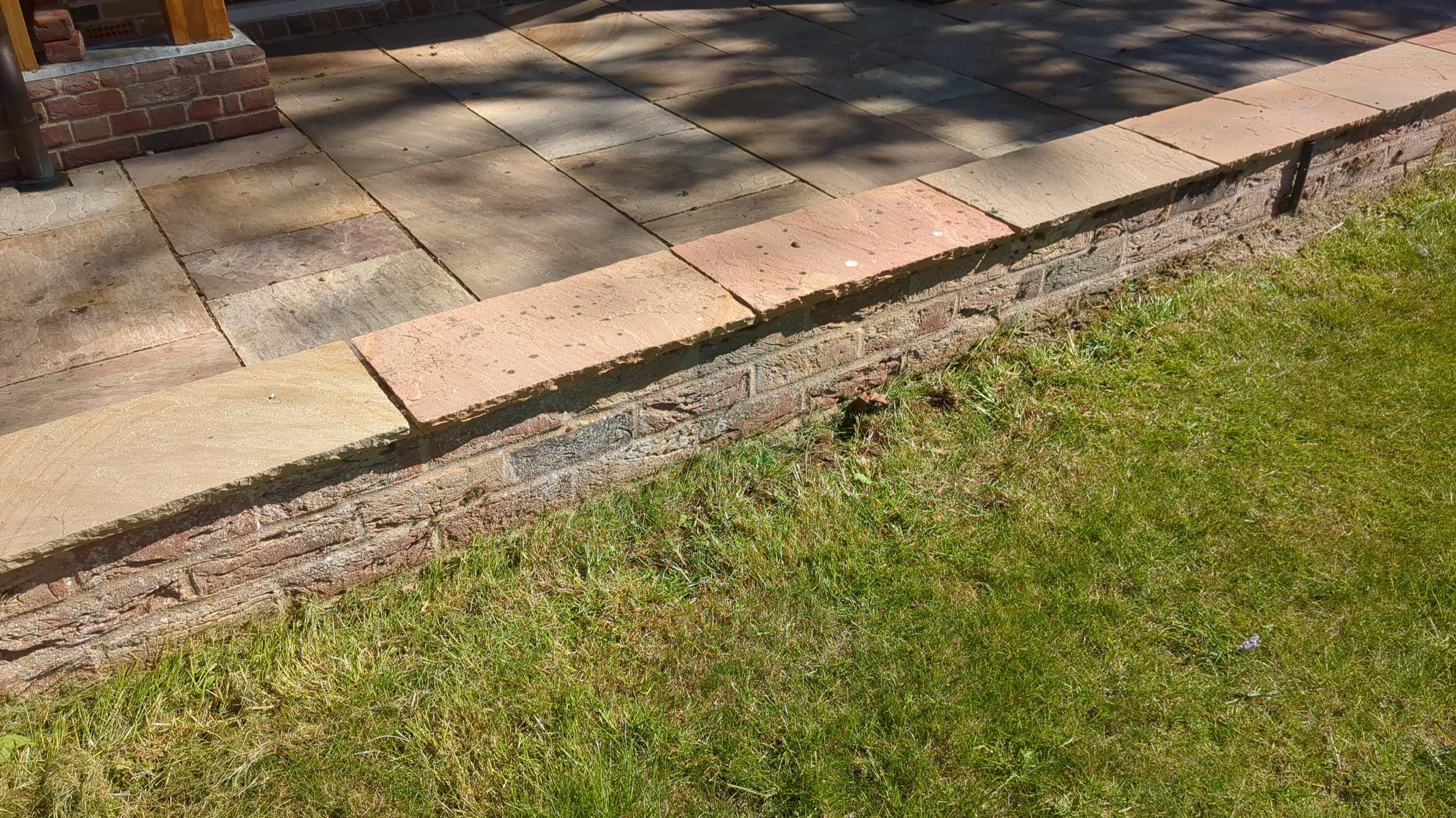

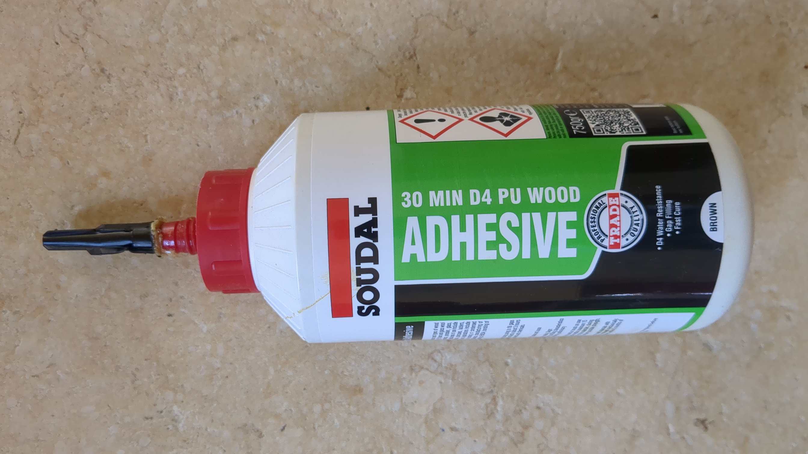

I replaced some paving/capping last year using foaming polyurethane adhesive. Worked great. Soudial or something like that it was called.
Edited by Temp
17774718128822009635174752819454.thumb.jpg.d25a1de15ca662c83a4ab8189c173186.jpg17774718382602985711202420612627.thumb.jpg.8123a156b3112964e09fcaf453c9aaaf.jpgThis is what I used. It foams up a bit so had to take care not to use too much that it came out of the joint.
