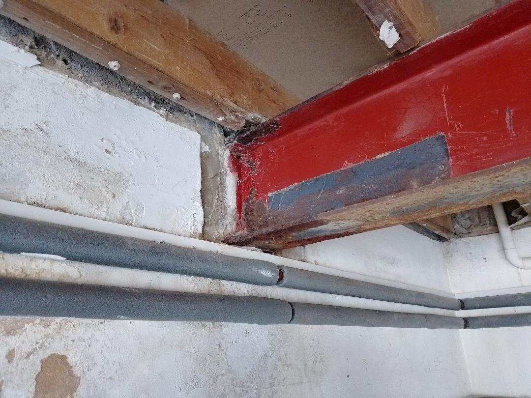

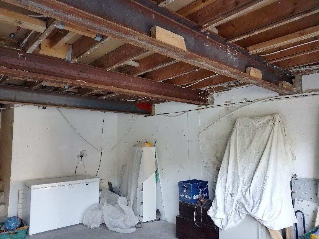

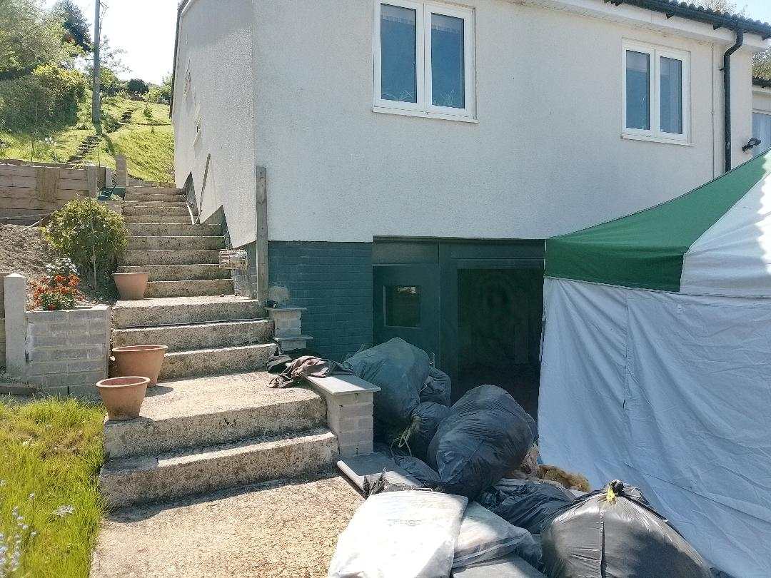

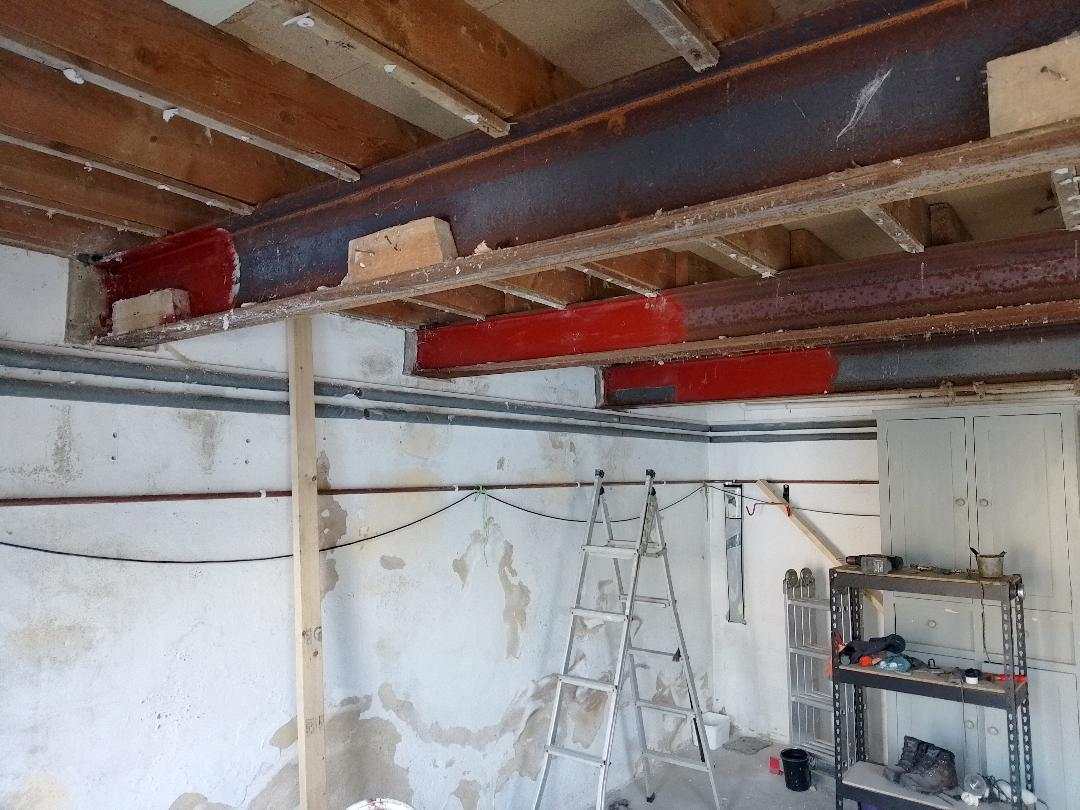

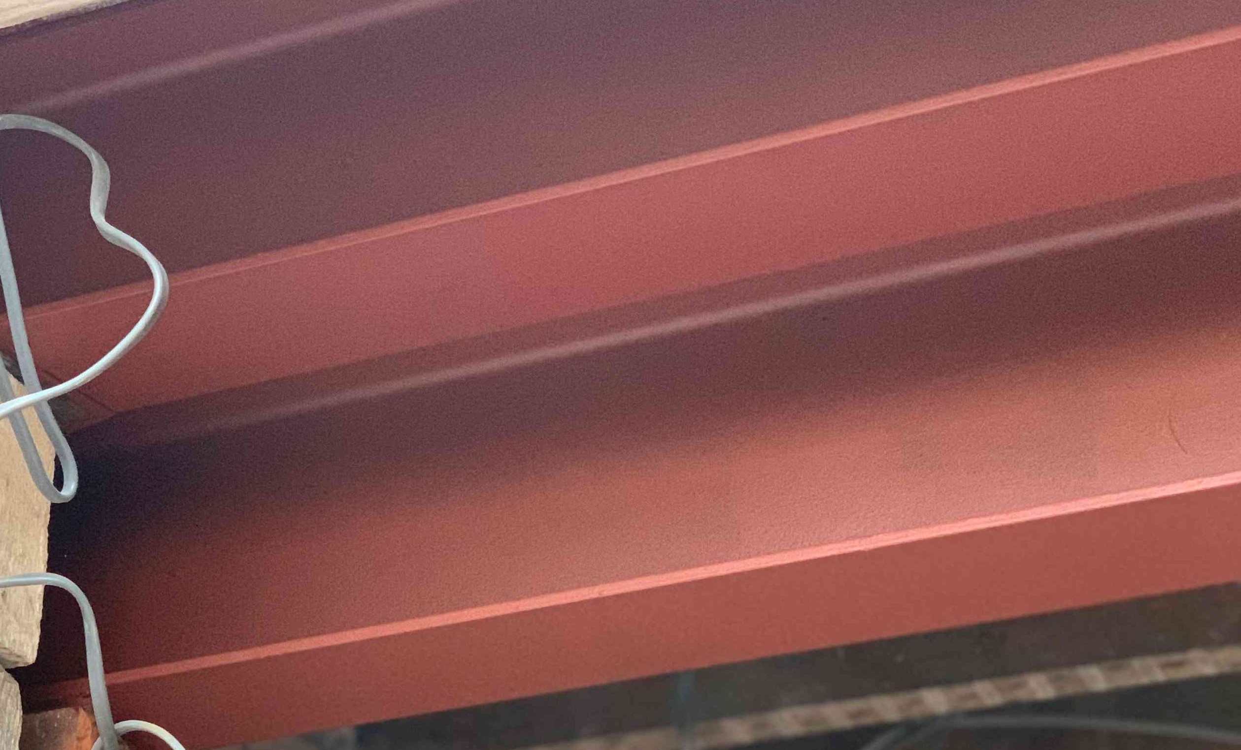

WiltshirePaul Posted 3 hours ago Posted 3 hours ago Hello all. first post for me as I've got issues at home and I'm overwhelmed.... Our house is from 1979/80, built into a greensand slope. The double garage sits under the front two bedrooms and bath/cloakroom. Those rooms are held up by three 6m spans of single and doubled up steels sitting in between 9inch cavity walls. We get a lot of water movement through the hill behind the house and although the garage walls get efflorescence it doesn't get wet. But there's corrosion to the ends of the steels that are underground. They were boxed in but I've cut all this off and removed fireboard, insulation and dead rats to mor or less start again. An old boy surveying engineer came round this week and said you need to stop the wet otherwise anything you do to the steels isn't going to work. His suggestion is to cut the steels and build block piers internally (if the concrete slab is thick enough (it isn't). I am getting views/price from the steel cutting firm and I need to do/arrange the slab to be cut and excavated so that 300mm of concrete can be laid as a pad for the blocks. Anyway, I just wanted to ask if there are other options open to me. I can't get to the outside side of the steels as there's a hill etc in the way - but I could cut and dig around the steels inside the garage to see what the damage is - is there any kind of treatment I can do around the steels in the wall itself to stop moisture getting to them? I should add that I intend to abrade the steels and prime/intumescent paint them afterwards as they were boxed in before. Thanks, Paul

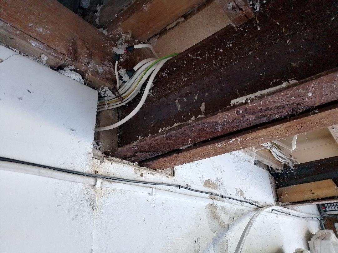

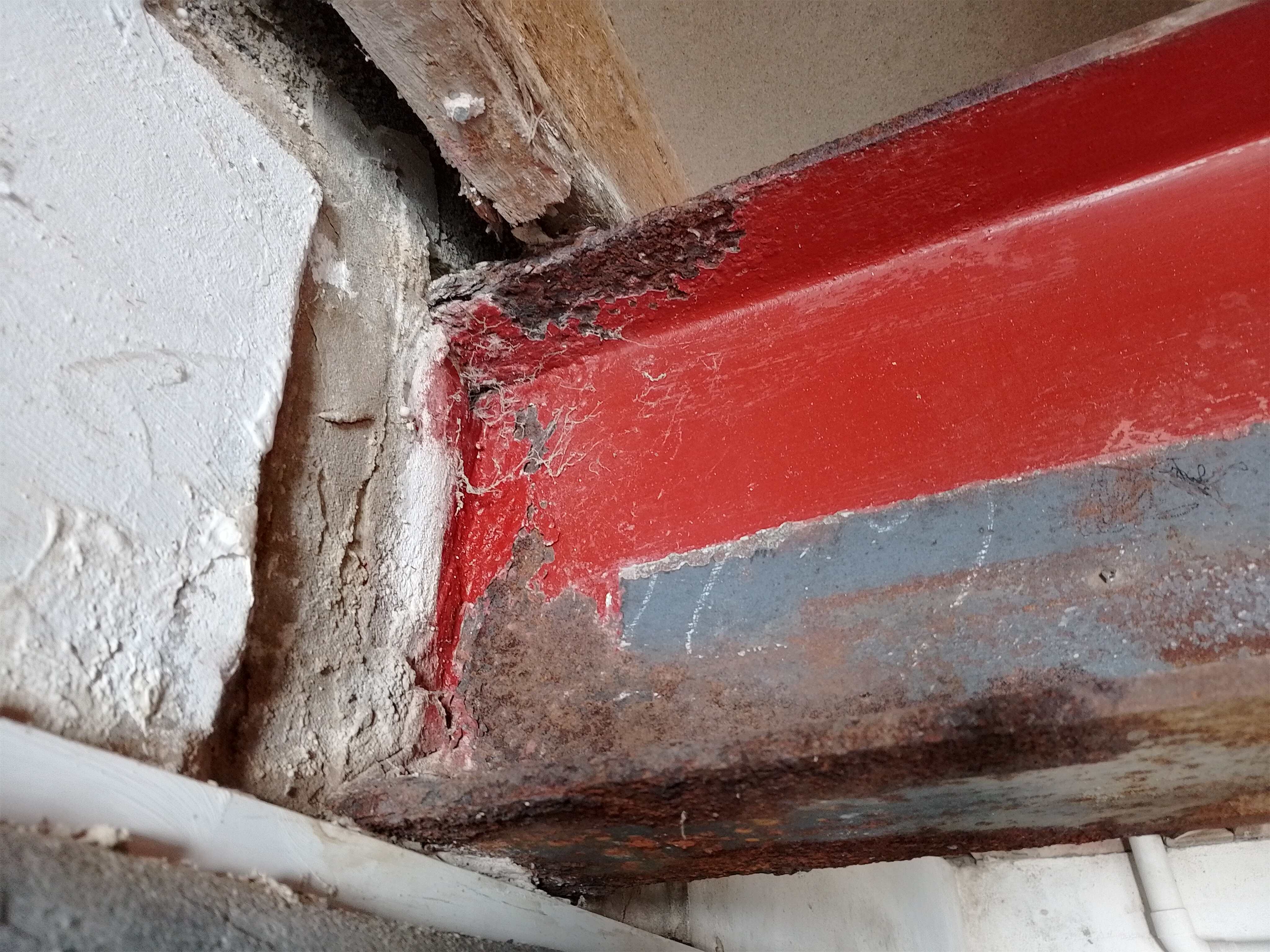

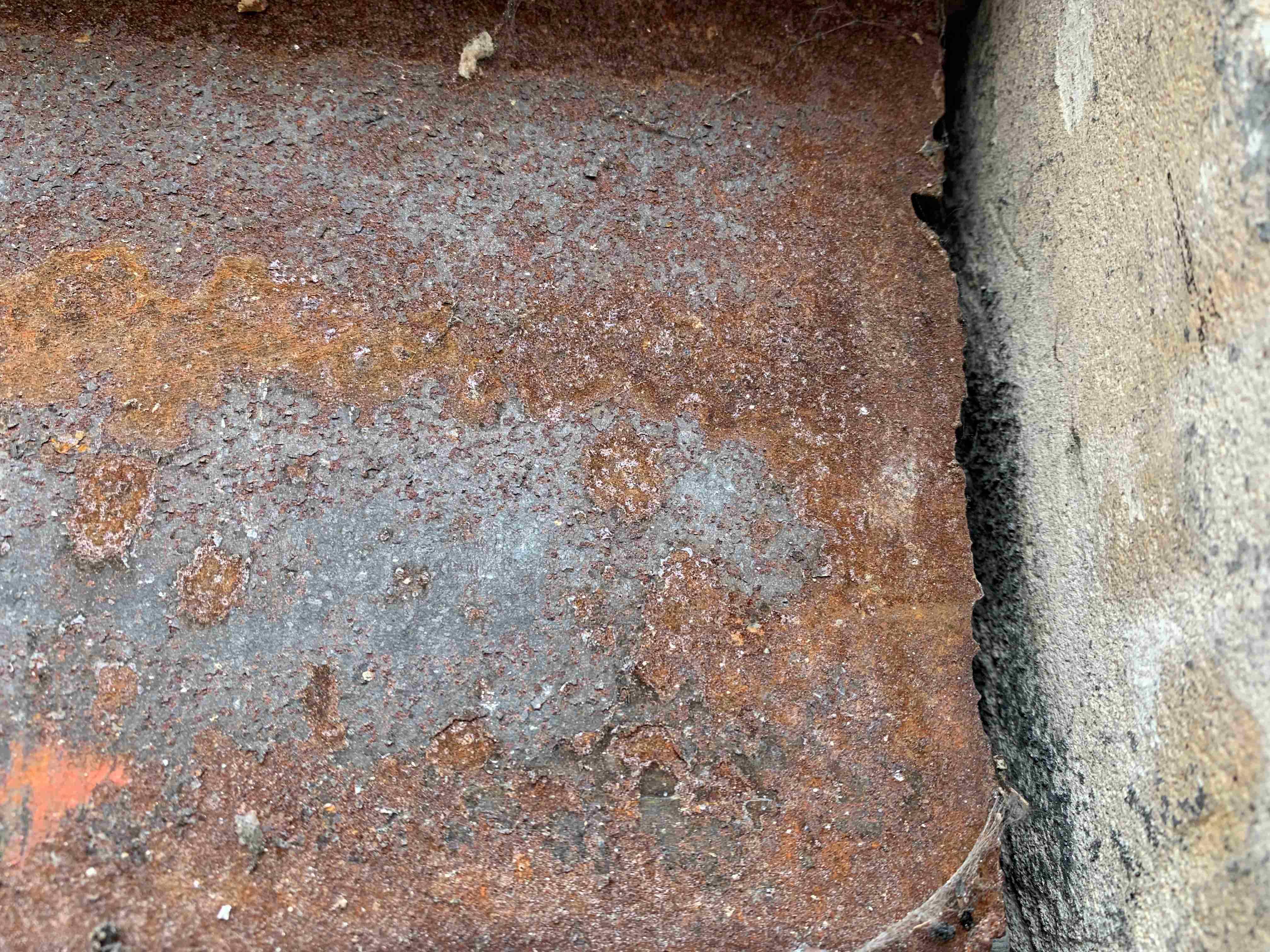

WiltshirePaul Posted 2 hours ago Author Posted 2 hours ago (edited) here's some better images as close ups. This is the worse one Edited 2 hours ago by WiltshirePaul adjust image

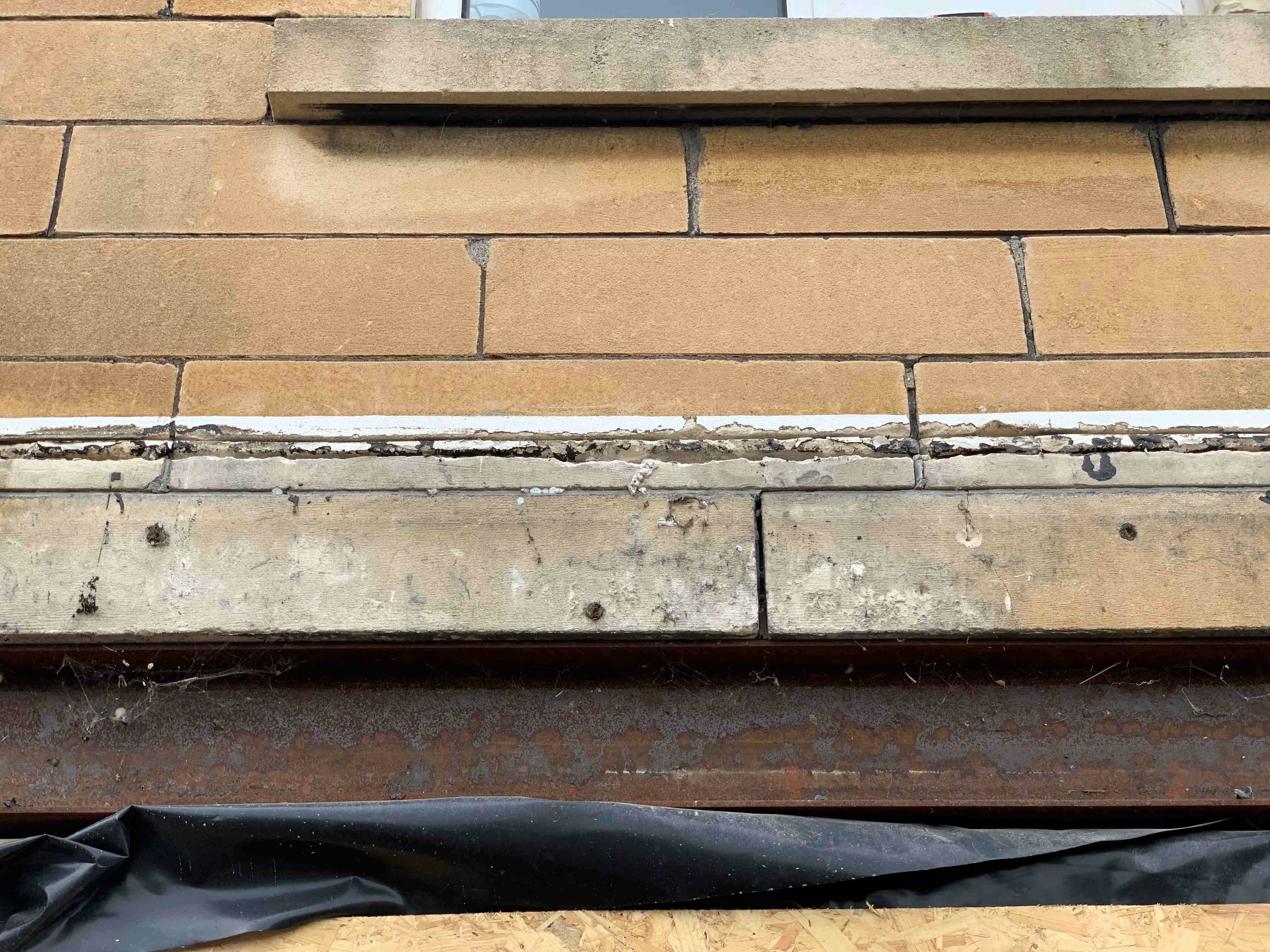

Spinny Posted 59 minutes ago Posted 59 minutes ago (edited) When you say 'old boy surveying engineer' do you mean a qualified professional structural engineer with professional insurance providing a paid for written SE report to you as customer ? Why exactly do you believe something has to be done with the steels ? Do you have any movement or cracking anywhere around the house and garage ? Is it just your personal concern over the appearance of rust and concern to do the right thing for the next 50 plus years ? Rust on steels is common. We had a much smaller pair of steels exposed during our extension work that had been in place since the 1980's and had plenty of rust (see photo). I asked our structural engineer whether they should be replaced or anything. He came and poked them hard with a screw driver looking for anything more than surface type rusting then said they were good for at least another 50 years. So I wire brushed as much rust off as possible by hand and using drill attachment, then used Neutrarust 661 liberally, then 2-3 coats of an iron oxide paint. See Pics. Not saying your situation is the same, but before embarking on costly structural works - presumably to make sure the house is fit for the next 50 plus years - you really want to base it on proper written professional advice. I am sure your house insurer would expect the same. (PS I am not a builder, engineer, etc, just joe public) Edited 58 minutes ago by Spinny
markc Posted 20 minutes ago Posted 20 minutes ago Cutting the beams is drastic and not straight forward. First I would be investigating where the water is coming from, looks like the gap around the bean has been filled with mortar - if this is bridging the cavity then you could be pulling water from outer leaf onto the beam which should only be sitting on inner leaf. Maybe the water is coming from above … leaking pipe / drain etc. more investigation …. Less cutting!
