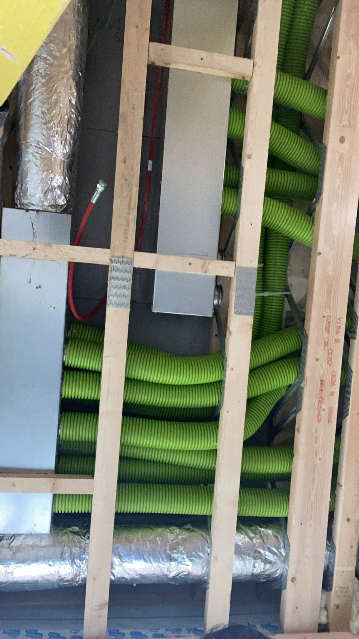

April 9Apr 9 On most of my M&E projects we have posi joists, and a huge amount of stuff can be hidden away in the build fabric if you pre-plan (earlier the better obvs). On (another) one, where the architect was as much use as a porthole on a submarine, I was left to retrospectively solve the issue of getting all the MVHR and plant kit etc installed, after the frame had gone into production. We squeezed the manifolds (bespoke) into the posi voids and got a lot of that up and out of the (tiny) plant room. Good outcome, just needed someone with a problem-solving background and attitude, and we got it done. Was bloody tight, see pic of the utility ceiling void:
April 9Apr 9 14 minutes ago, Nickfromwales said: huge amount of stuff can be hidden away in the build fabric if you pre-plan (earlier the better obvs). That is what Danwood do. They provide live real time drawings for the customer to locate electrical outlets for instance (whilst showing the impact on the original budget for all those extras you want). Sanitaryware gets planned, there's a lot of involvement at the planning stage until it gets frozen and sent to the factory. Then when panels arrive on site they have conduits and outlet boxes already fitted, waste pipes and hot and cold supplies installed etc. So when the kit arrives on site all the ductwork routes are known and there is no need for the odd additional holes here and there. Years of refining the product means many faults have been designed out, there is no mastic around windows as that fails so a hidden seal joins the window frame to the structural frame. Internal window sills are not timber or MDF but a quartz like material. These are the advantages of factory build over a one off job in the mud. Granted it means a lot of wild architectural ideas can't be realised but I would suggest there is still a lot more flexibility in layout/design than you'll get from a major housebuilder.
