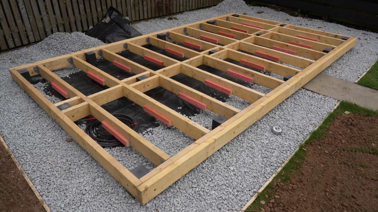

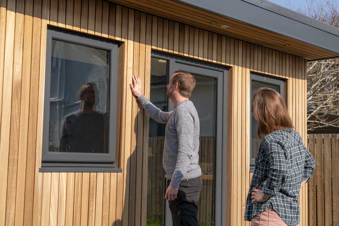

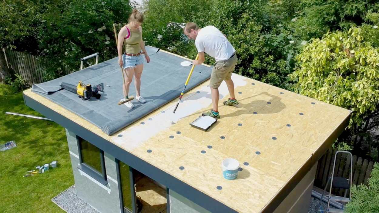

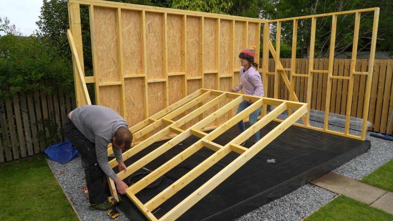

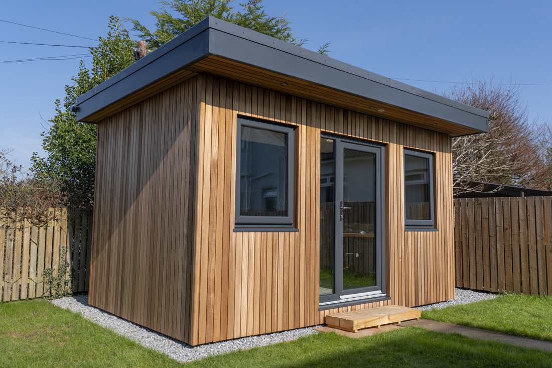

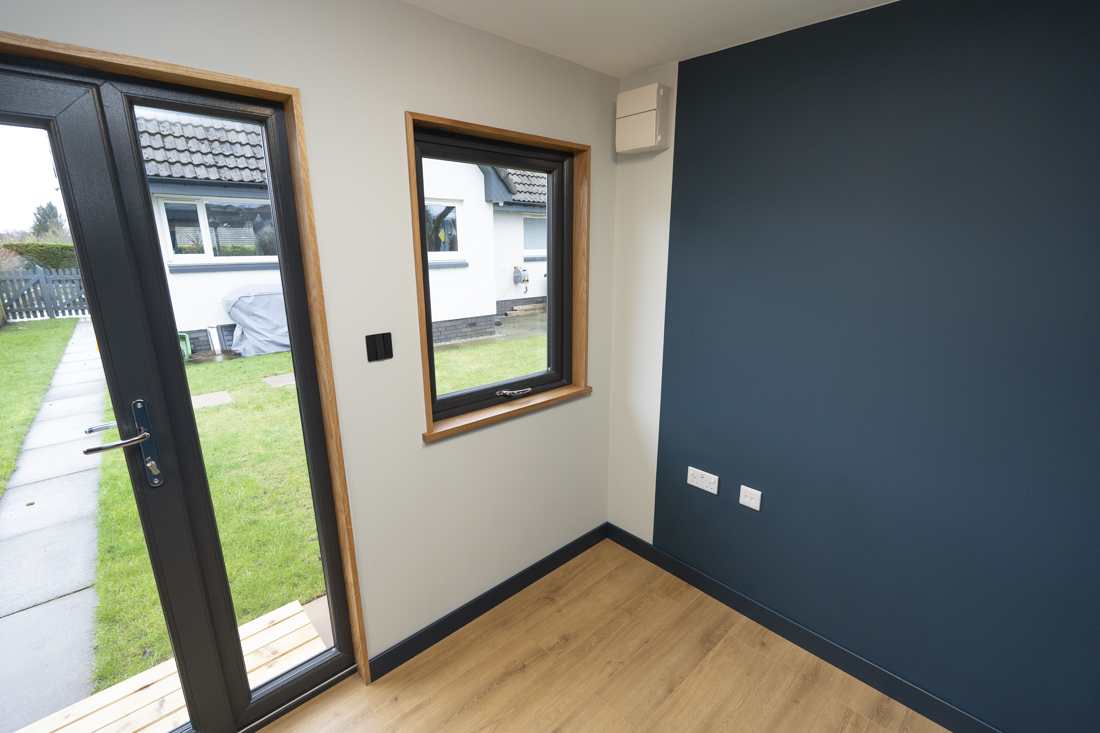

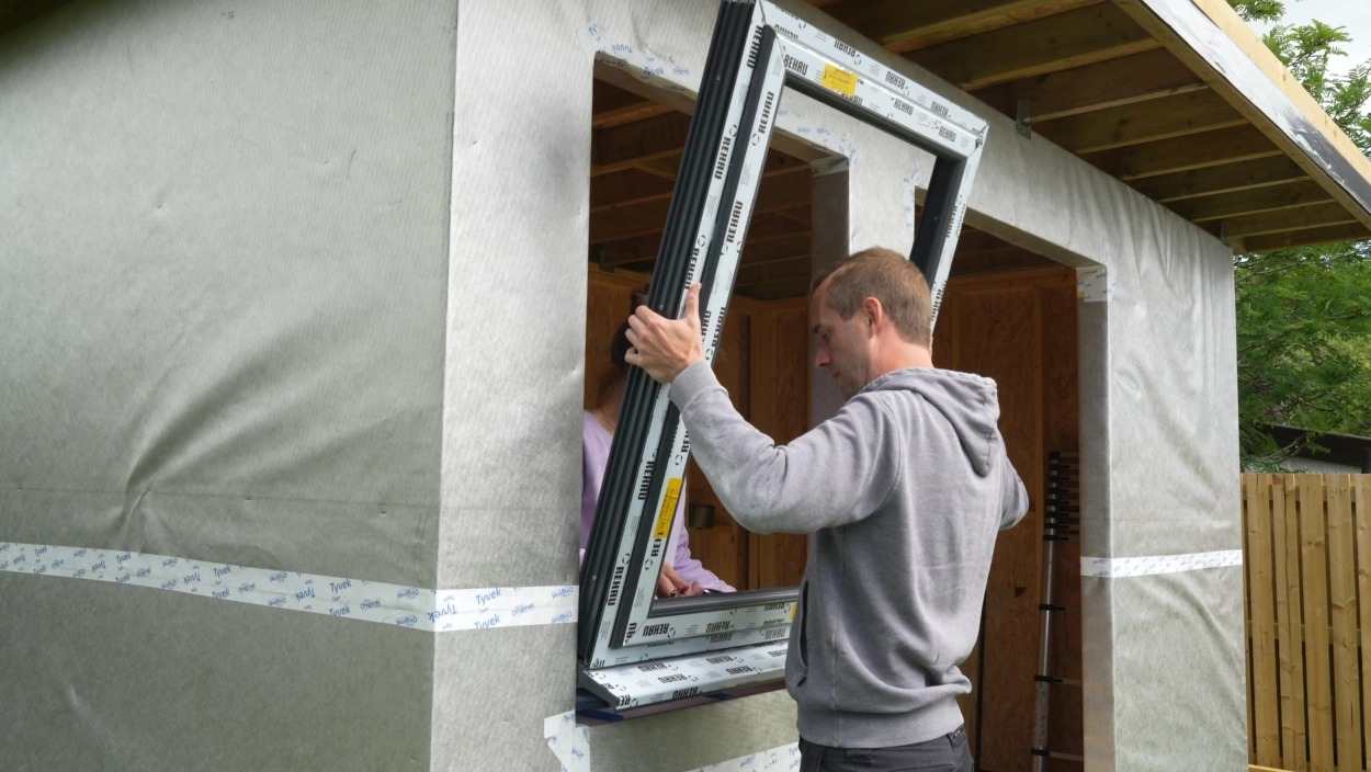

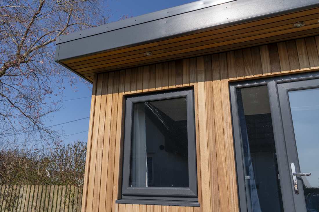

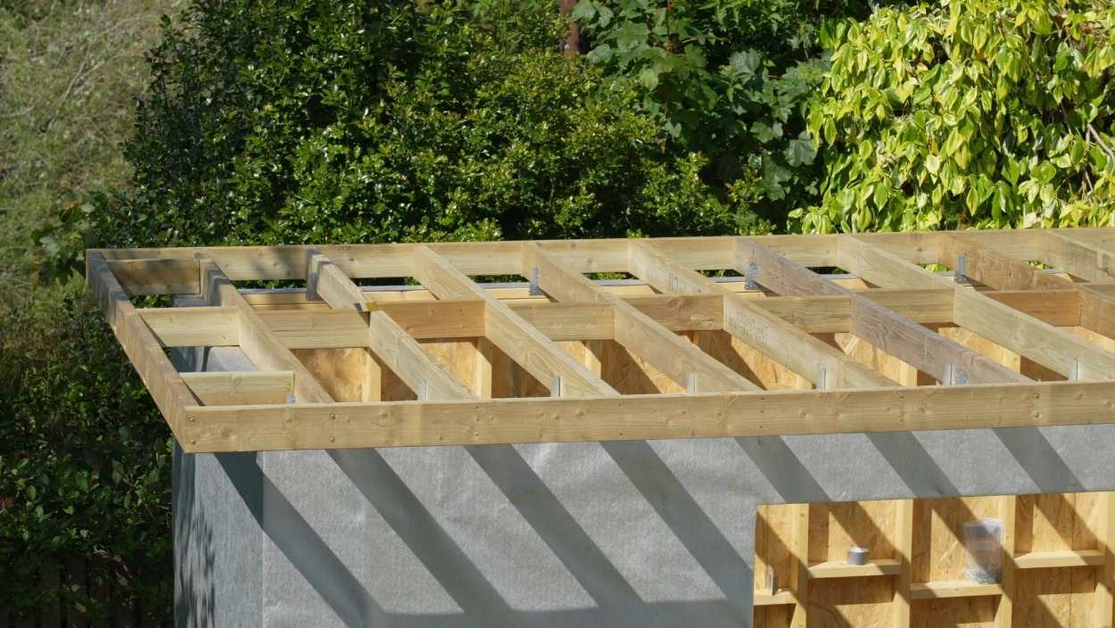

Hi all, thought I’d share our garden room build now that it’s finished.
It was a proper self-build from start to finish, including the design, and we put a lot of time into researching the best way to approach it before we began. We tried to follow good building practice wherever possible, while still keeping it realistic for a garden room build.
I’ve attached a few pictures in case they’re useful to anyone planning something similar.
We also filmed the whole process and put it together as a YouTube playlist, documenting the reasoning behind the different decisions we made along the way. We found that especially helpful when researching, as there’s a lot of advice out there and not all of it is equally useful.
It’s been a really rewarding project, and I’m proud of what we’ve managed to build as a DIYer with a bit of planning and the right approach. I’m looking forward to using it as an office for many years to come.
Would be great to hear what others have done too.

Posted
Thanks...
Sounds like you are in a very similar position to me. I built mine mostly on my own, though my wife did help from time to time on the days the kids were in nursery. I won't lie though, there are a handful of jobs where two people isn't really optional.
I started planning with research, I watched a lot of YouTube videos and read a lot of forums. I also purchased various sets of plans online, but a warning there, don't go too cheap with your purchases, the cheap ones are next to useless and sometimes offer some pretty shady advice. Then I started designing it in 3D modelling software (I am a design engineer, so this was the natural next step for me).
In terms of costs, I spent about £8k for a Garden Room that's 10m2, the equivalent purchased from a company would be around £25k (not kidding) and the quality would have been overall less.

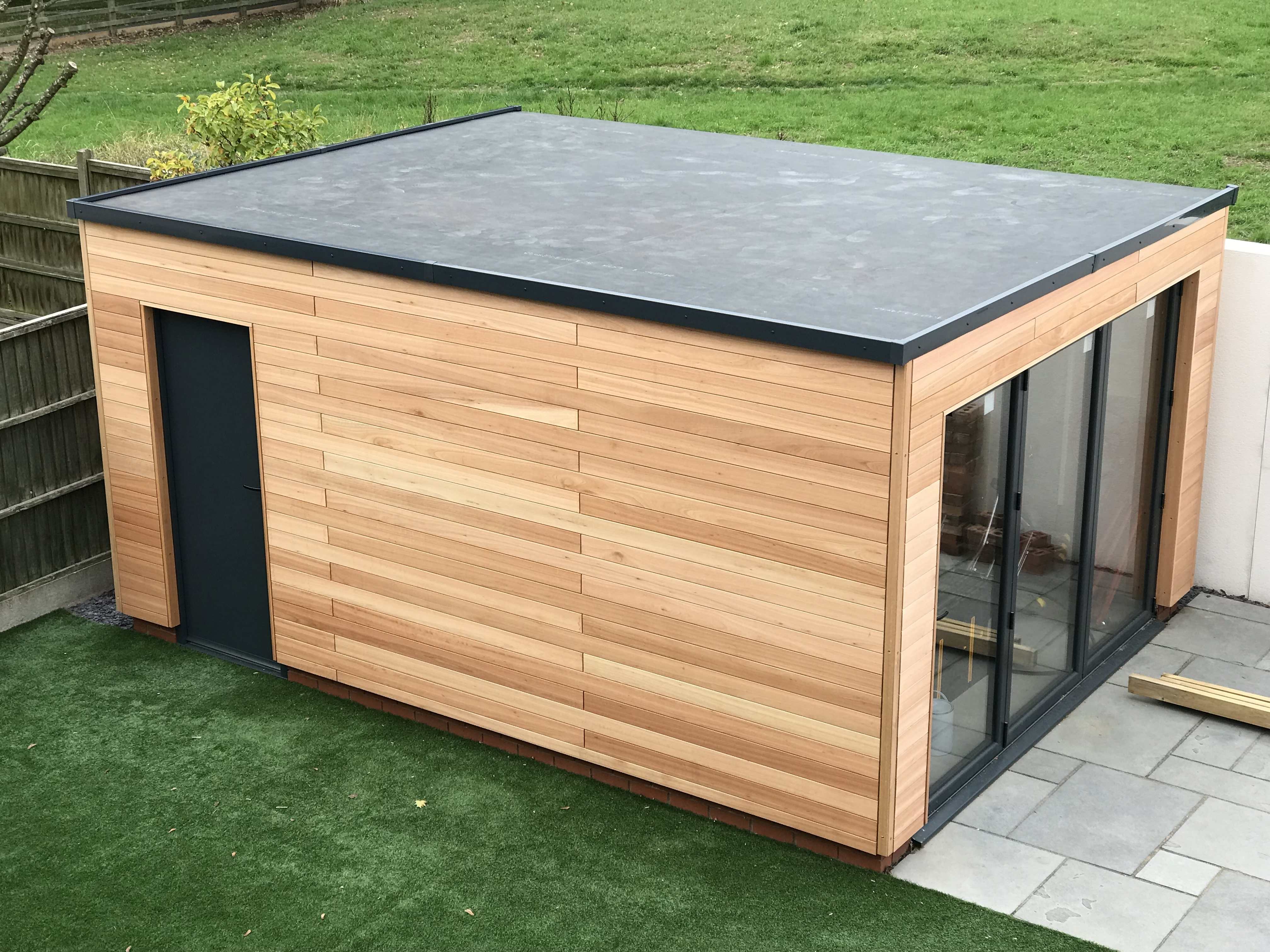

Posted
You can definitely do it alone @Andeh assuming you have the skills, but you will also need a helper at various points for help with lifting, holding, etc. I built a 3.6m x 4.8m (external, excluding cladding) garden room with a garden store in 2018 with help from my wife. We kept the internal floor area under 15m2 as we were building close to the boundary, and the eaves height below 2.5m for the same reason. Hence no planning permission or building regulations requirement. It cost just over £12K at that time, but that included absolutely everything, including the 3m bifolds, all internal finishing and various sundry tools I bought to make it easier to build. It didn't include the cost of the insulated concrete base and the dwarf wall, as those costs were included in the garden design and landscaping bill.
