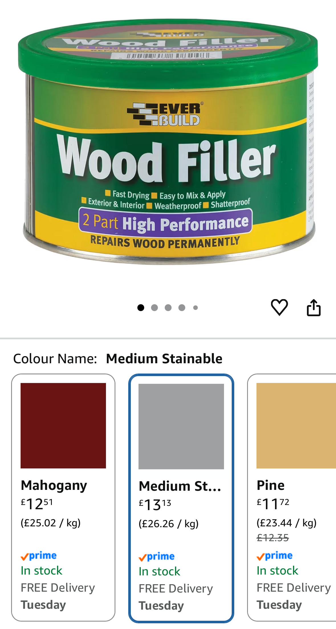

What do you recommend for external wood filler?  Weatherboard, mostly ancient,  where knots have pinged out, some boards where becoming porous on the surface (or chewed by wasps perhaps,) and some badly holed or split feature blocks. That may be 2 different products required according to the hole sizes.
I've used Ronseal and really don't like it for handling or for the ability to smooth or shape it.

I’d use something 2-part, but in honesty I’ve not done much exterior filling.
Scarfing new wood in is the no.1 best way to do wood repairs though.

When I followed your link I saw that Toupret do a big range of  external products,
I will look into this powder one for the smaller work and maybe a resin one for big gaps.
https://www.toupret.co.uk/professional-filler/product/wood-surfaces/wood-repair-filler-white
https://www.screwfix.com/p/toupret-wood-repair-filler-natural-wood-1kg/224HE?tc=JS7&gclsrc=aw.ds&gad_source=1&gad_campaignid=895557794&gbraid=0AAAAAD8IdPyUeZdKJb4fWJQyzVOYn2BPQ&gclid=Cj0KCQjwkMjOBhC5ARIsADIdb3eeVmP0gJAcT6hADzZZVxvyI8Zn5Qvb7FE9IJQidD9BaJTrhiBXTDsaAhMGEALw_wcB
