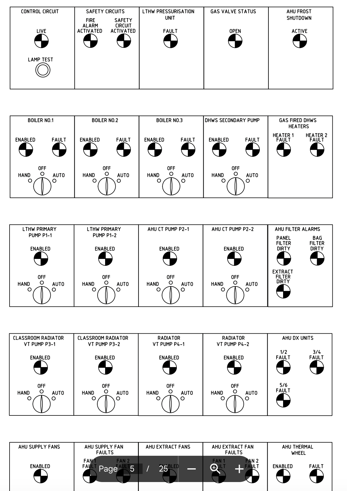

I'm now working on a community project - ~900m2 over 2.5 floors of shared communal space.
The MEP guys are advising we need a BMS panel. I don't get it. He shared me the below as an example of the kind of thing we're talking about.
Is he right ? Is this the modern way to approach things ? Please guide me ! Thank you in advance !

Only looking at the proposed panel, I see nothing on there that necessarily requires a BMS system with complicated setup. Just hard wires into the various systems.
Does he want this wired up to a BMS controller that then has interfaces with all these systems or is he just proposing a panel where you can see the status of everything at a glance.
Doesn't look like there is anything complex going on, so keeping it simple with some hard wired indicators and switches and no computers involved seems like the obvious answer. (If you need a simple PLC for sequencing relays then sure but can't see why you need a full BMS which will a likely 5 digit number to your costs).

This was just an example of a previous job the MEP designer shared.
He was saying there needs to be a control system for the ventilation, AC, Heating, openable windows, etc, e.g:
- Interlock to prevent AC and heating operating at same time
- Interlock to disable AC and ventilation when windows are open
- Possibly some automatic opening of windows when Fire Alarm triggers
etc
Does that make sense ?

Doesn't sound crazy. (I'm not expert, I've been involved in precisely 1 BMS system and was mostly hands off and not impressed with the final result).
The above can all be done with relays (and a timer) so don't necessarily need a computerised control. Worst case a PLC with the ladder logic printed out and stored in the cabinet so it can be replaced if it breaks.
Having said that if opening windows if the fire alarm goes off is a requirement for fire safety you may well get into a much more regulated area with the need for certified systems, battery backups, regular maintenance, etc. The other points seem trivial to do.
I would stay away from anything more heavily computerised if you can. You'll just be paying an endless series of extra bills. Every bit of equipment you buy will likely cost more up front and then you'll be paying specialists to configure and maintain them, etc.
