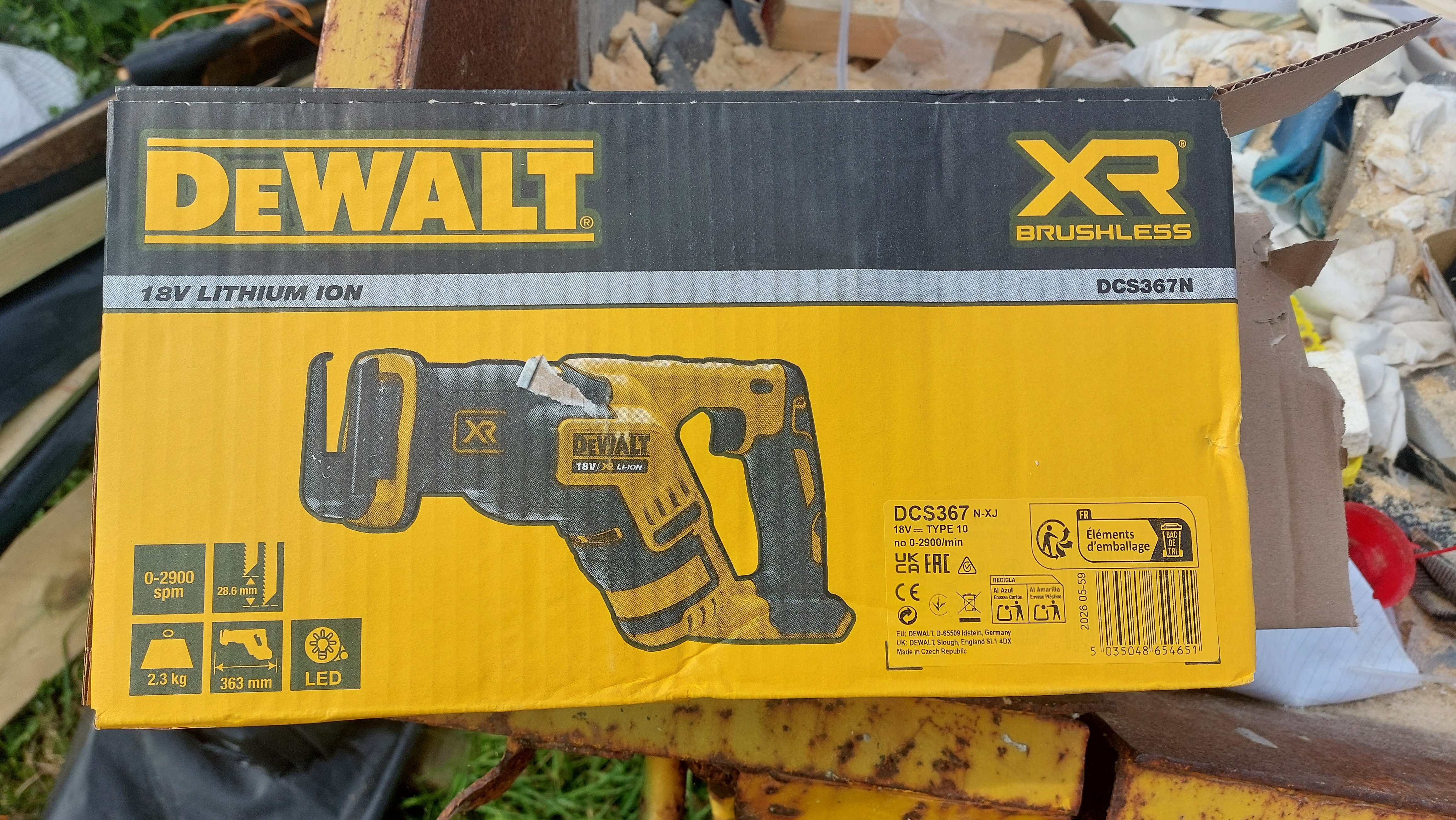

saveasteading Posted Monday at 11:14 Posted Monday at 11:14 We've got professionals in today. 2 guys expect to do 300m2 of dpm and eps today, then tomorrow pir 2nd layer and dpm. Day 3 pipes. They started cutting the eps with a hand saw. I guess this suffices for a smaller house. But one has popped out and come back with one of these and a 150mm blade. Watching him use it he can do curves and angles that a hand saw can't, plus very much quicker. I was surprised he didn't have one already. There is no sign of a table saw, or circular saw, for long straight cuts. That's what I had expected. The cutting dust is hand- brushed into the gaps. More to follow. 2

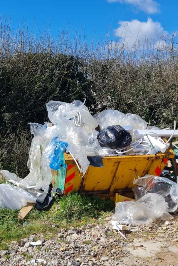

saveasteading Posted 3 hours ago Author Posted 3 hours ago 5 hours ago, Mr Punter said: tripods to set the levels. That's what I expected. But this was less technical. They broke a slat from a pallet and marked 40mm and 50mm on it.. min and max depth. That seemed to work as there was about 1/4 m3 waste. But as for waste. I was optimistic that there wouldn't be much insulation wastage and that was the case. I didn't deduct for stud wall areas, did add 2 sheets for mistakes or lack of care, and had 3 sheets surplus. It will ho in walls. BUT what cutting waste there is, is very bulky, perhaps 5 x by volume, maybe more. And the packaging waste is dreadful too, with cardboard snd cling wrap and eps spacers. Moral... allow a skip cost simply for the insulation and ufh. Being petty and mean... (cost conscious and efficient) I found that the cling wrapping compresses dramatically when rolled up and squeezed into bags. Ie I took it out of the skip and compressed it. Pipe offcuts take lots of space too. And the eps packing baulks look useful so are set aside. Saved £150 or more in an hour.... I care much more than they do. Stop press.... I'm told pir will rise in price by 10% then another 18%. So I guess eps and plastic pipes will do too.
