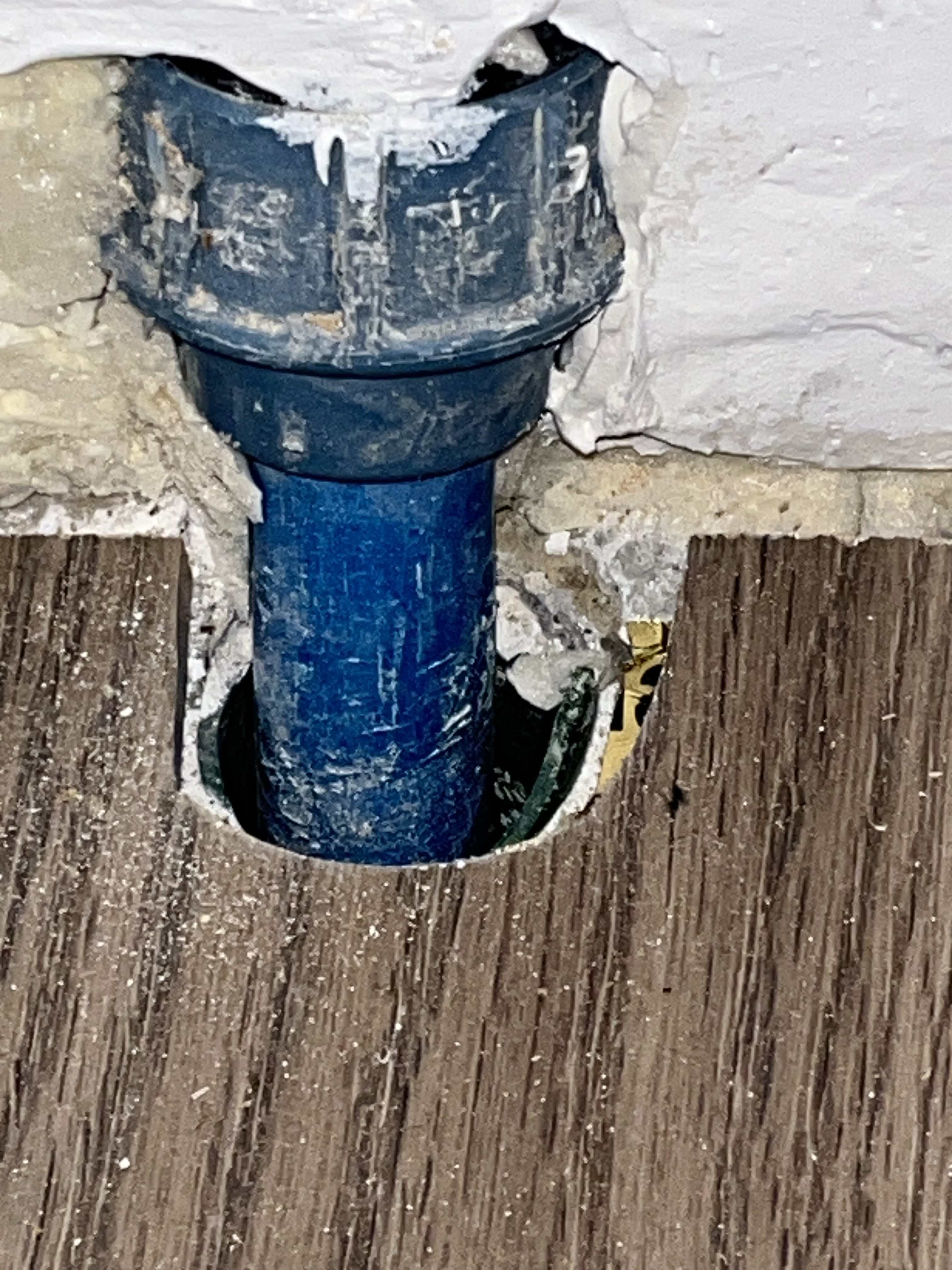

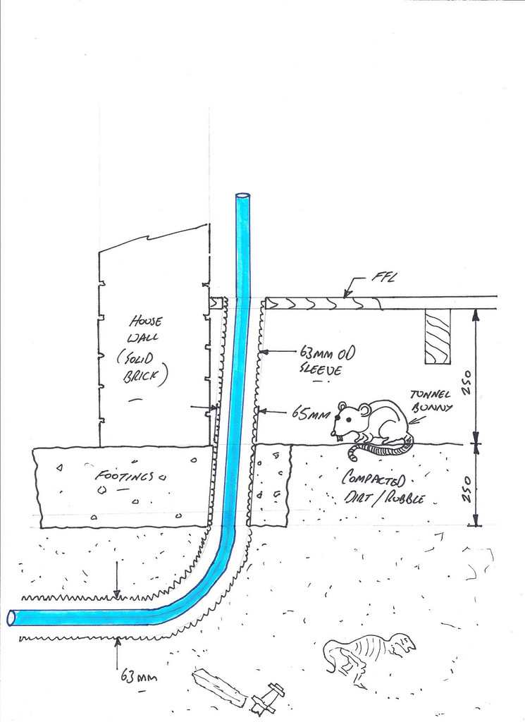

Alwayslearning22 Posted 6 hours ago Posted 6 hours ago What is the proper way to seal this opening through floor? Garden is infested with rats I’m worried they might end up coming through this pipe. thanks
JohnMo Posted 6 hours ago Posted 6 hours ago I would and did, stainless mesh screwed up and stuffed in, and the spray foamed it all together. Next get bait traps with this in there https://amzn.eu/d/0fyW3NPc It's a one time eat and their dead.
