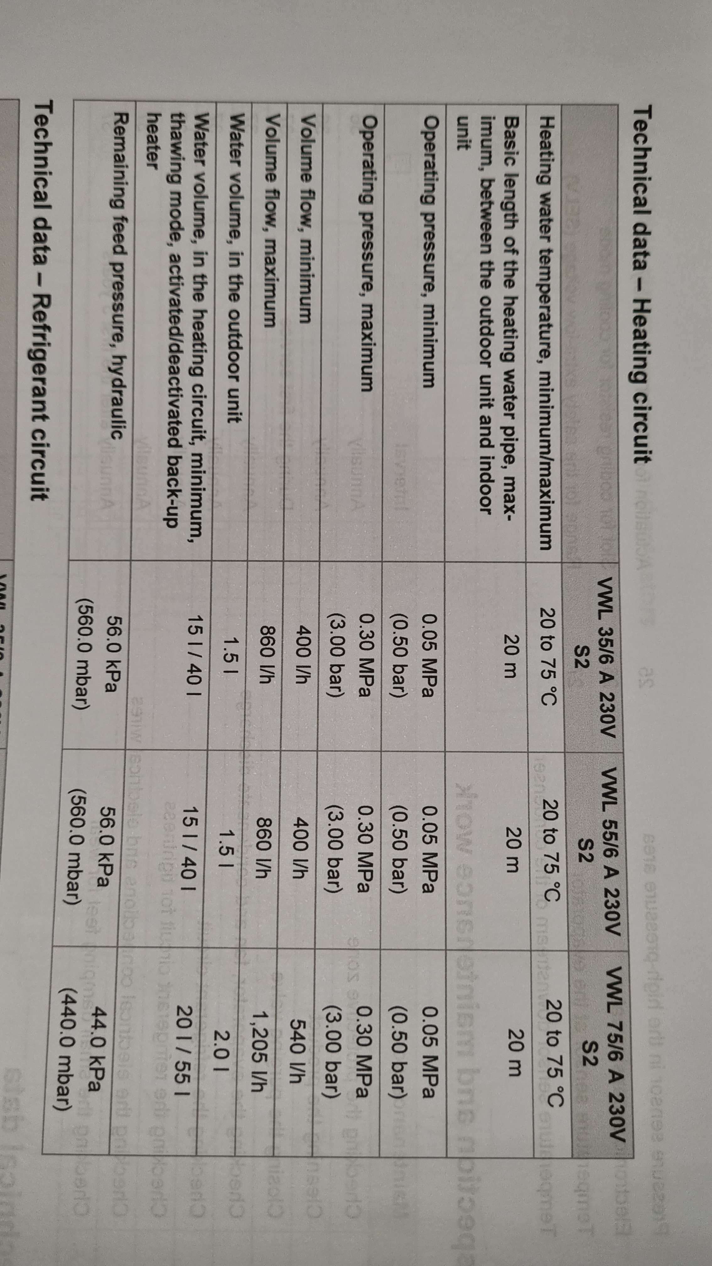

BotusBuild Posted 13 hours ago Posted 13 hours ago I'm looking to remove or bypass the fitted buffer tank in our heating circuit, removing the "extra circuit pump" at the same time. Will the heating pump fitted in the outdoor unit will be capable of circulating the water through the heating and DHW? The buffer tank is 50 litres. The UFH pipes have a volume approximately 100 - 110 litres. Info from docs: The heating pump in the outdoor unit consumes 2 to 50W.
SimonD Posted 13 hours ago Posted 13 hours ago So what we need to know is which exact model do you have - what is its power output? Do you know the index circuit pressure loss for your heating system? And what is the property heat load?
BotusBuild Posted 11 hours ago Author Posted 11 hours ago @SimonD 🙂 I tagged it. Its a VWL 75/6. I don't know the index circuit pressure loss. That's a new term for me. Should it be documented somewhere? Possibly called something else? The worst monthh for heat loss for the property is 3246W daily heat loss power for mean min OAT (as calculated using JHarris spreadsheet)

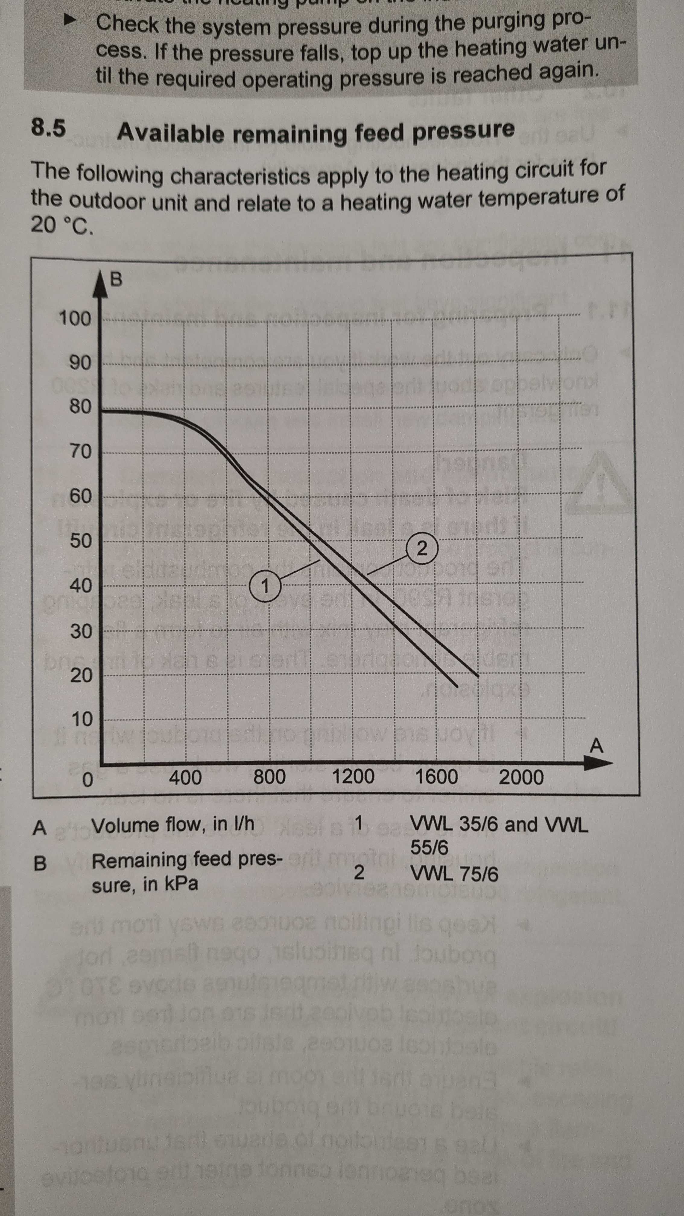

SimonD Posted 10 hours ago Posted 10 hours ago 1 hour ago, BotusBuild said: I don't know the index circuit pressure loss. This is critical. Your index circuit basically means the sum of the sections of your heating system that adds up to the greatest pressure loss. For every meter that your heating water flows through a pipe is loses pressure. To know whether the pump can deal with this, we need to know the maximum pressure it has to overcome and at what flow rate. If you look at your specification chart, you have a max flow rate of 1205l/h and at this flow rate, if you look at your chart, it gives a residual head of just over 4m head. To know if the pump will be okay with this, you need to know if the circuit that has the greatest pressure loss is less than 4m head. Do you have a circuit diagram or do you know how your heating system is plumbed?

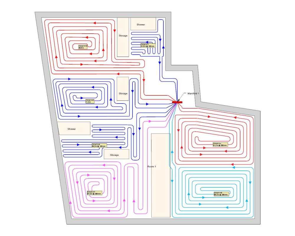

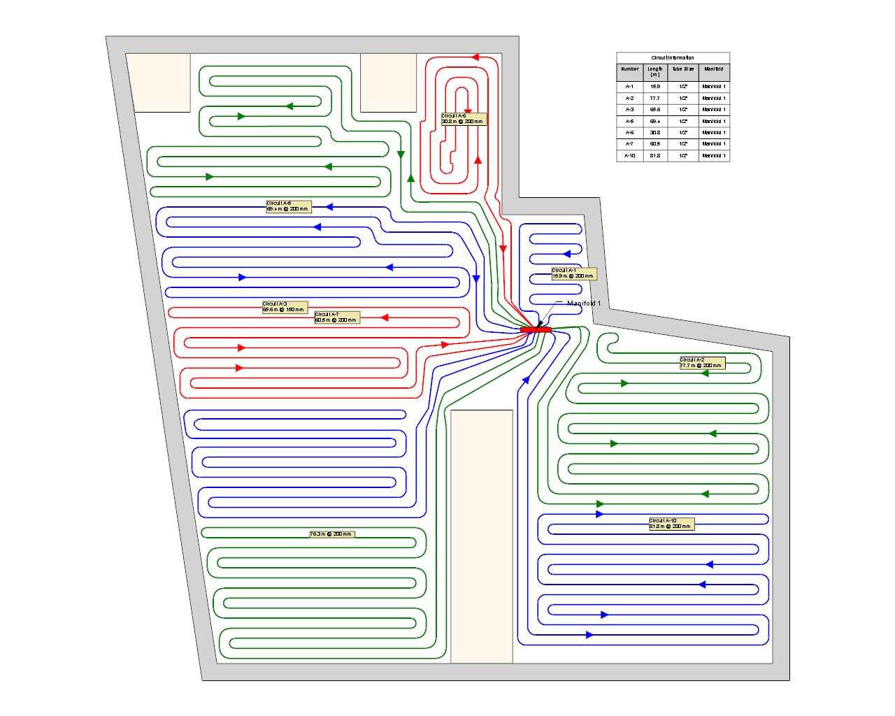

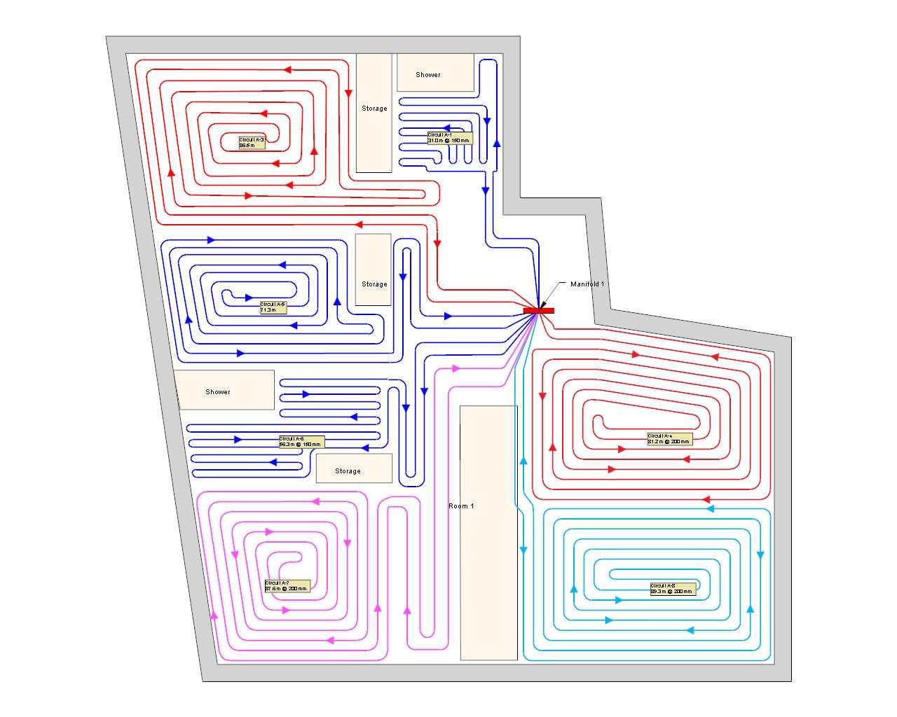

BotusBuild Posted 9 hours ago Author Posted 9 hours ago Two storey building. Outdoor unit is level with the upper floor. We have UFH on both floors. Lower floor has 7 loops to a manifold. Upper floor has 7 loops to a manifold (in the UGF file attached, the small red loop and the small blue loop to the upper right were left out).
JohnMo Posted 8 hours ago Posted 8 hours ago All I can say is they are pretty pictures. But unless both spaces are fully open plan, there is zero design work going on. Pipe sizes is questionable. 1/2" pipe isn't really suitable, you should be using 16mm. Your loop length can be around 100m, so the smaller loops can be deleted and incorporated into other loops if you wanted. For info I am doing 7 loops in total for the same heat load.

BotusBuild Posted 7 hours ago Author Posted 7 hours ago 44 minutes ago, JohnMo said: All I can say is they are pretty pictures. But unless both spaces are fully open plan, there is zero design work going on. Pipe sizes is questionable. 1/2" pipe isn't really suitable, you should be using 16mm. Your loop length can be around 100m, so the smaller loops can be deleted and incorporated into other loops if you wanted. For info I am doing 7 loops in total for the same heat load. Sometimes you comments come across a bit passive aggressive. UGF. Open plan to the left. Large single room to the right. A hall where the small blue loop is shown (but not fitted). A utility and cloakroom where the small read loop is shown (but not fitted). LGF. On the left each loop is a separate room. The 2 large loops to the right are a single room. All pipes are 16mm. No loop longer than 95m as laid.

JohnMo Posted 7 hours ago Posted 7 hours ago 16 minutes ago, BotusBuild said: I know you are trying to be helpful on here. There are perhaps better ways of wording some of things you post. e.g. you could have asked what pipe size I used, and sought a better explanation for the pipe layout (which equally I could have provided a better explanation for up front) I could have asked, but you posted an image that stated 1/2", so would have been a wasted question. But as your using 16mm, all is good. But your loops are really only designed to fit the space, not to match the room heat loss. The loops per room, should be matched to heat loss. Balancing is possible with manipulation of flow rates through each loop, but there is a limited effect, if your circulation pump modulates.
