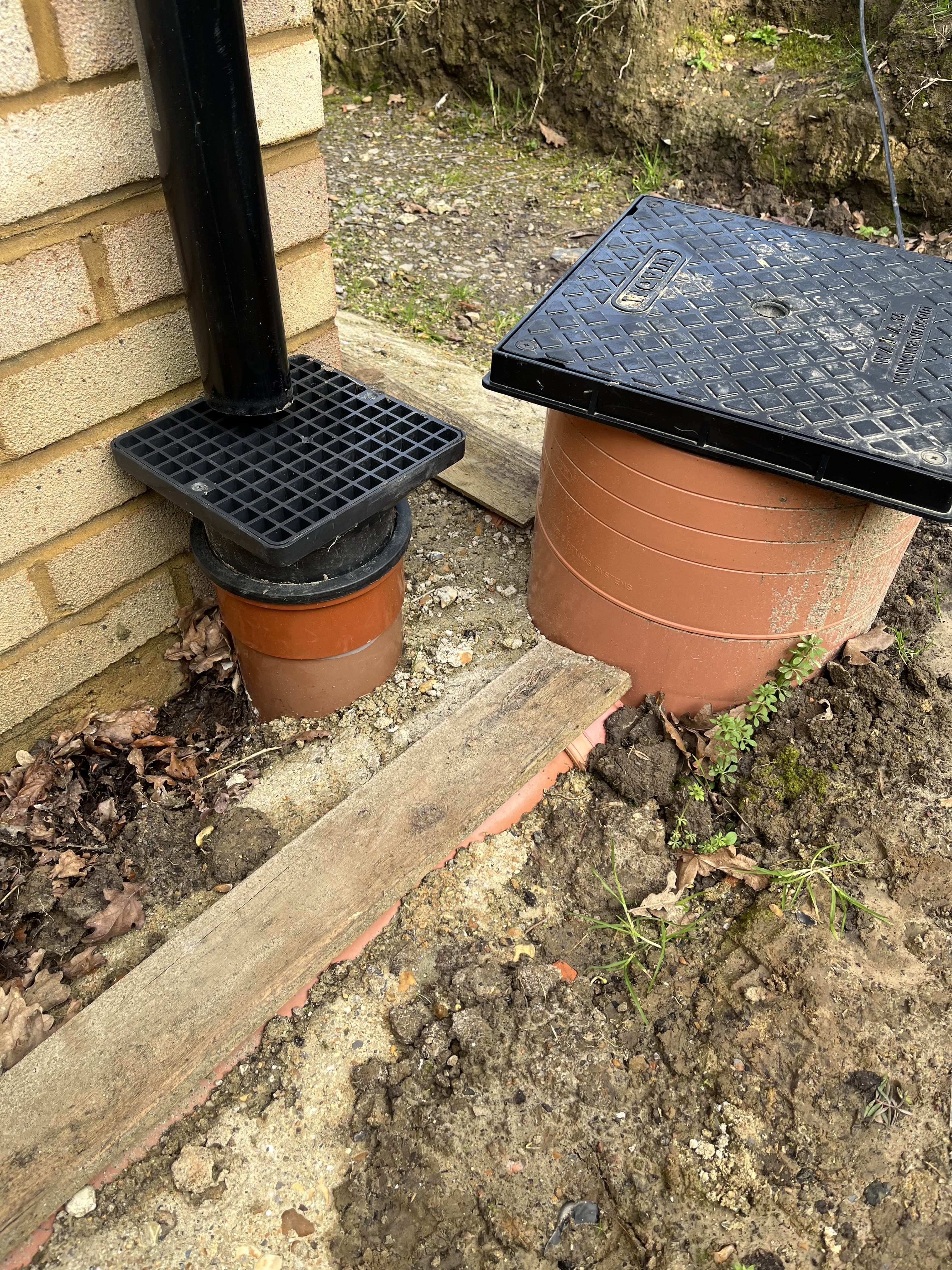

110mm into access chamber when no spare inlets
Following on from the other topic I just posted, it would really help if I could connect to an access chamber (300mm) the same as in the picture (note it's not this one!) There are no spare inlets, can I create one in the riser somehow? Note that this is surface water, not foul. It would be a connection from an aco drain.

Just y off an existing branch
It's an option, but more hard work than connecting directly into the access chamber!
Is it? If you have to start featuring something with the access chamber. Couple of slip collars and a y branch jobs a goodun and its legit.
How can this be true? If there’s no spares then you’ve zero other choice?
Y branch cut in to existing run, a single socket 135° bend into that, and take the branch off to pick up the ACO.
Standard practice tbf, and even if you did this with a foul connection it would still work perfectly well.
That's what I had to do. Had to break out a load of concrete to get access though, which is why I was looking for a short cut. Decided to do it properly though
