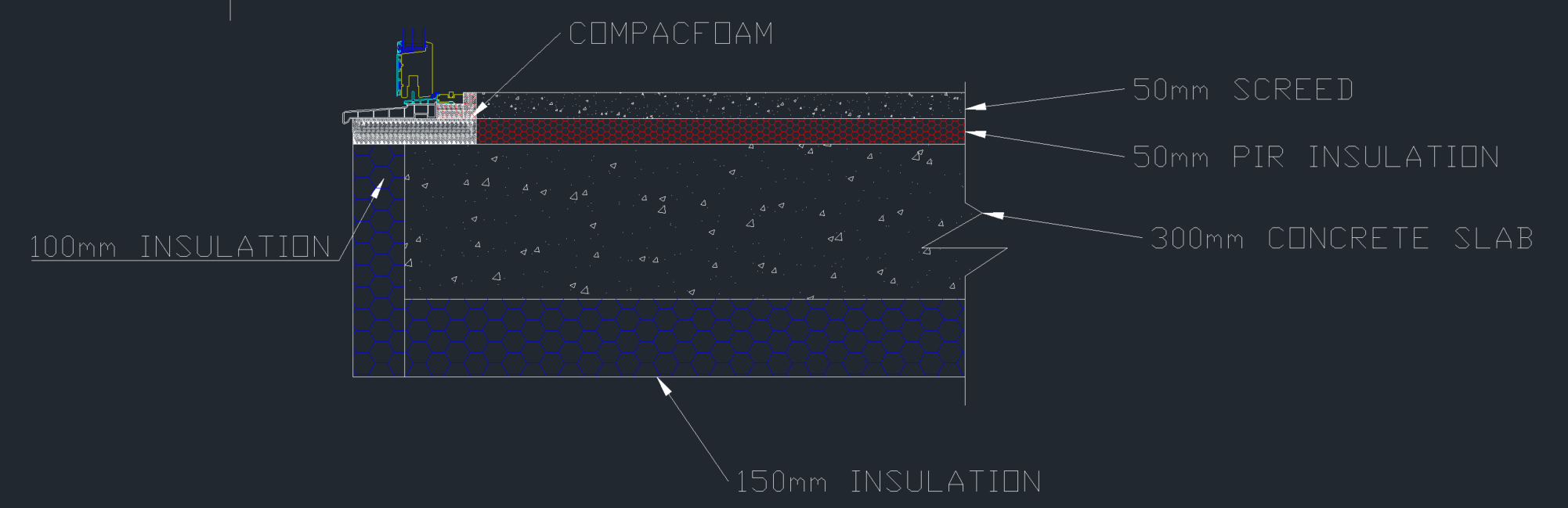

I'm struggling to find a good way of mounting my sliding doors, given I will have 100mm of external wall insulation as the outermost part of my wall buildup:
I think the door track needs to go over the concrete slab, for strength, which leaves me struggling to protect the 100mm of external insulation. An extended sill seams like the best idea, but I can't really find any of these being offered, perhaps i'm not looking in the right places?
As drawn i'm envisaging a wide sill that bridges the concrete to over the insulation, sat on compacfoam for a bit of strength to spread point loads, with the sliding door track set ontop of that. However I can't find suitable sills and i'm not sure if this arrangement would still put undesirable forces through the external insulation, for example when someone steps on the sill.
Are there any other ways that don't introduce big thermal bridges?

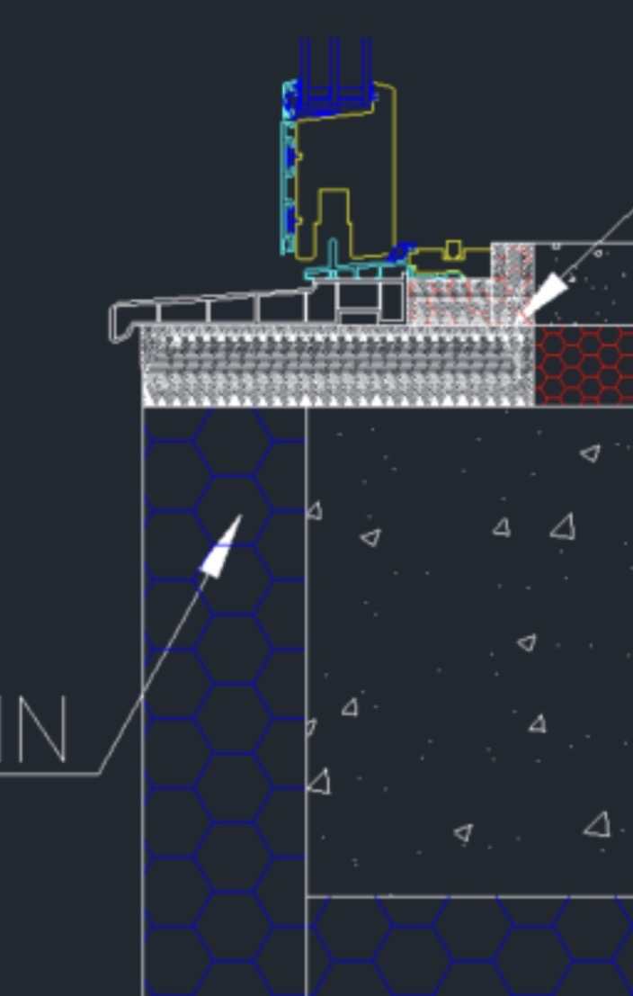

@craig whilst the compacfoam does rest on the EPS and concrete, the track of the sliding door is above only the concrete so the load path will be directly down through the compacfoam Into the concrete, the compacfoam will see no bending and the EPS will see essentially zero load from the slider. I could adjust the compacfoam so it is only on the concrete but I see no advantage to doing thay- the compacfoam should help spread any point loads from the sill. Or at least that's what I'm thinking, maybe I'm wrong?

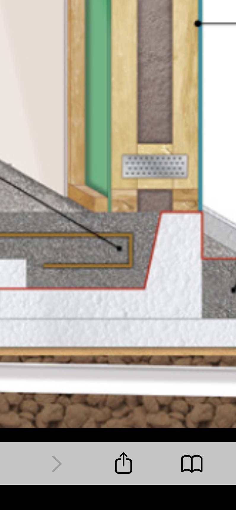

@Nickfromwales is the EPS the frame rests on integral with the slab Insulation? My concern is that mine probably will not be, and therefore may move somewhat Independently of the slab. And then I worry about the DPC, probably because I don't understand the detailing.
@Russdl I'd love to see any more details of the GRP and it's fitting if possible.
That particular one is a KORE raft foundation system, so yes, it's a big 'L'-shaped profile so cannot 'float' or detach. Your detail is perfectly 'doable' with the correct fixings and methodology to keep the insulation in place.
Looking again at your detail, why the 300mm slab design with UFH in screed over just 50mm of insulation? Who's design is this, and what is the rationale for the spec?
It is not finalised, but it is a combination of me and my structural engineer.
The rationale is that it is a walkout basement and the detail between the basement and the timber frame that makes up the top two floors means I can only have 100mm of external insulation on my basement walls (unless I step it out below the plinth, which I don't like the idea of), which is probably not quite enough, so I'm bulking it up a bit with 50mm internal Insulation (it would be enough if it was all basement, but it's not enough for the sections which are above ground- about 50% of the wall area). Under the slab will be 150mm, just because, so there is probably no need for the 50mm internal insulation there except I'd rather thermally isolate the screed a bit more from the concrete slab as the walls will be colder than the floor. Does that make sense? All thoughts appreciated, it seems like the best compromise of quite a few aspects to me but I'm not an expert...
Has that detail been checked by the supplier/manufacturer? As with experience, the fixed pane/sliding section are over the slab but the front section which people will walk on is not. It has resulted in problems with operation in the past and warranties. All I’m doing is giving my experience and knowledge, you may find if issues occur that the warranty is invalid as it has not been installed as per manufacturers recommendations (I recommend that the manufacturer has checked it and confirmed it’s within their recommended details and warrantied).

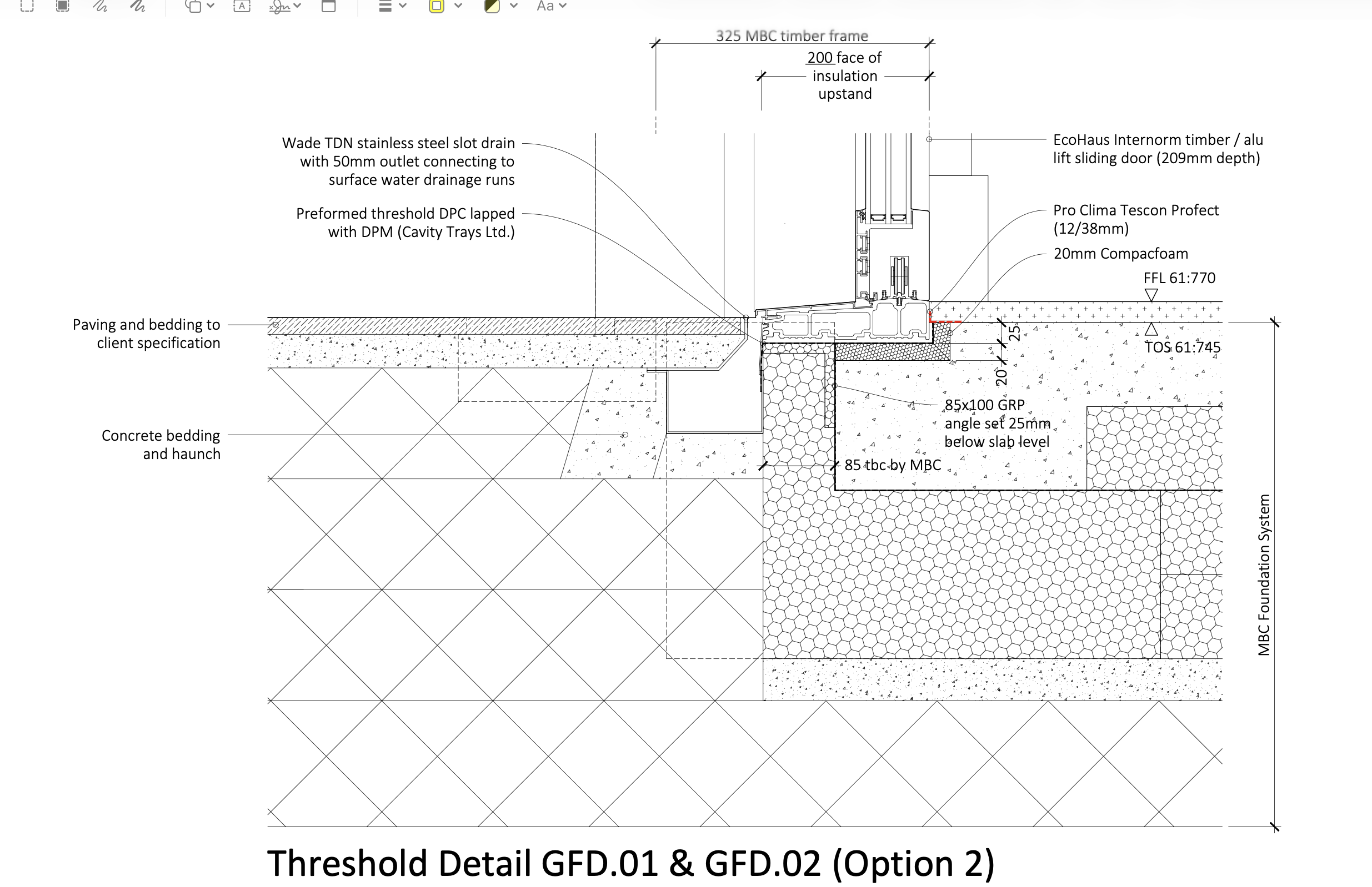

@Ed_ here's our detail with GRP angle supporting the sliding door.
I don’t have any photos of the installation with me, but if you’d like pictures I can upload some when I’m back home at the end of the week.
Edited by Russdl
Thanks @Russdl that is great, it looks like a sensible detail and I'll probably tweak mine to copy it. That GRP angle will hopefully also deal with the issue identified by @craig.
Thanks everyone, really appreciated.
It’s not highlighted in that drawing but the GRP angle was resin bolted to the face of the slab.
Actually, I don’t think it was resin bolted. I can’t quite remember how it was done, I’ll check the photos when I get home.

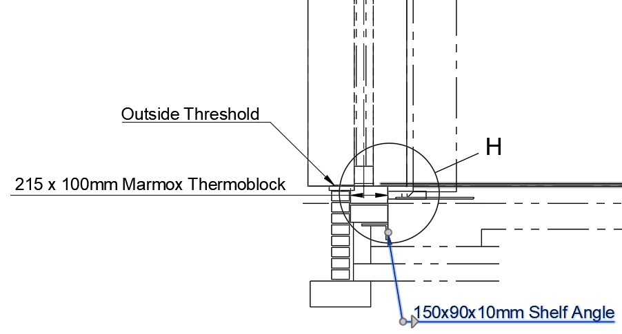

If you don't mind me joining in ... this is my solution atm - I'm not totally happy with it.
That is, steel shelf angle resin anchored to side of slab, mostly buried in XPS insulation, and supporting Marmox Thermoblocks for a mix of thermal & load bearing. The brick plinth is Suffolk-barn stylistic rather than load bearing.
In my case, the door load falls completely off the slab like Nick's example. Any thoughts gratefully received.
Edited by Alan Ambrose
