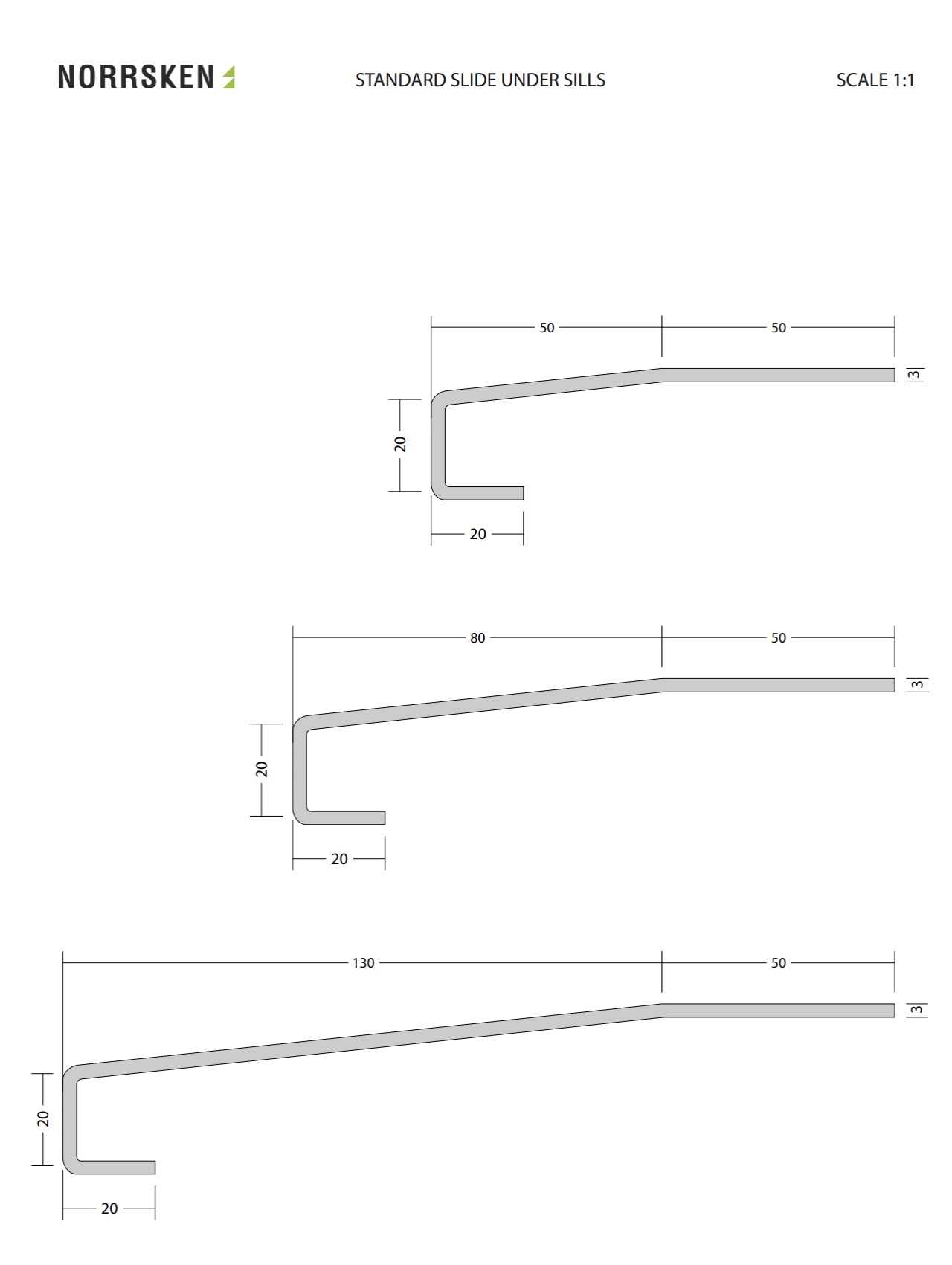

February 25Feb 25 Does anyone have Norrsken French doors or patio doors with a slide under sill? Would you be kind enough to post a photo please? Can’t find one anywhere. Thanks!

February 27Feb 27 Author I’m worried how they might look. I just want a photo of a door to put my mind at rest. I have trouble visualising from line drawings. I’ve found all the window stuff quite stressful. So worried that we might have made mistakes that can’t be corrected 😬 I must have been through the order schedule about 50 times!

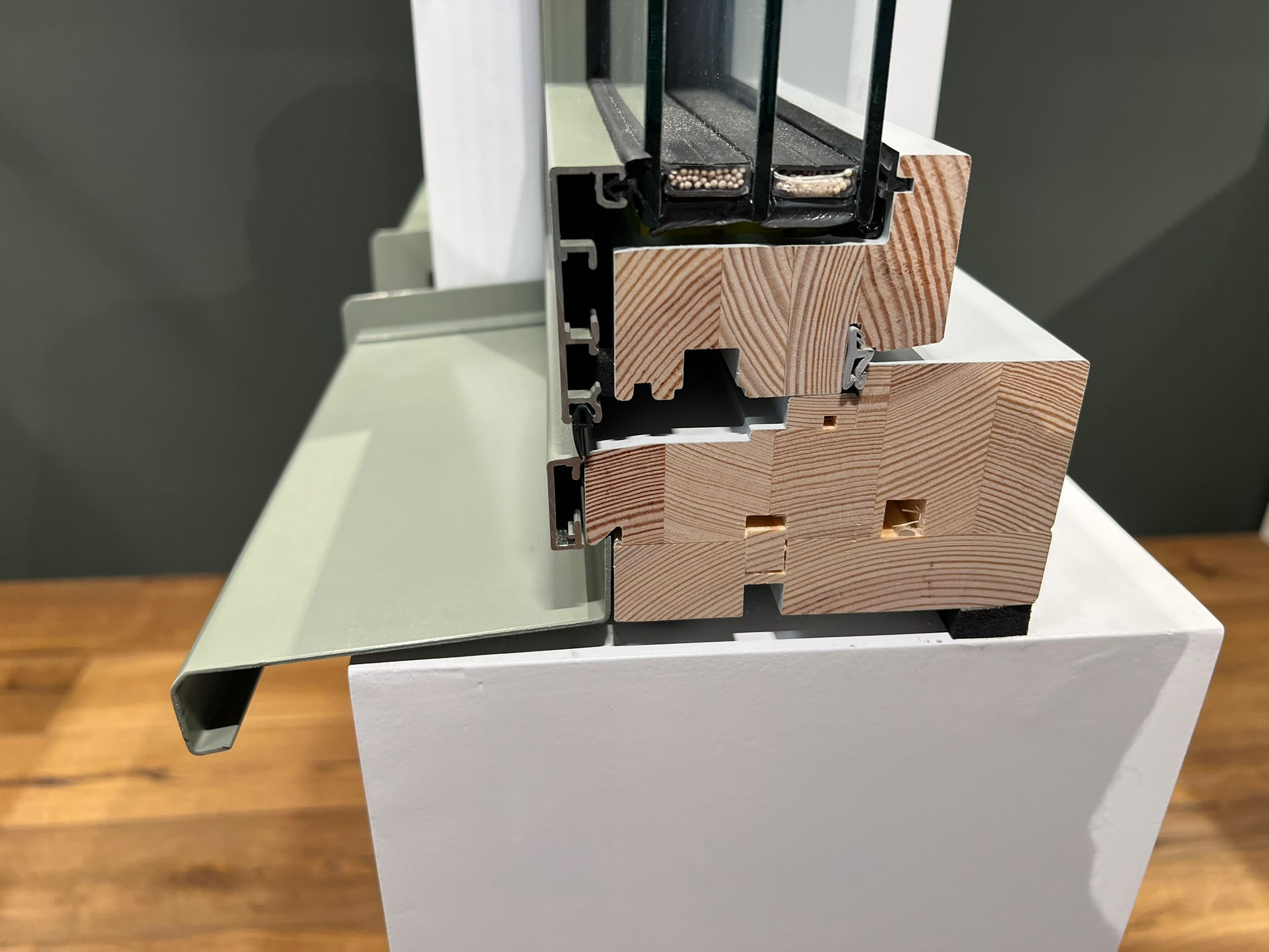

February 27Feb 27 What is your external reveal finish? Brick, render, cladding or a mixture? Cills/Sills are pretty straight forward, minimum 20mm overhang but recommended overhang is 30mm and a max of 50mm. From the known window position count from the front face to the external finish, then add 30mm for the minimum overhang. Then add 16mm from front facing of aluminium, to the face of the timber of the window and an additional 8mm for the rebate in the frame (check this is correct with Norrsken about the 8mm). The rebate will sit back a further 8mm (maybe more, but 8/10mm is standard). Sills are always the same width as the window, unless specifically requested otherwise. Now choose the right end cap, they will likely offer 2, straight up (brick), straight up and over (render/cladding). Make sure they supply the right one. Edited February 27Feb 27 by craig

February 27Feb 27 Author 5 hours ago, craig said: Are you meaning like a tray that sits under the door to prevent water going further back under the threshold of the door, or standard threshold/extended threshold that projects further out? Is it an entrance/side door, lift and slide, French door (inward/outward)? As shown at the beginning of this thread in the line drawings. Outward opening patio & French doors.

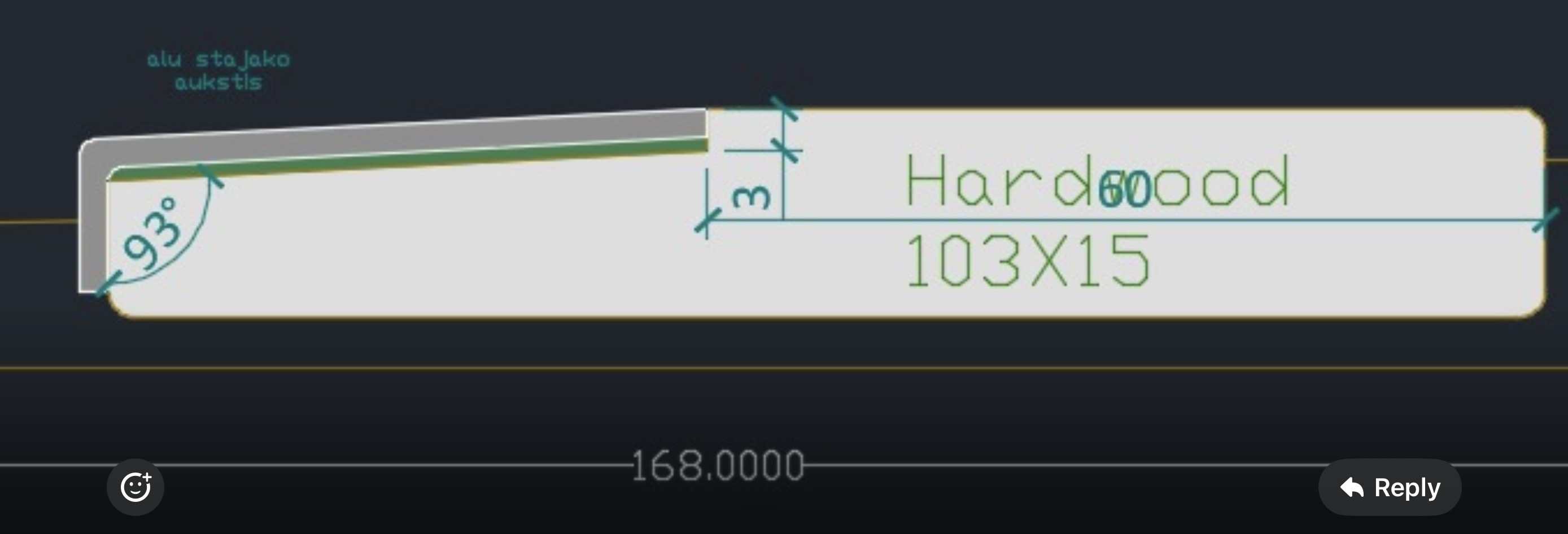

February 28Feb 28 It’s effectively a tray as the threshold doesn’t tend to go all the way out, thresholds are generally the depth of the door frame. something mire substantial would be a 20/30 height timber and wrapped in aluminium. Something like this but you either sit the door on top ir recess the timber to make it as flush as possible. The aluminium can wrap underneath and back if required. Usually you have to have this made. You can ask them to make it for you. Edited February 28Feb 28 by craig
February 28Feb 28 Author The ones illustrated at the beginning of this thread are the ones on our order.
February 28Feb 28 55 minutes ago, Selfbuildsarah said: The ones illustrated at the beginning of this thread are the ones on our order. They are fine, 3mm is substantial enough but I personally prefer them having something solid underneath and non slip. All they will do is put that down and then sit the door on top. Make sure they seal along the length before sitting door on top to stop water penetrating further back. Edited February 28Feb 28 by craig
