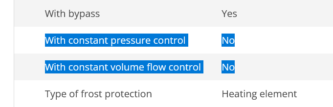

Jolo Posted 6 hours ago Posted 6 hours ago I'm currently researching options to replace my faulty Brink Flair 225, and have found some which apparently don't have constant pressure or constant volume, which seems bizarre to me. So without that basic feature, if I set the normal flow to, say 100 m3/h, it will drift over time as filters become dirty? Here's an example of one: https://www.ventilationland.co.uk/en_GB/p/vent-axia-mvhr-sentinel-kinetic-advance-250sx-including-preheater-right-250m3-h/9985/
JohnMo Posted 5 hours ago Posted 5 hours ago (edited) 39 minutes ago, Jolo said: if I set the normal flow to, say 100 m3/h, it will drift over time as filters become dirty? It will vary a little as system pressure drop increases. Edited 5 hours ago by JohnMo
Jolo Posted 3 hours ago Author Posted 3 hours ago Thank you John! So these units are just missing some logic which adjusts the fan speed depending on the pressure, is that right? BTW I was considering getting a Zehnder Q350 with enthalpy exchanger, but then saw it's almost 50kg!! The Duco 325 is only 21kg, that might be a better option... Both seem to have constant flow, at least!
