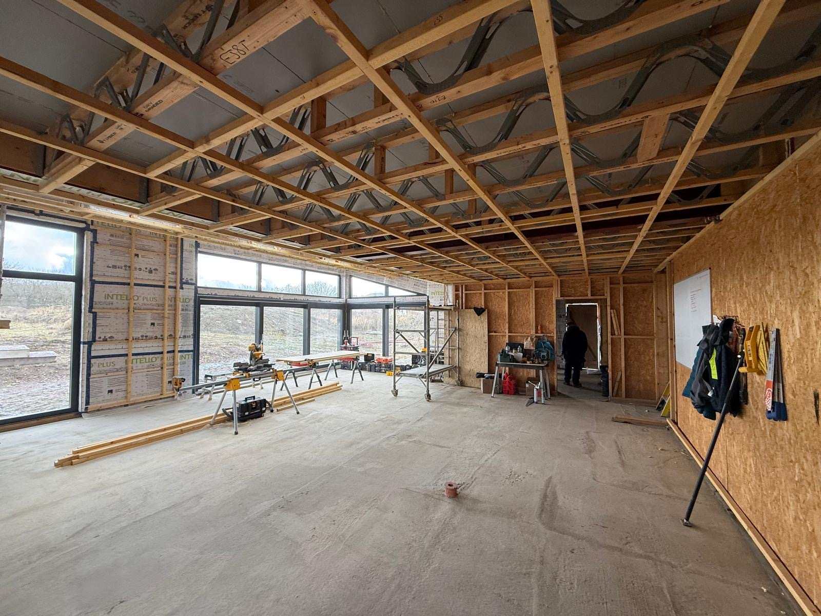

February 17Feb 17 Evening All, Was looking for collective thoughts on my ideas for my UFH. Yes, I have quotes from most of the major players, just wanted some second opinions. About the house first: 380m2 in total, 210m2 on the ground floor. Planning UFH on ground floor only with only towel rads in the 4 upstairs en-suites. House is 220mm SIPS panels throughout including roof. Triple glazed. Aiming for < 2 AH (I know not super fantastic, but trying to be realistic based on time I've had). House will have MVHR. Foundation is an insulated raft 250mm concrete + 65mm screen on top. Raft has 250mm EPS and external Insulated upstand. Heat will be via Gas Boiler (its available right outside my house and building warrant was done in 2023). Location - central Scotland I'm happy that I didn't attach the pipe to the slab during pour as there is no way the cowboys that put up my kit would not have blasted nails through it. Main system points are: looking at minimum of 14 ports, some places up to 15 to accommodate the number of loops and volume of pipework. Would be 16mm pipe on 150mm spacing Because of the number of ports, it's looking like 2 manifolds. And therefore 2x pumps. Any things I should be aware of there? does it make balancing the system horrendous? or just more time? With what will be 1200m or so of pipework, is there any benefit to fitting a buffer tank. Am I missing anything? or creating future headaches? I'm clear that warm up / cool down time will be long. Trying to just run the house at a steady temp. Edited February 17Feb 17 by Bigdeadbadger
February 17Feb 17 2 hours ago, Bigdeadbadger said: Heat will be via Gas Boiler Our new build was completed with gas boiler, soon after moving in solar gains were painful. Bought a cheap ASHP to allow cooling via UFH. A year later the gas was disconnected, and ASHP used for heat and cool. Was cheaper then gas, no gas standing charges for one, using a time of use tariff, some solar and battery, makes ASHP as cheap as chips to use. I would drop down to 200mm centres and run from a single manifold (our floor area is 192m2 and we have 7 loops on 300mm centres). Run direct from a good boiler, so no pumps or mixers. UFH design, you need it room balanced by design, as far as possible, so room loops need to output room heat loss and each room receive its heat loss via the UFH. This makes balancing easy, I have all loops fully open at the flow meters and let the ASHP decide the flow it wants or needs. So operation can be two ways, WC or simply a fixed flow temp and a thermostat to limit, a single thermostat will do or a few, but don't bother with manifold actuators, so one thermostat needs heat all loops come on. Get an under floor wiring centres with some bells and whistles, so the room thermostats are actually temperature sensors and the can doo heat and cool, for when you install the heat pump. Boiler get a system boiler, not heat only one. Run PDHW (priority domestic hot water), this drive two temperatures from the boiler, one for heating the other for DHW heating. Get a heat pump cylinder, nothing else. Reheat times super quick and best boiler efficiency. Edited February 17Feb 17 by Nickfromwales Typo fixed :)

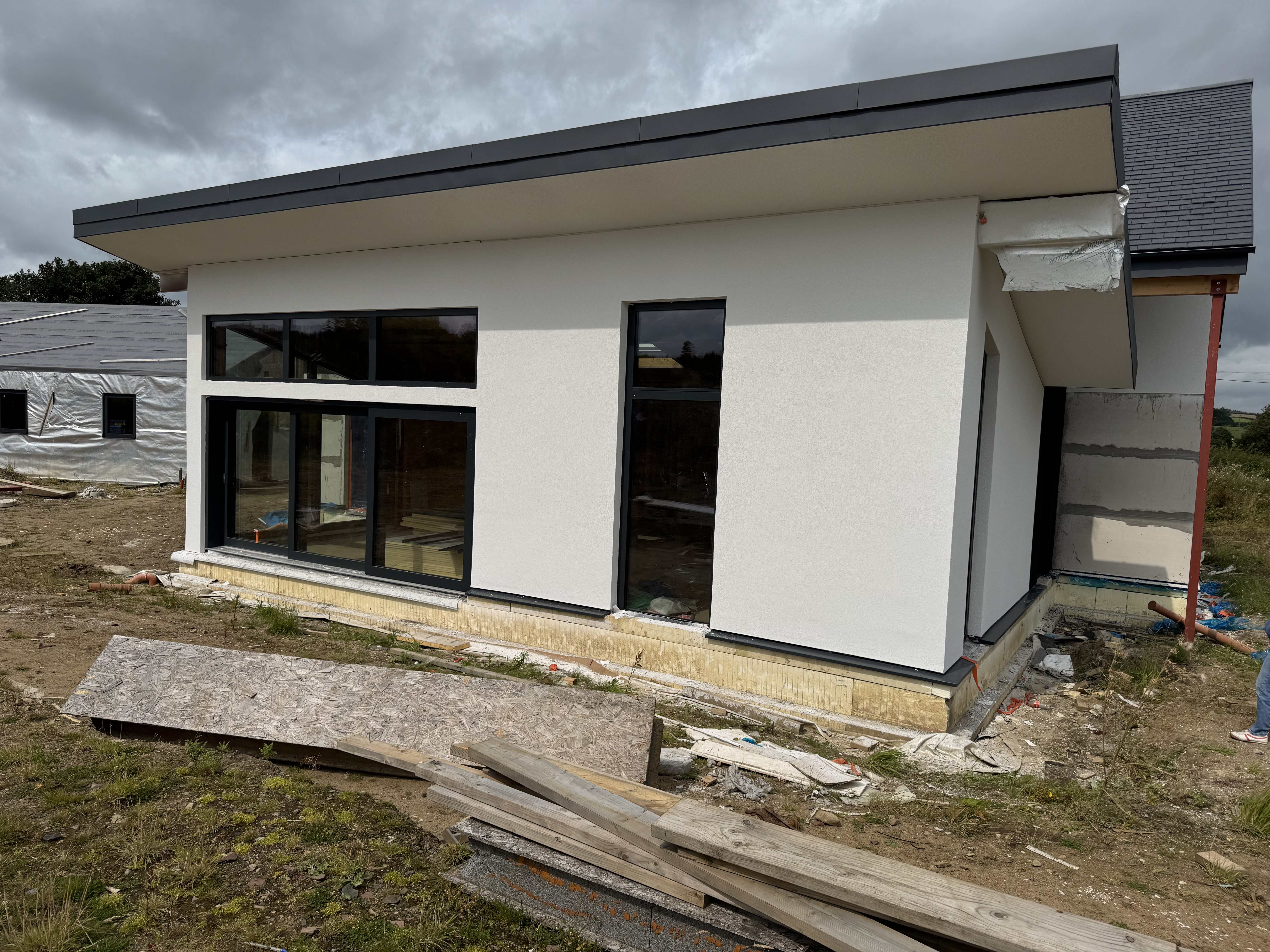

February 17Feb 17 Author Thanks @JohnMo some more questions - see you’re in NE Scotland and still had solar gain issues - that’s a bit concerning for me - was there something specific about your amount of glass? I have ~26m2 south/southwest facing glass. Although I do have an overhang
February 17Feb 17 We have a 6m overhang, but its the westerly afternoon sun in spring and autumn that gets in, can get really hot. Today sun all day solar gain from a low sun, so a benefit. So a cylinder with 3m2 coil as used by heat pumps, used with a gas boiler are great, either low flow temp or super fast reheat. Or you could do a cylinder heated by a heat pump, as in an all in one unit Edited February 17Feb 17 by Nickfromwales
