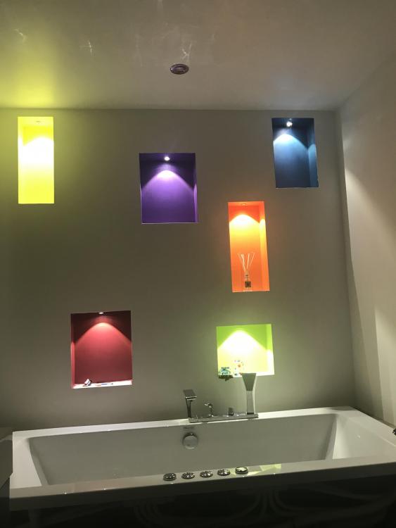

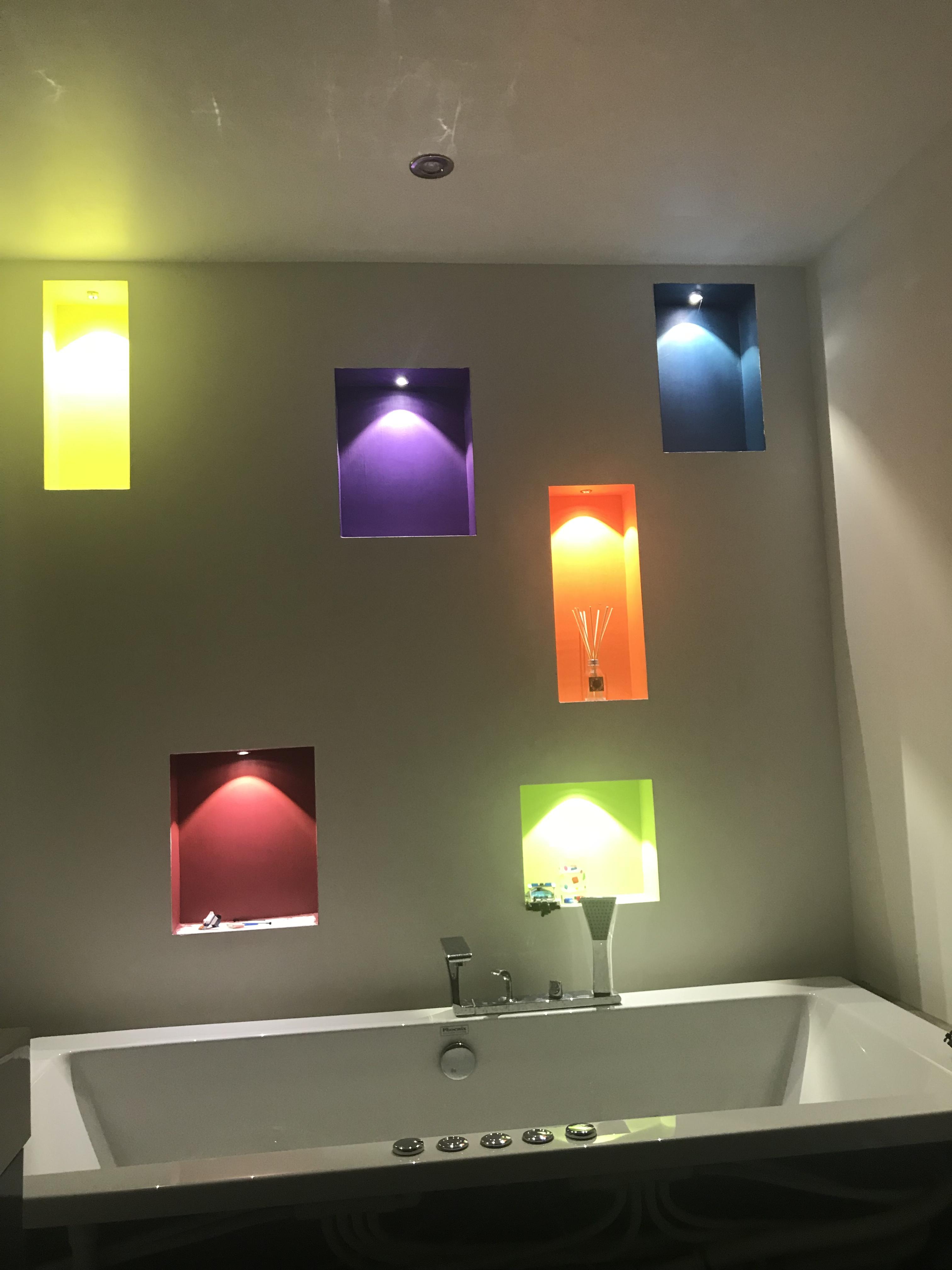

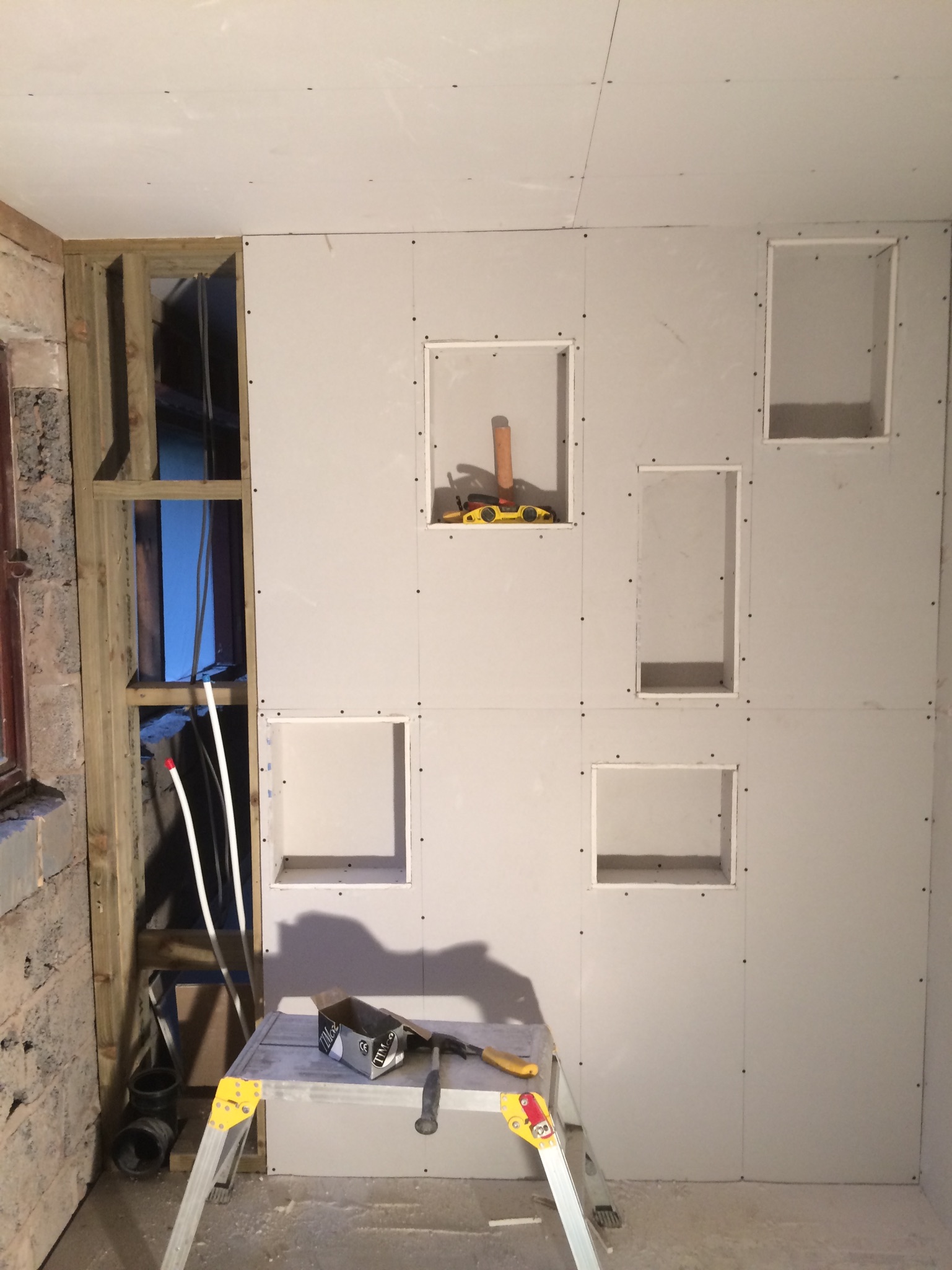

lizzie Posted January 24, 2018 Author Posted January 24, 2018 11 minutes ago, Lesgrandepotato said: Our bathroom... Wow! Very funky. What did you use?

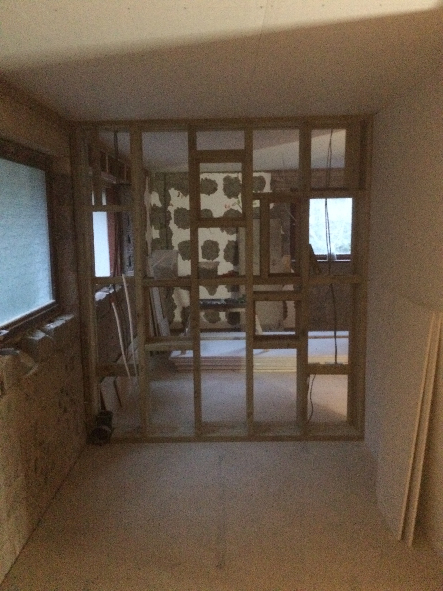

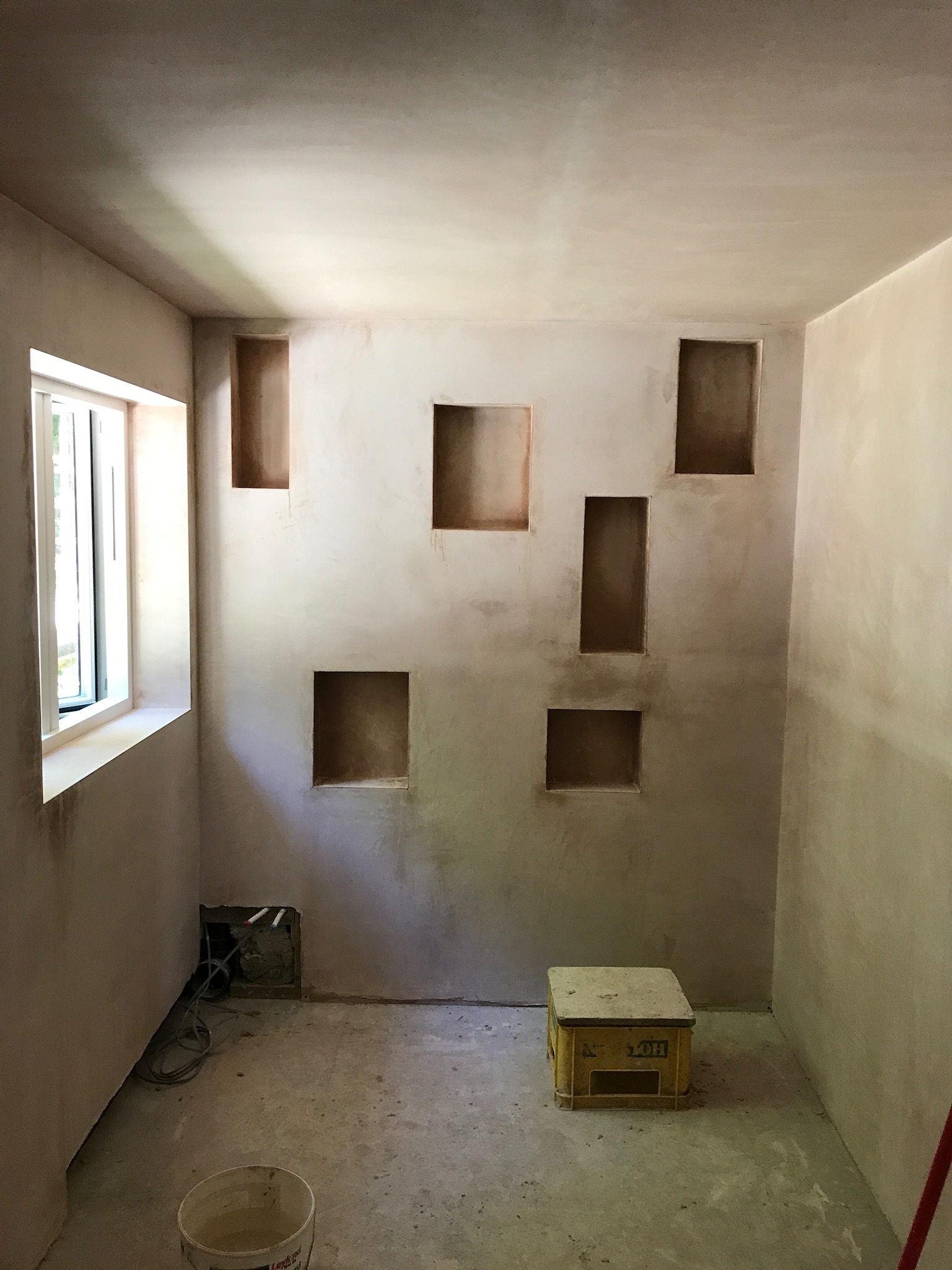

Lesgrandepotato Posted January 24, 2018 Posted January 24, 2018 They are just stud boxes plastered out with a 30mm led downlight. Then painted bright colours.

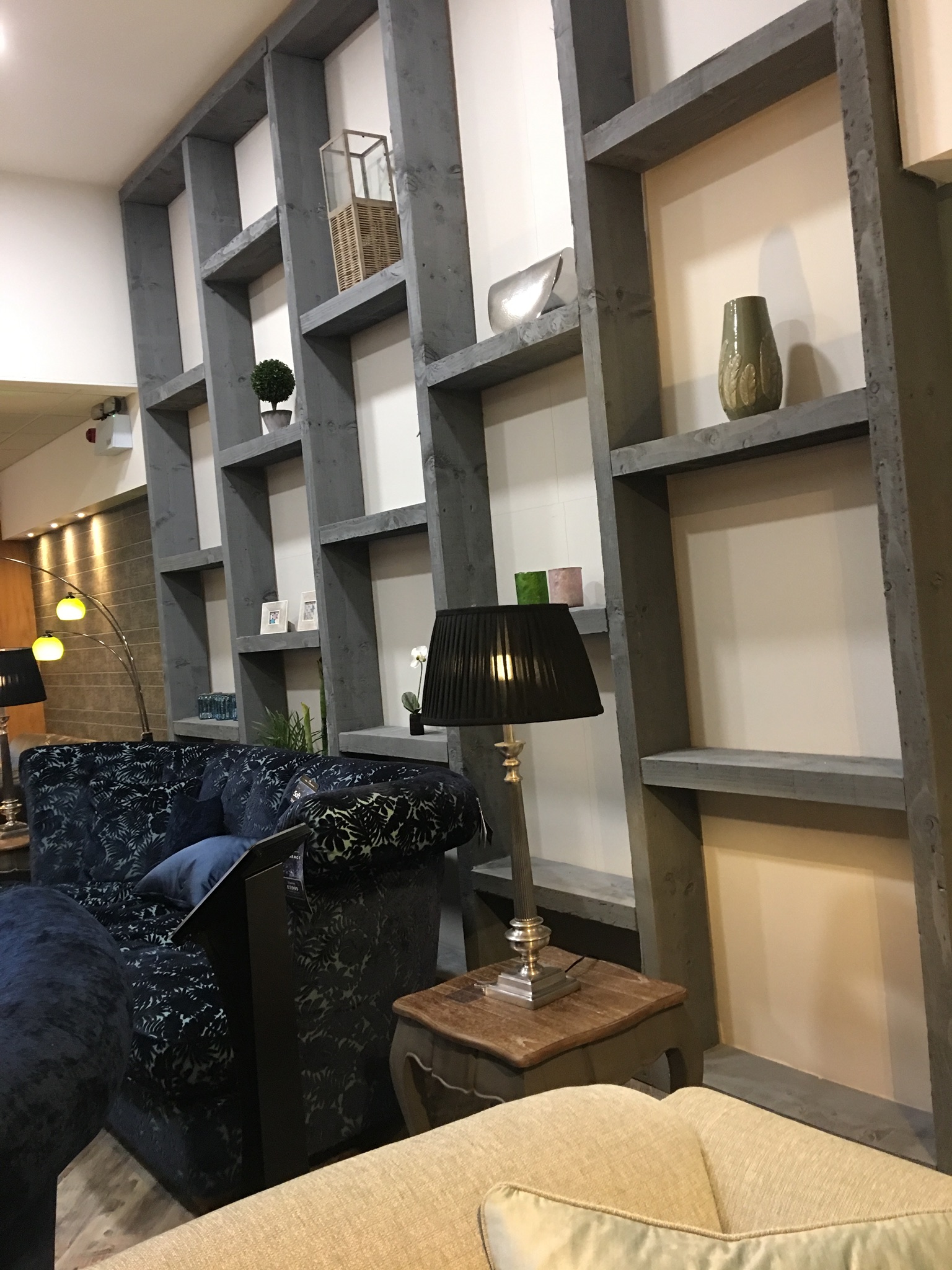

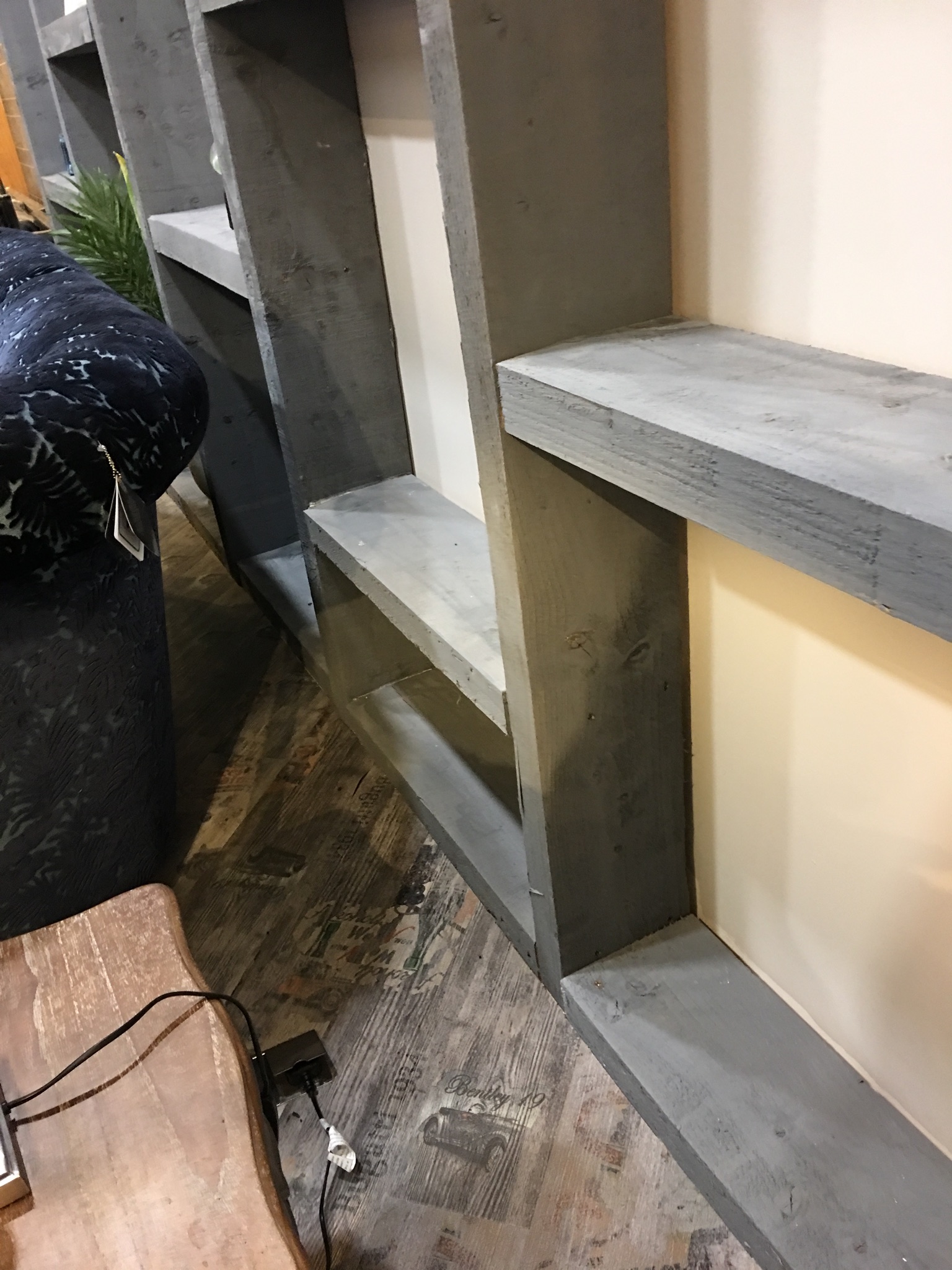

lizzie Posted January 24, 2018 Author Posted January 24, 2018 That stud wall reminded me of something I saw in a furniture shop recently...not for sale was part of the shopfittings but cheap and easy to do and I thought very stylish as a display wall/bookcase. 1
