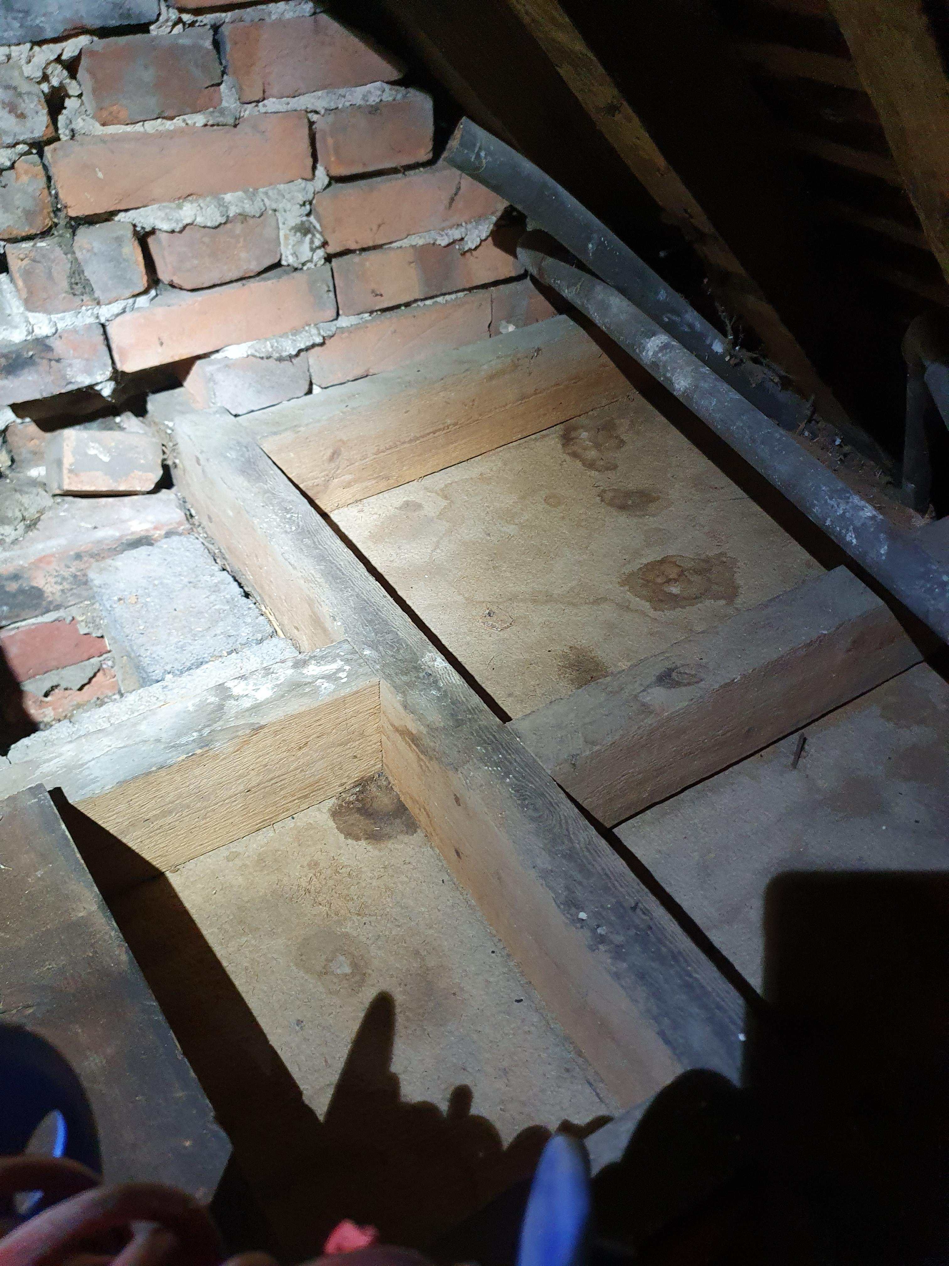

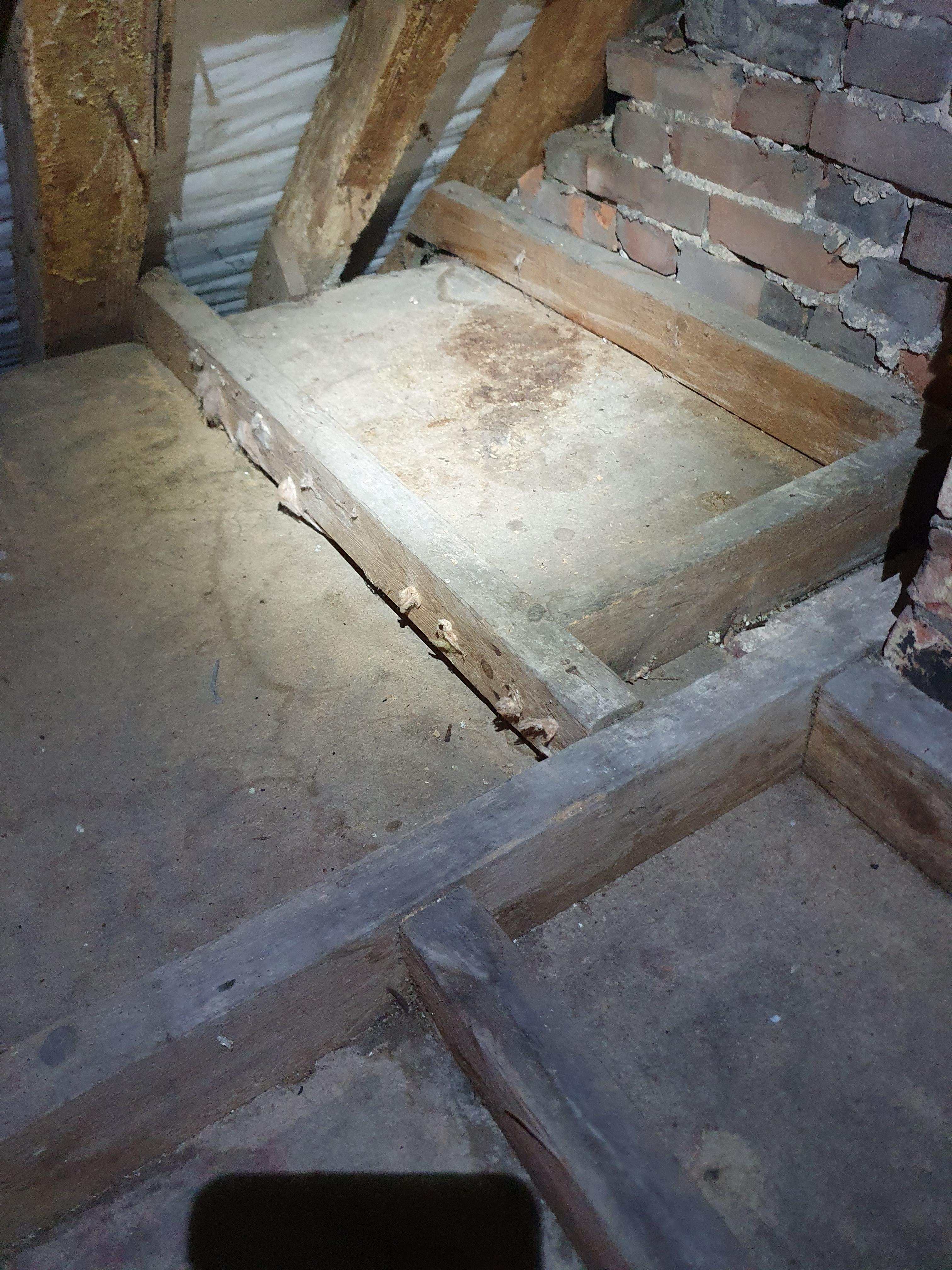

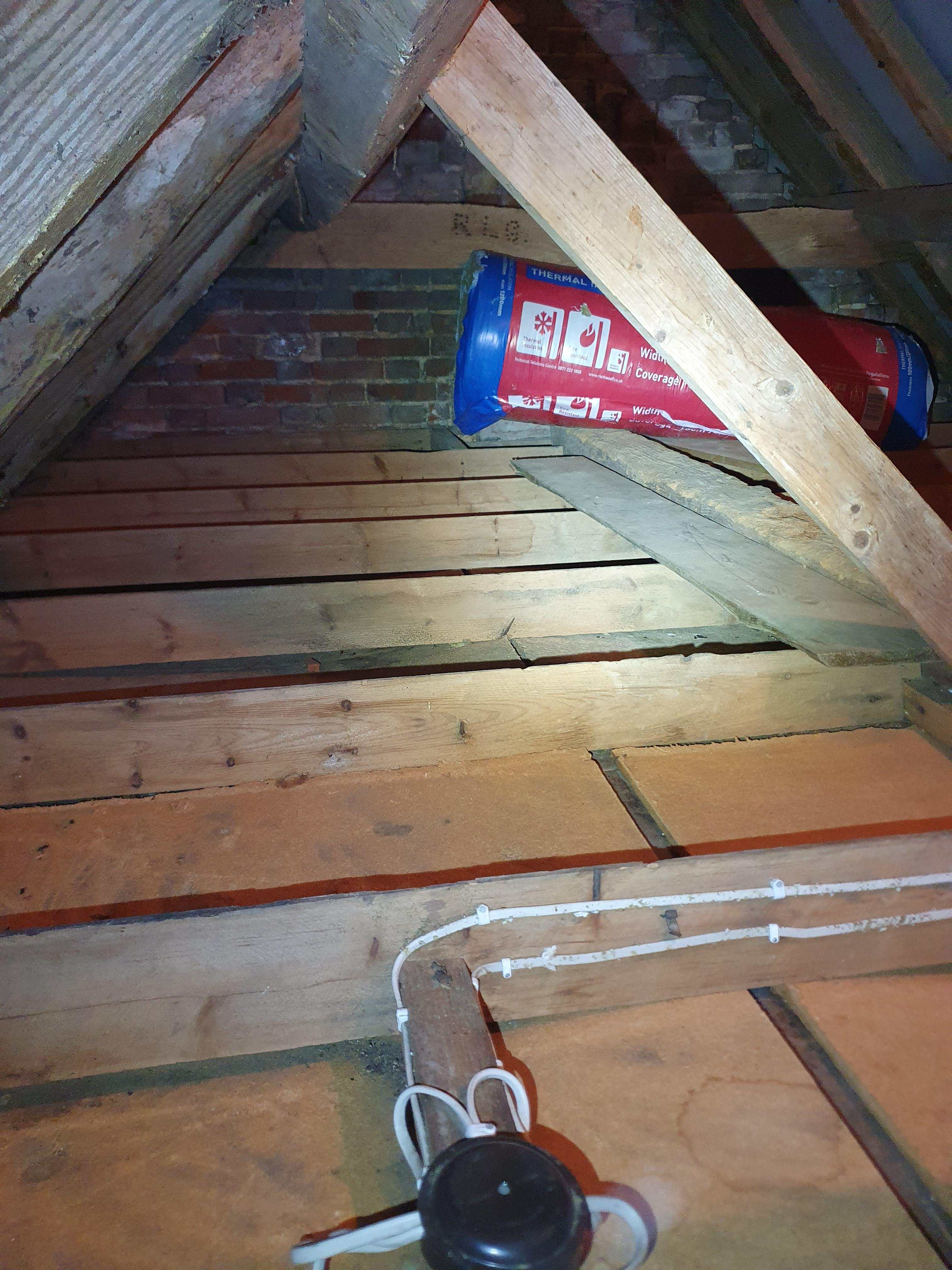

paro Posted 8 hours ago Posted 8 hours ago Hi All - I am trying to find our what the 1st floor ceiling is made of so I can look to replcace some of the boards that have broken down. Can anyone give me a steer on what this is? It's definetely some kind of wood fibre and is probaly 15ish mm thick. The entire 1st floor ceiling is made of it. I need to try and replace like for like because of the texture. I did put some plywood in as a quick fix but it looks terrible. Thanks, Paul

MikeGrahamT21 Posted 7 hours ago Posted 7 hours ago Any photos of the other side of the board? (Loft side)

Nestor Posted 7 hours ago Posted 7 hours ago Looks like hardboard due to the staining but It could be a type of Sundeala board, wood fibre pin board originally. Is it slightly soft if you apply a little pressure to it from inside the loft? Very impressed with your clear up, proper job.

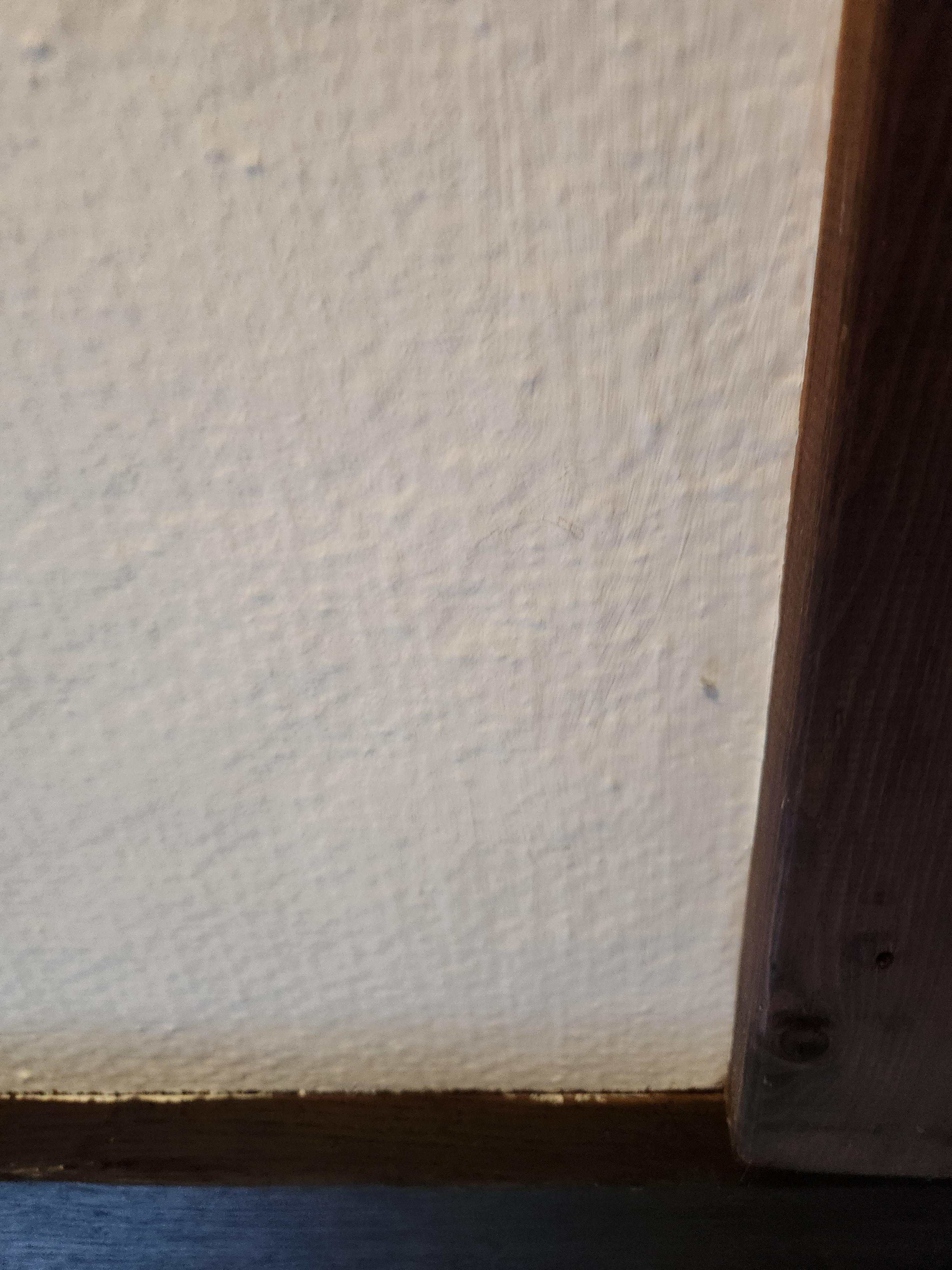

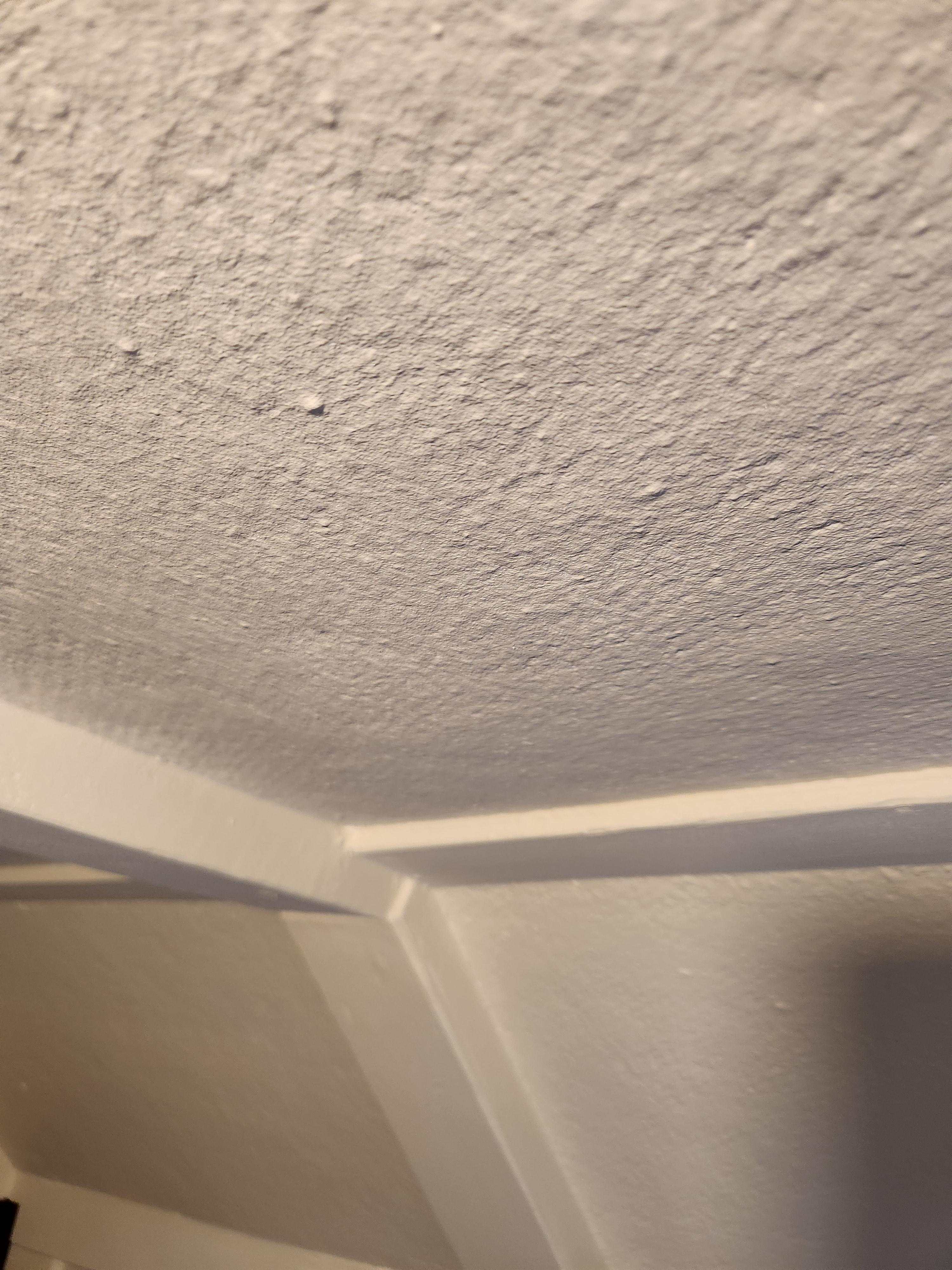

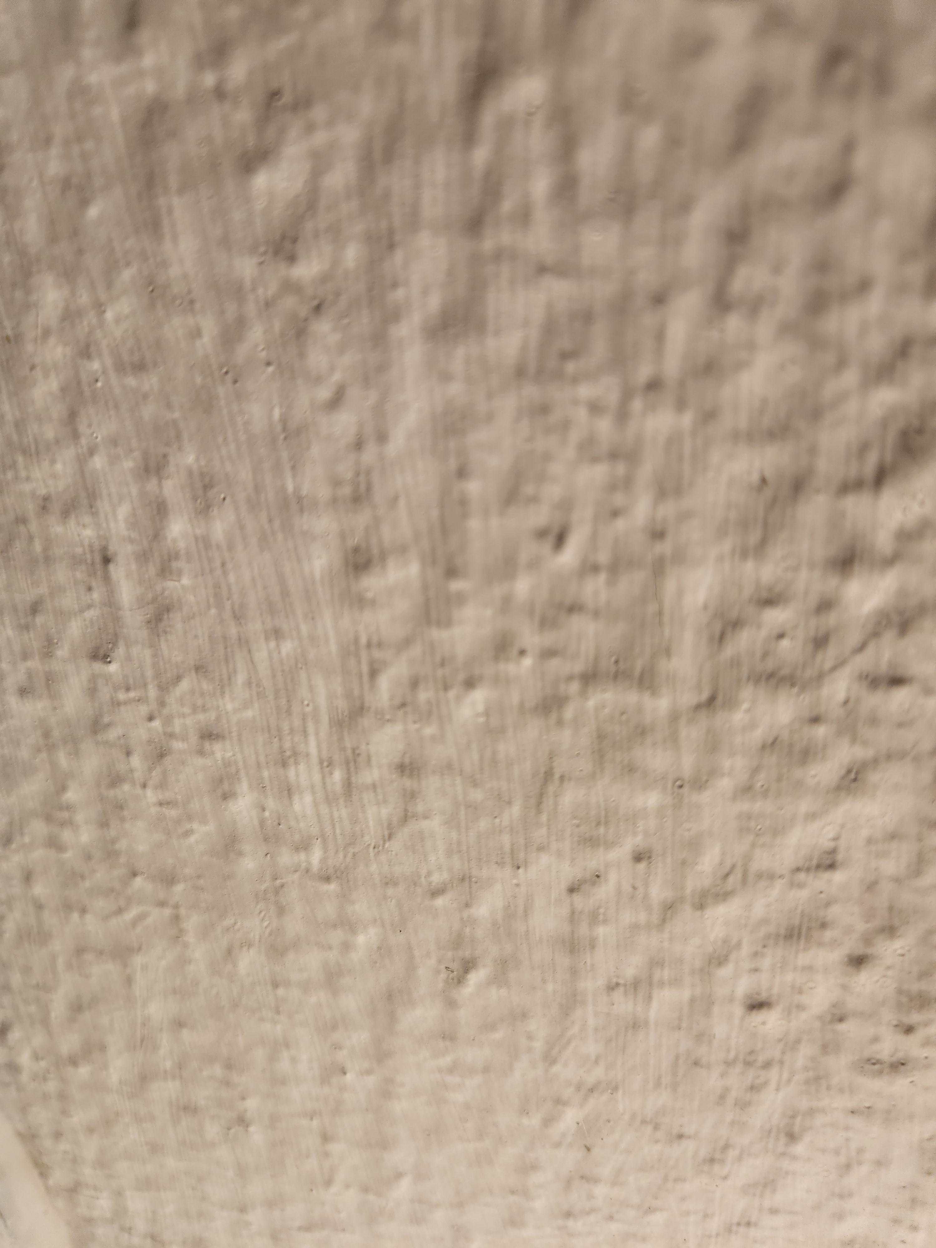

MikeGrahamT21 Posted 7 hours ago Posted 7 hours ago Looking at the bare side, to me it looks like wood fibre board, its entirely possible though the texture on the other side could be artex which could contain asbestos, get a test done and you'll know for sure
paro Posted 5 hours ago Author Posted 5 hours ago 1 hour ago, Nestor said: Very impressed with your clear up, proper job. Thanks. It really was a nightmare to start with. I am most impressed that I didn't managed to put my size 13's through any of it. I would say they are relatively soft. There is a lot of sag in them now, to the point now where some are beginning to give way. 1 hour ago, MikeGrahamT21 said: Looking at the bare side, to me it looks like wood fibre board, its entirely possible though the texture on the other side could be artex which could contain asbestos, get a test done and you'll know for sure Artex actually makes sense as the pattern is not consistent throughout. If that's the case I can potentially just replace with equivalent thickness of ply and try to replicate the pattern.
