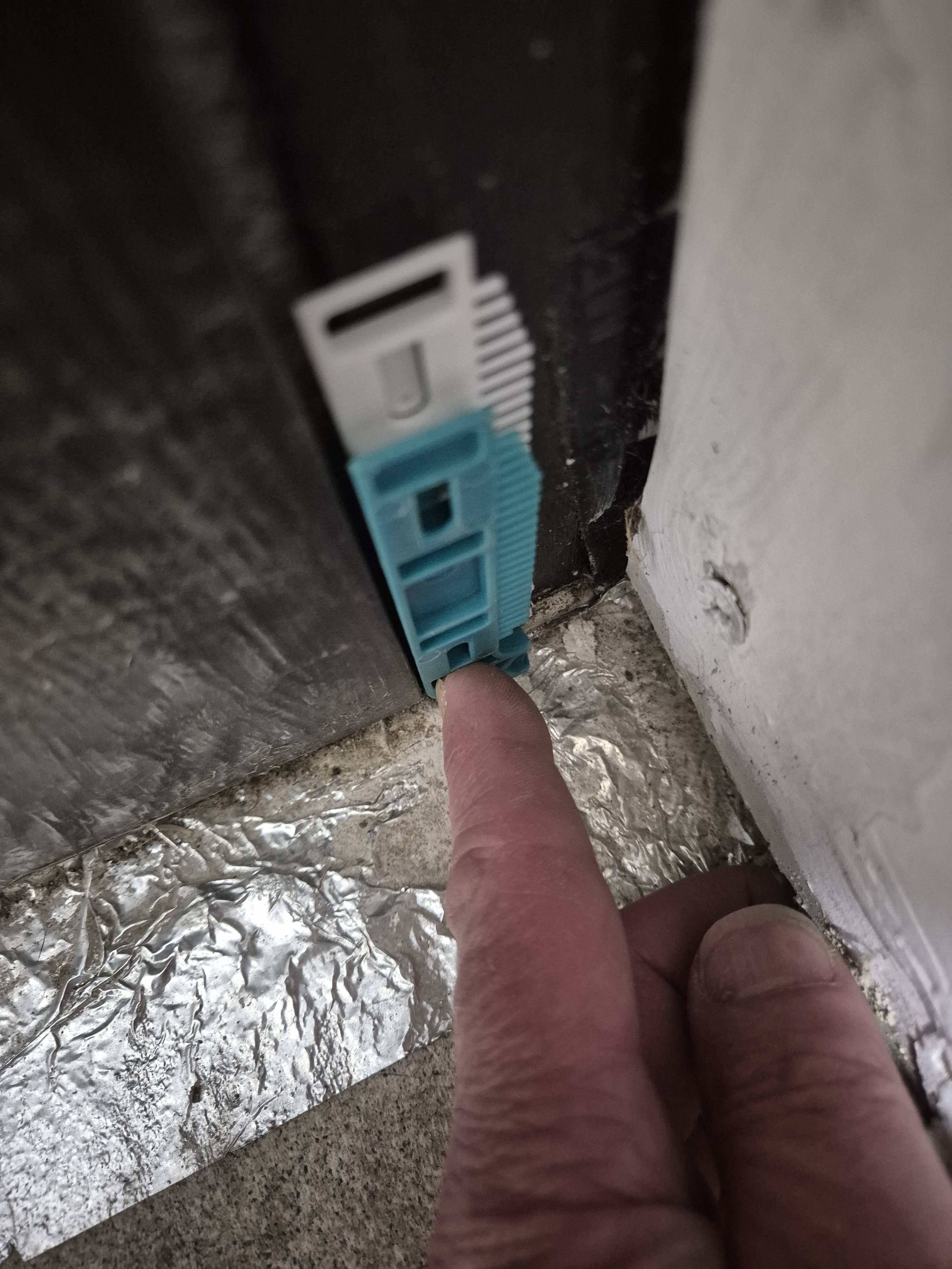

GrantMcscott Posted 7 hours ago Posted 7 hours ago Hi i have a composite front door that has been working fine but now the bottom is not flush with frame and need to kick the bottom to lock it. Even with keeps full adjusted it doese not make a difference. It is out by 8mm and flush to the frame at the top.
stu w Posted 6 hours ago Posted 6 hours ago Fairly common with composites, the slabs bow. I have several replaced by Endurance under warranty due to faulty slabs
GrantMcscott Posted 6 hours ago Author Posted 6 hours ago 44 minutes ago, stu w said: Fairly common with composites, the slabs bow. I have several replaced by Endurance under warranty due to faulty slabs Hi there is a bow in the slab but when you put a long level onit it is only 4mm in the middle
stu w Posted 5 hours ago Posted 5 hours ago 45 minutes ago, GrantMcscott said: Hi there is a bow in the slab but when you put a long level onit it is only 4mm in the middle Has the frame moved slightly compounding the issue, it might be out of plumb
Nickfromwales Posted 4 hours ago Posted 4 hours ago PVC hero’s fit these heavier units and don’t often pack and fix them properly, so they start to play up after a few months of open / close cycles. You need to do diagonals to see where it’s ‘out’ and pack it back properly. Can you ask the original fitter to do it for you, and explain it’s moved and needs them to sort it?
