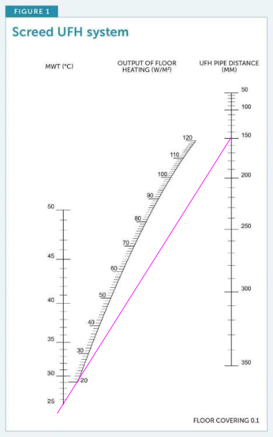

But still, for me I am trying to work out how to calculate what heat output to expect from the UFH for each room and I haven't (or I have missed in this thread) those basics. The most basic bit I am missing is how to take the known length of the UFH loop, flow temp and flow rate and calculate the heat output.
So for instance @SimonD's formula: Q (W/m2) = 8.92(Average Floor Surface Temperature - Room Temperature)1.1  skips over the vital bit of what n m of  pipework at n centres laid on n mm insulation in n mm of screed can transfer at n flow temp and n flow rate. This assumes that 16mm OD plastic pipe is pretty much the same. I was hoping that would be a spreadsheet that would give me a good starting point. Is that a bonkers question? I'm not very good at explaining my own ignorance because my brain was put in upside down as a baby.

No it doesn't skip over those bits of information, it provides you with the foundations for your design. Without it, you can't do any of the rest. The length of your pipework is actually irrelevant right now, that is just selected on the basis of pressure drop, not heat output. The heat output is given by the formula I provided. But in your design, you also need to know things like down losses, which is more involved than just knowing the thickness of your floor insulation because it depends on the proportion of external edges to floor area and the shape of the room. But it's not just down losses to the outside, it's also downloss in intermediate flooring because otherwise you can provide excess heat to the room downstair. And it's not just your floor downloss but the heat load of the room, which means you need your heat loss calculations. These will give you a required W/m2. Then you take the formula I gave you and you can calculated the average floor temperature and work back from there to determine mean water temperature and pipe spacing.
What I gave you was a suggestion of book that provides you with a very easy way to determine what you need with simple nomographs - all you need to know is your pipe spacing, which you have on GF and the heat load in W/m2 and then you can find your mean water temperature for that system - it includes a standard screed and a spreaderplate. Or you can do it the other way round by selecting your mean water temperature and knowing your W/m2 requirement, you can find the pipe spacing. All you need to do is spent 25-30 pounds on the book and use a ruler. However, this just gives you a basic guide.
You need to know your floor coverings why?
Take a screed floor fairly standard covered with ceramic tiles a mean water temperature of 30C and target room temperature of 20C. With 150mm spacings the output of that floor will be about 55.5W/m2 and average floor surface temperature will be about 25.3C. If you instead had hardwood flooring you're looking at an output of 33 W/m2 and an average floor surface temp of 23.3C. As mentioned above, in some instances a resistant floor cover may give rise to greate down losses in intermediate floors.
I work in the business and even though I have the industry guides to do the design so I can pull out the figures above, I still wouldn't sit down a do it myself because the UFH suppliers do the design for me and they have the software packages to do it.
This is why you're not getting or finding a spreadsheet.
Ok. So if I take the emitter schedule for the living room from the ASHP supplier: (This is specified as carpet covering)
Design temp 21 c
Heat loss 370w
W/m2 17.78 <---- I guess this is the output required for the given heat loss and room design temp.
With a tiled floor and MWT of 30C that would suggest, in a 21.75 sqm room the floor would output 1.2kw? I would surely boil. Obviously it would be different for a carpet floor. I would be trying to establish what flow temperature to set on the heat pump to get closer to a comfortable living space. Am I approaching this wrong?
Mean flow temp give an output approximately, if well insulated it's close enough to get you started. But surface temp and mean flue temperature are very different animals. You can have a mean flow temperature of 30 degs and wide pipe spacing and deep screed and floor temp may only be 25 or less.
Another attachment is a simple to read graph for screed floor, if you have carpet the tog value will downgrade the W/m² output, tiles little or no effect.
No why would you flow at that temp for an output of 370W, your mean water flow is going to be sub 25 degs.
Just read off the attached graph for you pipe spacings and output - use a streamline between pipe spacing and go through W/m² to get mean flow temp. Carpets without major care can kill the floor output, especially at low output. If you want carpets get radiators. Or be prepared for poor outputs.

I am going with what @SimonD's post said the output would be for a flow temp of 30C, and making the point that if I have understood things correctly, that would be way too much for my living room.
Quote
Do you mean like this?
With 17.8w/m2 specified by the ASHP supplier that would suggest a very low flow temp as a starting point. (This is a good thing I think)
Yep

I gave that figure, which was chosen randomly, to provide an example of the difference in output of floor coverings for the same given MWT. This was to illustrate why you need to know what floor coverings you need. It was not in any way a suggestion of what you need.
Yes, this is a good thing, but look at your chart. If indeed your output needs to be 17.8W/m2, the chart you use shows output with a screed floor with a covering of R0.1, this is the equivalent of 1 TOG carpet tiles or hardwoord flooring - so if you have tiles it will give more heat. You may have a problem here, because you can't run the heating system with a return temperature less than the room, so you're probably looking to reduce the heat output of these floors. Remember, your heat loss is calculated at an outdoor temperature of -3 to -4.6 in Somerset.
One of the reasons I went for 300mm centres so I could run without mixers. My floor needs approx 32 degs at -9. Go for closer centres, you get to the point where @Nickfromwales comes from. You need a buffer and mixer. So you charge the buffer at minimum acceptable flow temp and then let down the temp to cluster to 20.
The other way in milder weather, run heat pump at the lowest temperature that gives you acceptable heat pump behaviour - so about 25 degs and shut the heat pump off once house gets to a defined temperature. You use the thermostat as a energy manager not a comfort thermostat. So set point is just above your normal WC room temperature.
Looking at it, this is the lowest w/m2 demanding room. But it does make me wonder if my FF pipe centres should be 200mm rather than 150mm. That is partly why I started this thread in the first place.
