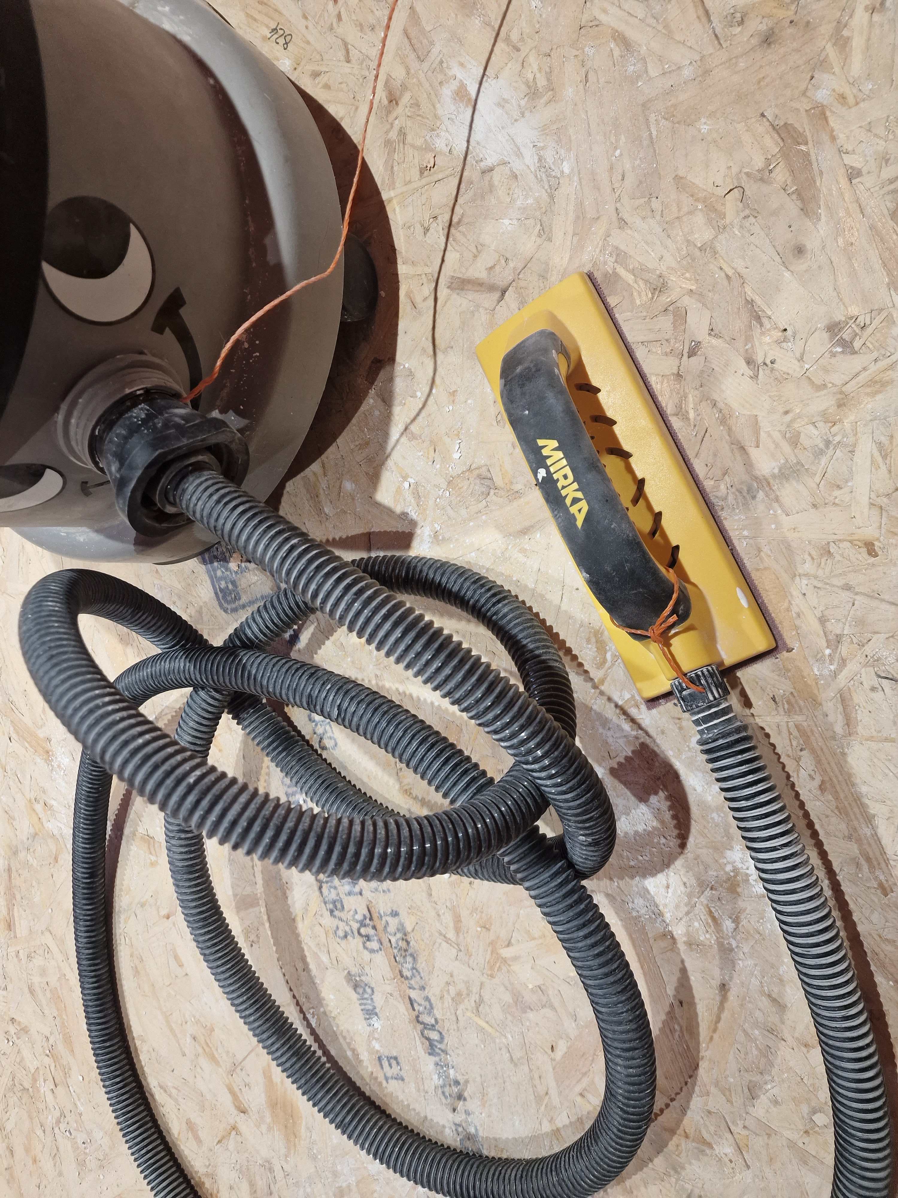

January 21Jan 21 Hi all. I'm doing a bit of drywall work and I'm using the Mirka Handy sander with dust extraction to fair it. I keep getting hefty electric shocks from the extractor hose that are really unpleasant. I presume its electrostatic building up in the hose but do you have any bright ideas how to avoid this? This is the tool and its plugged into a Henry https://www.mirka.com/en-gb/p/Hand-Sanding-Kit-HANDY-80x230mm/
January 21Jan 21 You can buy anti-static nozzles and pipes. But try an earthed metal adapter between the sander and the extractor. May work. Don't be tempted to earth your leg or aim, especially though your house wiring (was shown this on someone's Faceboom page).
January 21Jan 21 Author So I may have a solution but it's not exactly neat. Went out to the shed to find some 1mm twin and earth to raid the earth wire and then spotted this. It's flexible electric fence wire. I was still getting light zaps until I threaded the tail into the pipe. Not had a shock had for the last half hour. Suspect the wire could just be only inside the hose and come out by the Henry and still work. Tied it off to a rad.
January 23Jan 23 Author OK so I've done a fair bit more sanding with no more shocks. Got it neater with the wire running inside the extraction hose. Markharrow if you want a length of the fencing wire I can send you some as we have lots of this laying about as we upgraded to heavier duty electric fencing on the farm.
