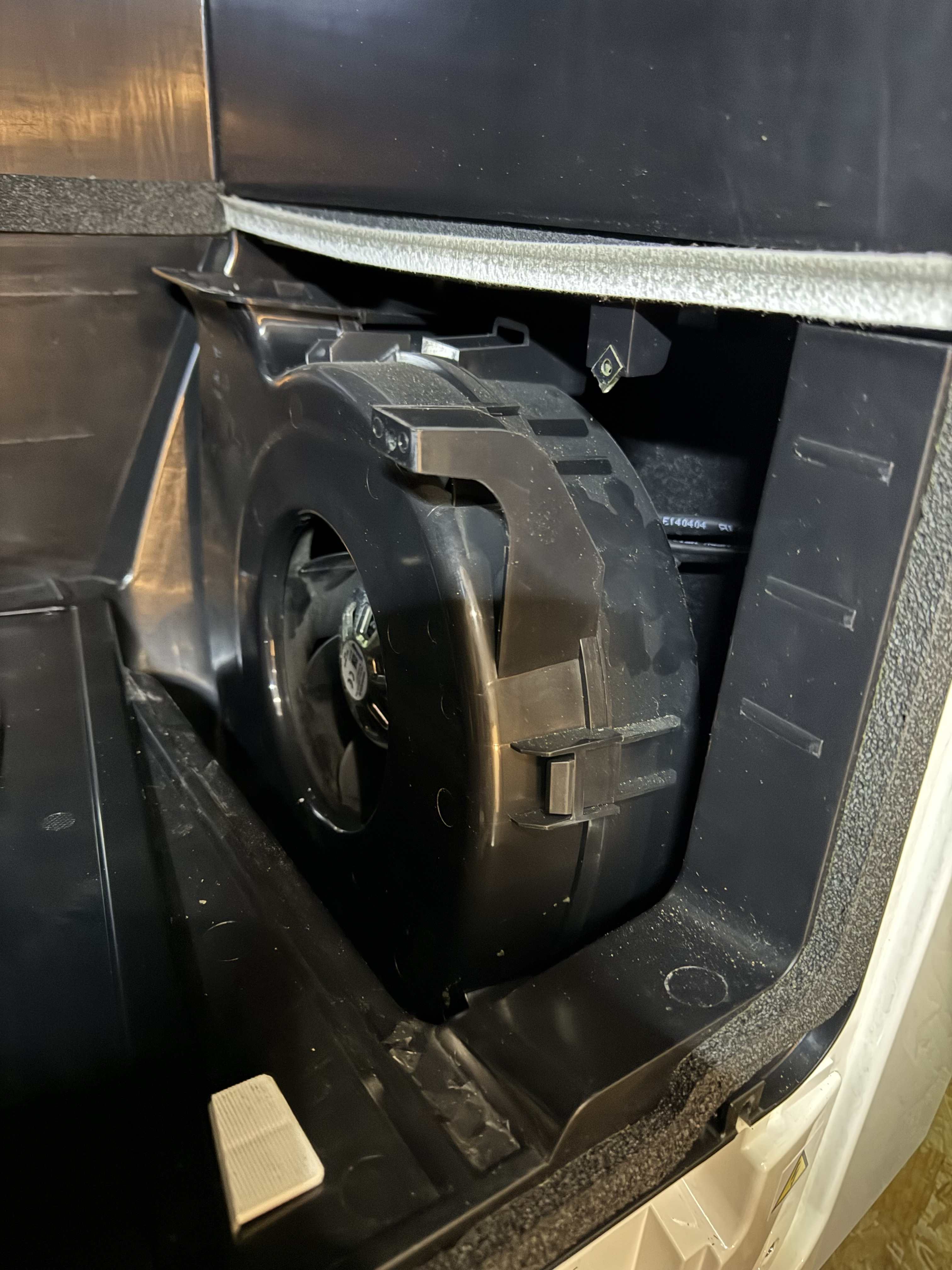

Can't tolerate the fan bearings grinding anymore.
Called Vent Axia and luckily they have new fan motors in stock!!
So ordered!
Anyone swapped one before? Easy or PITA?
This is for bearings but probably a step earlier.

Yeah I saw that . It’s unclear how you access the fans . I’ll wait until the replacement turns up - take the heat exchanger out ; have a look and decide how brace I feel
New fan turned up .
Easy enough to unscrew it but it won’t clear the panel and cabling goes into front “ somehow “ . I’m sure I’ve read that the entire section slides forwards somehow ….
Anyway ; put it back together for now and emailed vent axia with “ what do I do now ? “

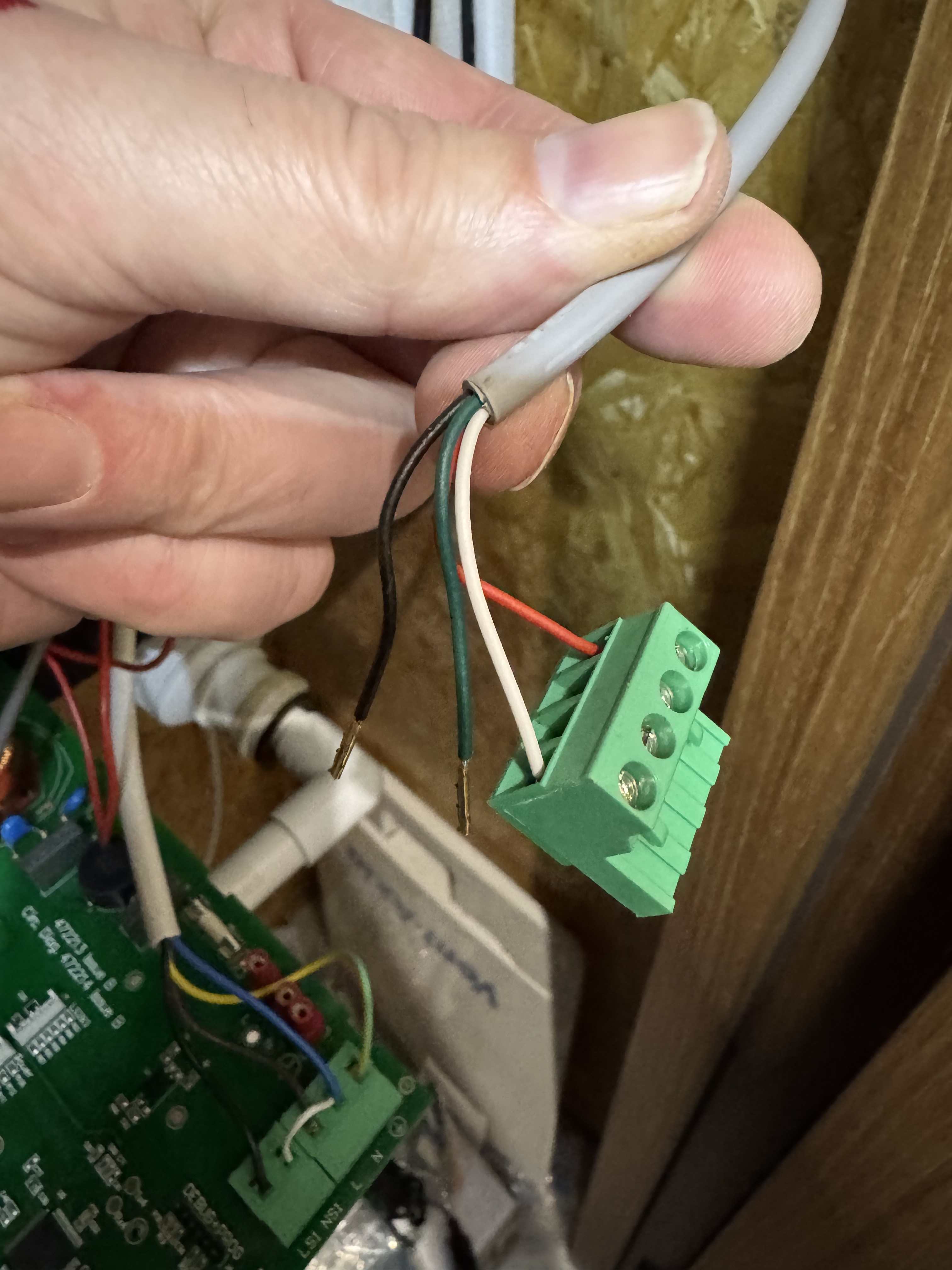

Hmmmm - let’s make this as much as we can thought vent axia
(expletive deleted)ing wonderful !
old fan has different coloured wires to new !!
Black and blue are usually the same so (expletive deleted) it
Done !
Not the most fun ; a few spare screws …. Clearly not a user serviceable device !

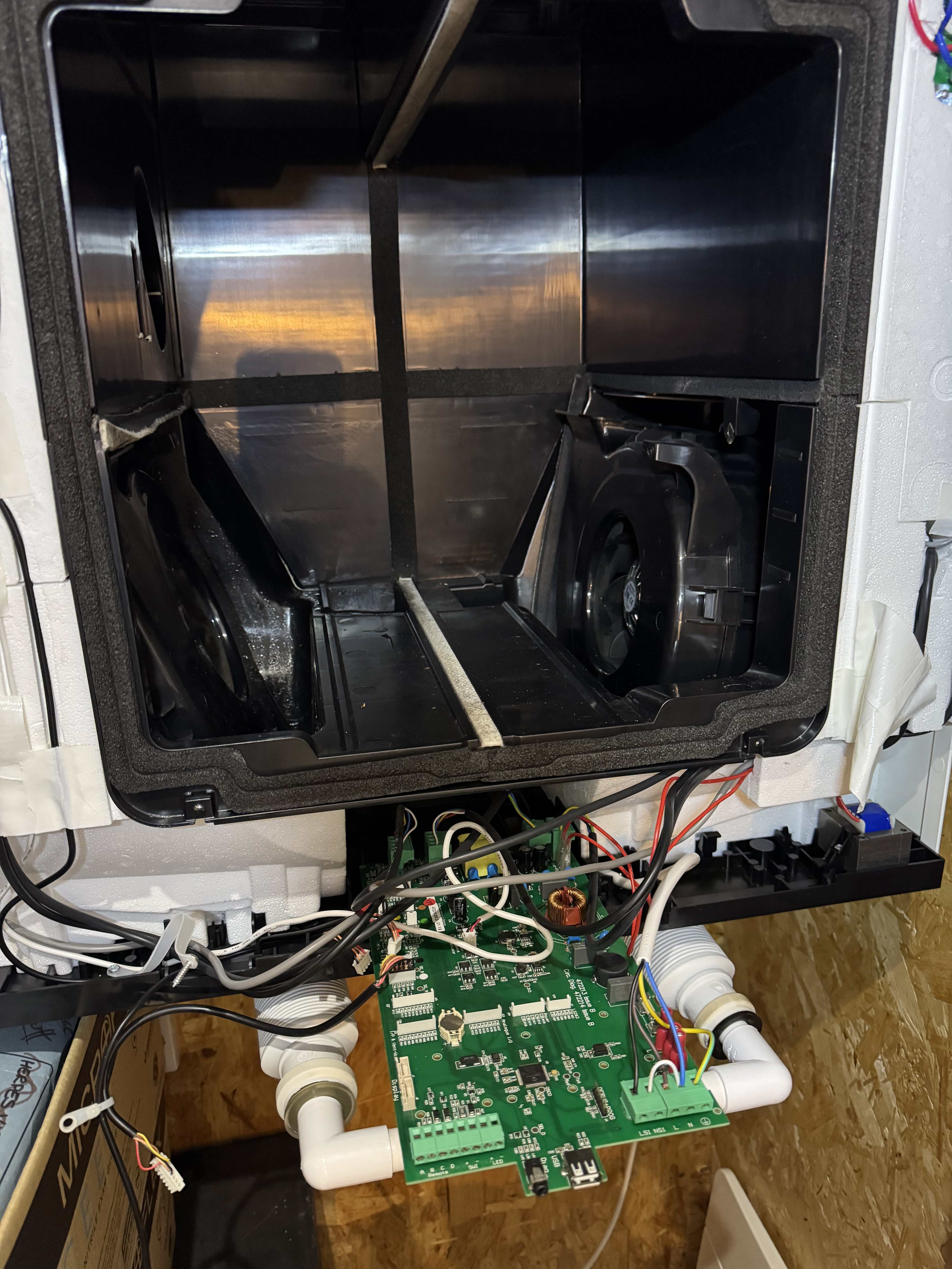

I'll try! from memory!. Yes its the same for both fans.
Get cover off
remove reactor core thing
unscrew panel around screen. there's a few screws
Assuming thats off.
each fan has 3 screws I think mounting it to the chassis remove them
you then have to unclip the slide out pcb - it was fiddly (probably need to unplug all connection (I labelled mine so I didnt mess up)
As it slides forward the fan connectors are typically at the back. Unplug them
Then the stupid bit is once you've taken the connector off the end you have to feed it back so that the fan can come out. i.e. the cables are so tight fan as zero play until it gets some cable slack
Thats from memory!. if you get stuck please put photo's up to refresh my brain.

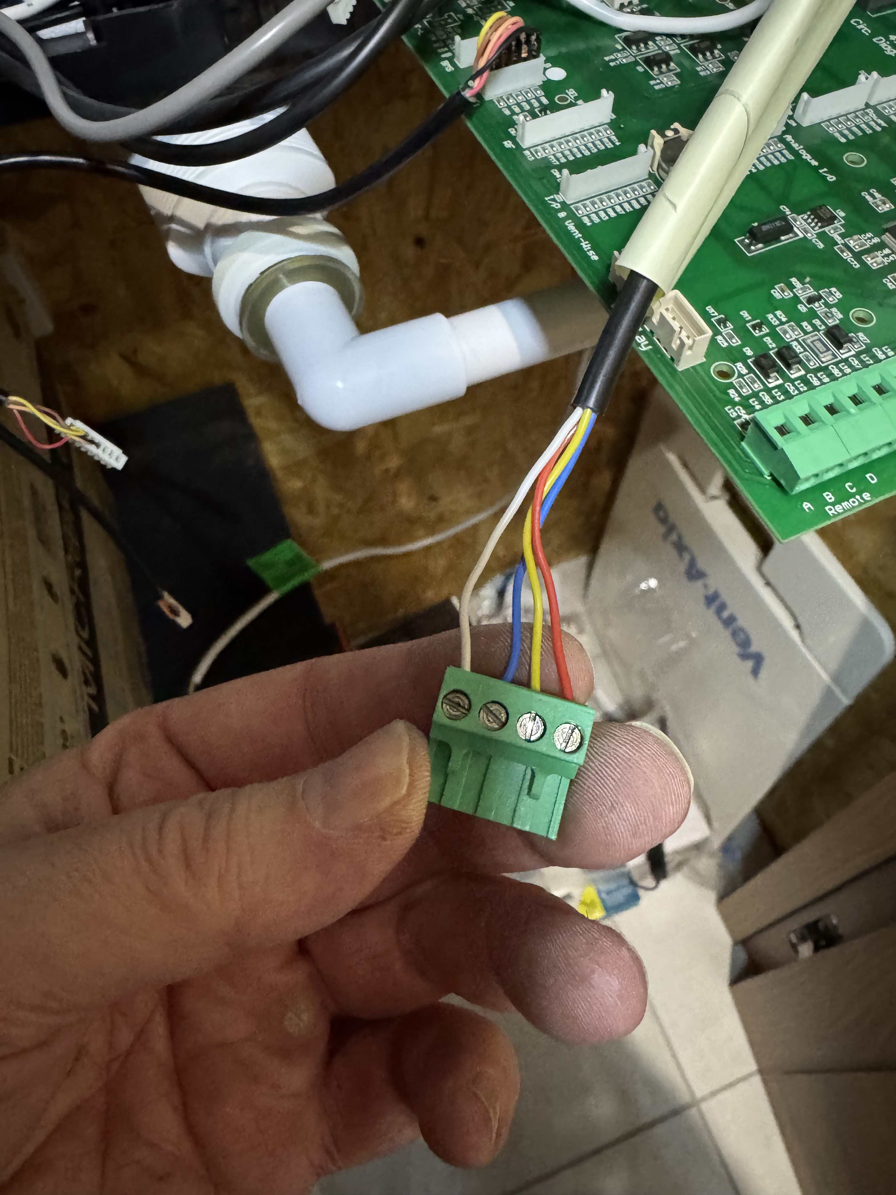

Oi ! Now you’ve given mine a problem! Fan running flat out !!!!
Vent axia sending me a new pcb foc 😊 very kind of them
