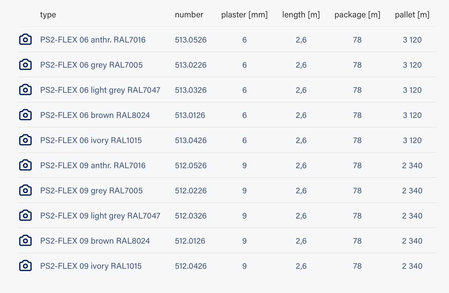

WiltshireLink Posted January 10 Posted January 10 Hi All, I am going to render my window reveals but have a few questions I cant answer by looking around... I see window reveal beads but I dont really fancy the trim that seems to be left stuck onto the window, it looks unsightly and will be a different color to my windows...is there any alternatives here? Or..could I attach a cement board to the reveal then render that? Negating the need for the beads? Thanks as ever!
WiltshireLink Posted January 10 Author Posted January 10 Or, does the trim that sticks out pull away? To reveal a neat line? Thanks
Nick Laslett Posted January 11 Posted January 11 (edited) These two threads might be of interest. These beads do come in a few different colours. https://likov.com/ps2-flex-colour-2d-window-reveal-bead-with-protective-lip-g177 Edited January 11 by Nick Laslett 1
Russell griffiths Posted January 11 Posted January 11 Ask your rendering team to take you and show you how they normally finish this area, have a look and see if it fits in with what you’re after. I used the coloured trims and I think it’s very neat, but it takes a good man to run the render up to them neatly. the trims do have a tear off strip that protects the windows while they are being rendered. 1
WiltshireLink Posted January 11 Author Posted January 11 I think that is what I was not getting, I can now see they have a tear off slip that leaves a nice line and finish. I didnt understand that tear off slip was temporary! Cheers
