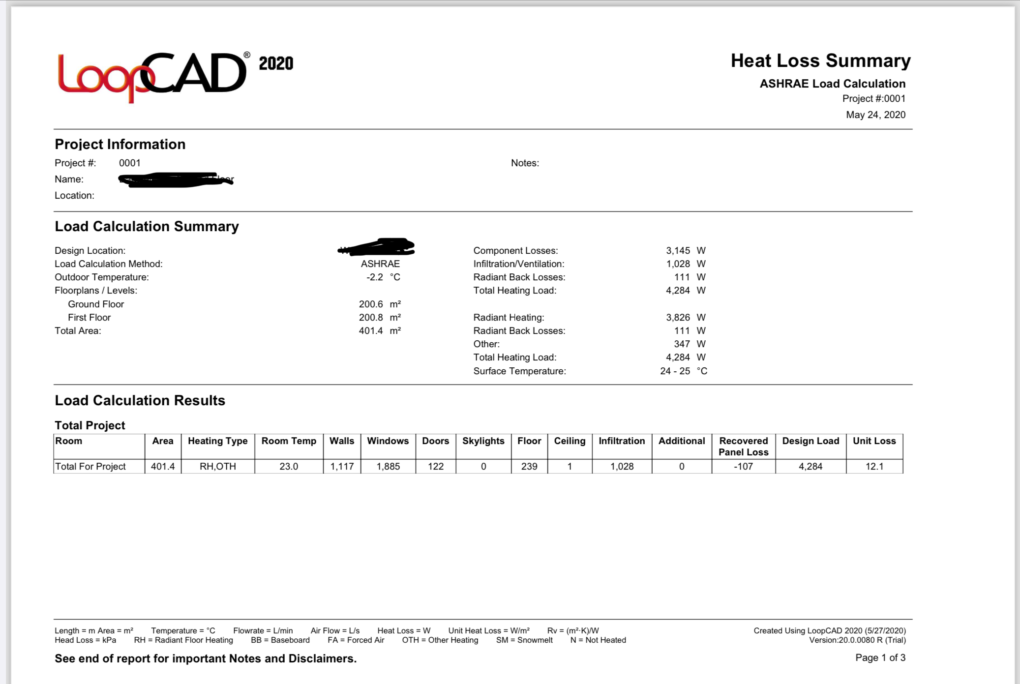

@Great_scot_selfbuild, something not quite right with the LoopCAD inputs. Ask for the Heat Loss Summary Report, that will include target room temp. I have attached mine as an example. Do you know the design outside temp?
My flow temp today with a 1°C outside temp, is 28°C. Room temp is 18.4°C.
In my original LoopCAD design, I had target room temp of 23°C, which had a flow temp of 30°C, with a floor temp of 25°C.
Looking at the attached report, the floor temp is consistent with mine, but the flow temp is 46°C. What is stopping the heat getting out of the floor? Maybe they forgot to add the insulation under the floor in LoopCAD.
The Heat Loss Summary report will show the heat loss through walls, windows and floor.
Thanks - this is what I was missing! (Because I can’t use loopCAD I wasn’t aware of the inputs it required, and they never asked for any thermal performance inputs, so god knows what they’ve based their LoopCAD design on.
